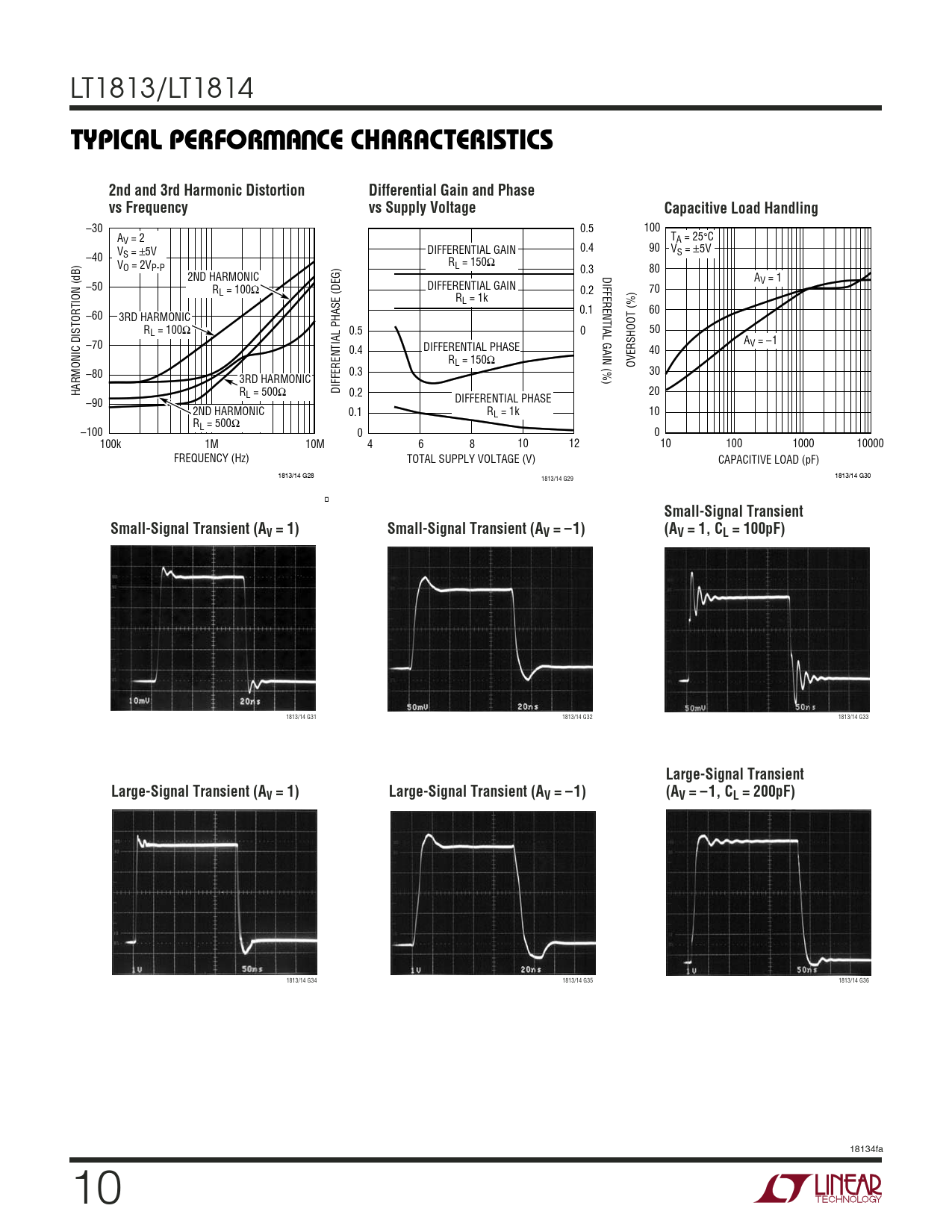

TYPICAL PERFOR A CE CHARACTERISTICS. 2nd and 3rd Harmonic Distortion. Differential Gain and Phase. vs Frequency
TYPICAL PERFOR A CE CHARACTERISTICS 2nd and 3rd Harmonic Distortion Differential Gain and Phase vs Frequency
LT1813/LT1814
W U TYPICAL PERFOR A CE CHARACTERISTICS 2nd and 3rd Harmonic Distortion Differential Gain and Phase vs Frequency vs Supply Voltage Capacitive Load Handling
–30 0.5 100 A T V = 2 A = 25°C V DIFFERENTIAL GAIN 0.4 90 VS = ±5V –40 S = ±5V V R O = 2VP-P L = 150Ω 0.3 80 2ND HARMONIC DIFFERENTIAL GAIN (%) AV = 1 –50 R DIFFERENTIAL GAIN L = 100Ω 0.2 70 RL = 1k 0.1 60 –60 3RD HARMONIC RL = 100Ω 0.5 0 50 –70 AV = –1 0.4 DIFFERENTIAL PHASE 40 RL = 150Ω OVERSHOOT (%) –80 0.3 30 3RD HARMONIC HARMONIC DISTORTION (dB) R DIFFERENTIAL PHASE (DEG) L = 500Ω 0.2 20 –90 DIFFERENTIAL PHASE 2ND HARMONIC 0.1 RL = 1k 10 RL = 500Ω –100 0 0 100k 1M 10M 4 6 8 10 12 10 100 1000 10000 FREQUENCY (Hz) TOTAL SUPPLY VOLTAGE (V) CAPACITIVE LOAD (pF) 1813/14 G28 1813/14 G29 1813/14 G30
Small-Signal Transient Small-Signal Transient (AV = 1) Small-Signal Transient (AV = –1) (AV = 1, CL = 100pF)
1813/14 G31 1813/14 G32 1813/14 G33
Large-Signal Transient Large-Signal Transient (AV = 1) Large-Signal Transient (AV = –1) (AV = –1, CL = 200pF)
