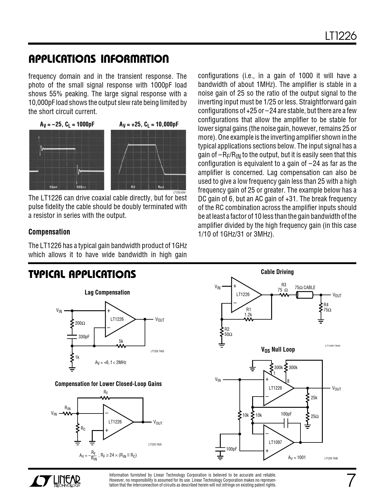

APPLICATI. S I FOR ATIO. AV = –25, CL = 1000pF. AV = +25, CL = 10,000pF. Compensation. TYPICAL APPLICATI. Cable Driving
APPLICATI S I FOR ATIO AV = –25, CL = 1000pF AV = +25, CL = 10,000pF Compensation TYPICAL APPLICATI Cable Driving
LT1226
O U U W U APPLICATI S I FOR ATIO
frequency domain and in the transient response. The configurations (i.e., in a gain of 1000 it will have a photo of the small signal response with 1000pF load bandwidth of about 1MHz). The amplifier is stable in a shows 55% peaking. The large signal response with a noise gain of 25 so the ratio of the output signal to the 10,000pF load shows the output slew rate being limited by inverting input must be 1/25 or less. Straightforward gain the short circuit current. configurations of +25 or –24 are stable, but there are a few configurations that allow the amplifier to be stable for
lower signal gains (the noise gain, however, remains 25 or more). One example is the inverting amplifier shown in the typical applications sections below. The input signal has a gain of –RF/RIN to the output, but it is easily seen that this configuration is equivalent to a gain of –24 as far as the amplifier is concerned. Lag compensation can also be used to give a low frequency gain less than 25 with a high LT1226 AI04 frequency gain of 25 or greater. The example below has a The LT1226 can drive coaxial cable directly, but for best DC gain of 6, but an AC gain of +31. The break frequency pulse fidelity the cable should be doubly terminated with of the RC combination across the amplifier inputs should a resistor in series with the output. be at least a factor of 10 less than the gain bandwidth of the amplifier divided by the high frequency gain (in this case
Compensation
1/10 of 1GHz/31 or 3MHz). The LT1226 has a typical gain bandwidth product of 1GHz which allows it to have wide bandwidth in high gain
O U TYPICAL APPLICATI S Cable Driving
R3 + IN V 75 CABLE Ω
Lag Compensation
75 Ω LT1226 OUT V – R4 V R1 IN + 75Ω 1.2k LT1226 VOUT 200Ω – R2 50Ω 330pF 5k LT1226 TA04 LT1226 TA03
VOS Null Loop
1k AV = +6, f < 2MHz 300k 300k 1 VIN +
Compensation for Lower Closed-Loop Gains
8 LT1226 VOUT RF – 25k RIN VIN – 10k 10k 100pF 25Ω LT1226 VOUT RC + – LT1097 LT1226 TA05 100pF + RF AV = – ; R R F ≥ 24 × (RIN || RC) IN A LT1226 TA06 V = 1001 Information furnished by Linear Technology Corporation is believed to be accurate and reliable. However, no responsibility is assumed for its use. Linear Technology Corporation makes no represen- tation that the interconnection of circuits as described herein will not infringe on existing patent rights. 7
