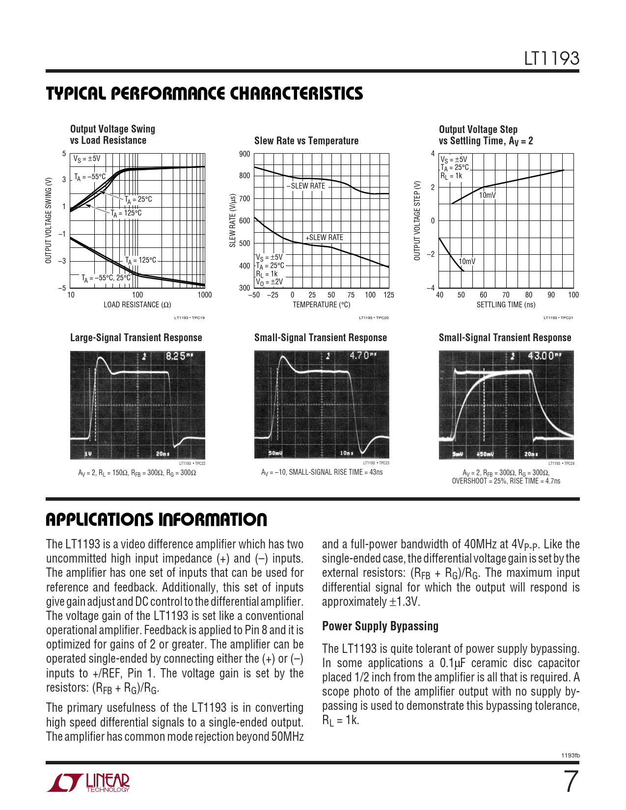

TYPICAL PERFOR A CE CHARACTERISTICS. Output Voltage Swing. Output Voltage Step. vs Load Resistance. Slew Rate vs Temperature
TYPICAL PERFOR A CE CHARACTERISTICS Output Voltage Swing Output Voltage Step vs Load Resistance Slew Rate vs Temperature
LT1193
W U TYPICAL PERFOR A CE CHARACTERISTICS Output Voltage Swing Output Voltage Step vs Load Resistance Slew Rate vs Temperature vs Settling Time, AV = 2
5 900 4 VS = ±5V VS = ±5V TA = 25°C T 800 RL = 1k 3 A = –55°C – SLEW RATE 2 10mV TA = 25°C µs) 700 1 TA = 125°C TE (V/ 600 TAGE STEP (V) 0 –1 +SLEW RATE SLEW RA 500 V –2 T S = ±5V OUTPUT VOL OUTPUT VOLTAGE SWING (V) –3 A = 125°C 10mV 400 TA = 25°C RL = 1k TA = –55°C, 25°C VO = ±2V –5 300 –4 10 100 1000 –50 –25 0 25 50 75 100 125 40 50 60 70 80 90 100 LOAD RESISTANCE (Ω) TEMPERATURE (°C) SETTLING TIME (ns) LT1193 • TPC19 LT1193 • TPC20 LT1193 • TPC21
Large-Signal Transient Response Small-Signal Transient Response Small-Signal Transient Response
LT1193 • TPC22 LT1193 • TPC23 LT1193 • TPC24 AV = 2, RL = 150Ω, RFB = 300Ω, RG = 300Ω AV = –10, SMALL-SIGNAL RISE TIME = 43ns AV = 2, RFB = 300Ω, RG = 300Ω, OVERSHOOT = 25%, RISE TIME = 4.7ns
