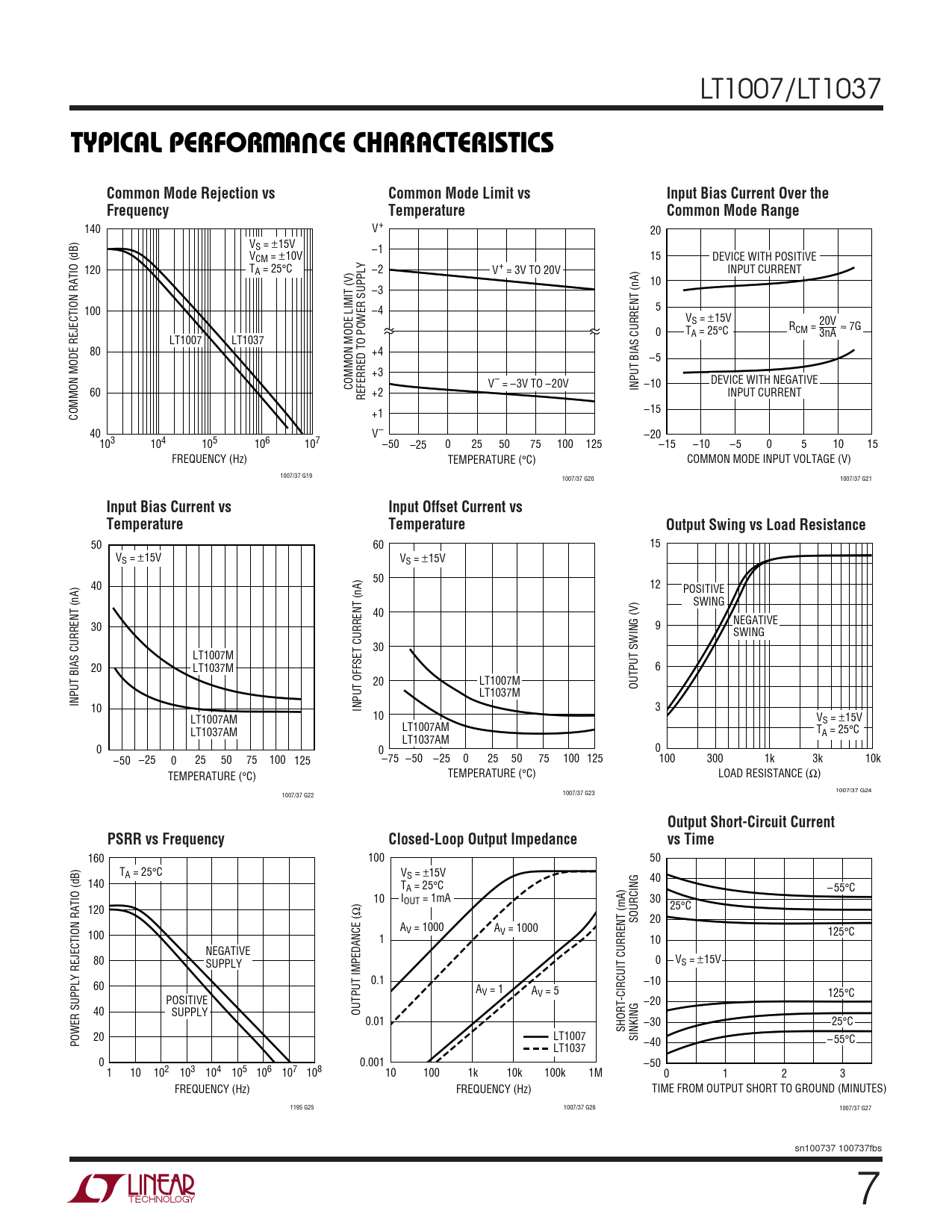

TYPICAL PERFORMANCE CHARACTERISTICS. Common Mode Rejection vs. Common Mode Limit vs. Input Bias Current Over the. Frequency
TYPICAL PERFORMANCE CHARACTERISTICS Common Mode Rejection vs Common Mode Limit vs Input Bias Current Over the Frequency
LT1007/LT1037
W U TYPICAL PERFORMANCE CHARACTERISTICS Common Mode Rejection vs Common Mode Limit vs Input Bias Current Over the Frequency Temperature Common Mode Range
140 V+ 20 VS = ±15V –1 VCM = ±10V 15 DEVICE WITH POSITIVE 120 TA = 25°C –2 V+ = 3V TO 20V INPUT CURRENT 10 –3 100 5 –4 VS = ±15V 20V 0 TA = 25°C RCM = ≈ 7G 3nA LT1007 LT1037 80 +4 –5 +3 DEVICE WITH NEGATIVE COMMON MODE LIMIT (V) V– = –3V TO –20V INPUT BIAS CURRENT (nA) –10 60 +2 INPUT CURRENT REFERRED TO POWER SUPPLY –15 COMMON MODE REJECTION RATIO (dB) +1 40 V– –20 103 104 105 106 107 –50 –25 0 25 50 75 100 125 –15 –10 –5 0 5 10 15 FREQUENCY (Hz) TEMPERATURE (°C) COMMON MODE INPUT VOLTAGE (V) 1007/37 G19 1007/37 G20 1007/37 G21
Input Bias Current vs Input Offset Current vs Temperature Temperature Output Swing vs Load Resistance
50 60 15 VS = ±15V VS = ±15V 50 40 12 POSITIVE SWING 40 NEGATIVE 30 9 SWING 30 LT1007M 20 LT1037M 6 20 LT1007M OUTPUT SWING (V) LT1037M INPUT BIAS CURRENT (nA) 10 INPUT OFFSET CURRENT (nA) 3 LT1007AM 10 VS = ±15V LT1037AM LT1007AM TA = 25°C LT1037AM 0 0 0 –50 –25 0 25 50 75 100 125 –75 –50 –25 0 25 50 75 100 125 100 300 1k 3k 10k TEMPERATURE (°C) TEMPERATURE (°C) LOAD RESISTANCE (Ω) 1007/37 G24 1007/37 G22 1007/37 G23
Output Short-Circuit Current PSRR vs Frequency Closed-Loop Output Impedance vs Time
160 100 50 TA = 25°C VS = ±15V 40 140 TA = 25°C – 55°C 10 IOUT = 1mA 30 ) 25°C 120 Ω SOURCING 20 AV = 1000 AV = 1000 125°C 100 1 10 NEGATIVE 80 0 VS = ±15V SUPPLY 0.1 –10 60 AV = 1 AV = 5 125°C POSITIVE –20 40 SUPPLY OUTPUT IMPEDANCE ( 0.01 –30 25°C SHORT-CIRCUIT CURRENT (mA) 20 LT1007 SINKING POWER SUPPLY REJECTION RATIO (dB) –40 – 55°C LT1037 0 0.001 –50 1 102 10 103 104 105 106 107 108 10 100 1k 10k 100k 1M 0 1 2 3 FREQUENCY (Hz) FREQUENCY (Hz) TIME FROM OUTPUT SHORT TO GROUND (MINUTES) 1195 G25 1007/37 G26 1007/37 G27 sn100737 100737fbs 7
