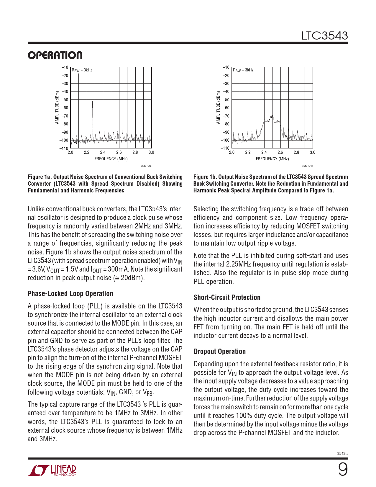

OPERATION. Figure 1a. Output Noise Spectrum of Conventional Buck Switching
OPERATION Figure 1a Output Noise Spectrum of Conventional Buck Switching
LTC3543
OPERATION
–10 –10 RBW = 3kHz RBW = 3kHz –20 –20 –30 –30 –40 –40 –50 –50 –60 –60 –70 –70 AMPLITUDE (dBm) –80 AMPLITUDE (dBm) –80 –90 –90 –100 –100 –110 –110 2.0 2.2 2.4 2.6 2.8 3.0 2.0 2.2 2.4 2.6 2.8 3.0 FREQUENCY (MHz) FREQUENCY (MHz) 3543 F01a 3543 F01b
Figure 1a. Output Noise Spectrum of Conventional Buck Switching Figure 1b. Output Noise Spectrum of the LTC3543 Spread Spectrum Converter (LTC3543 with Spread Spectrum Disabled) Showing Buck Switching Converter. Note the Reduction in Fundamental and Fundamental and Harmonic Frequencies Harmonic Peak Spectral Amplitude Compared to Figure 1a.
Unlike conventional buck converters, the LTC3543’s inter- Selecting the switching frequency is a trade-off between nal oscillator is designed to produce a clock pulse whose effi ciency and component size. Low frequency opera- frequency is randomly varied between 2MHz and 3MHz. tion increases effi ciency by reducing MOSFET switching This has the benefi t of spreading the switching noise over losses, but requires larger inductance and/or capacitance a range of frequencies, signifi cantly reducing the peak to maintain low output ripple voltage. noise. Figure 1b shows the output noise spectrum of the Note that the PLL is inhibited during soft-start and uses LTC3543 (with spread spectrum operation enabled) with VIN the internal 2.25MHz frequency until regulation is estab- = 3.6V, VOUT = 1.5V and IOUT = 300mA. Note the signifi cant lished. Also the regulator is in pulse skip mode during reduction in peak output noise (≅ 20dBm). PLL operation.
