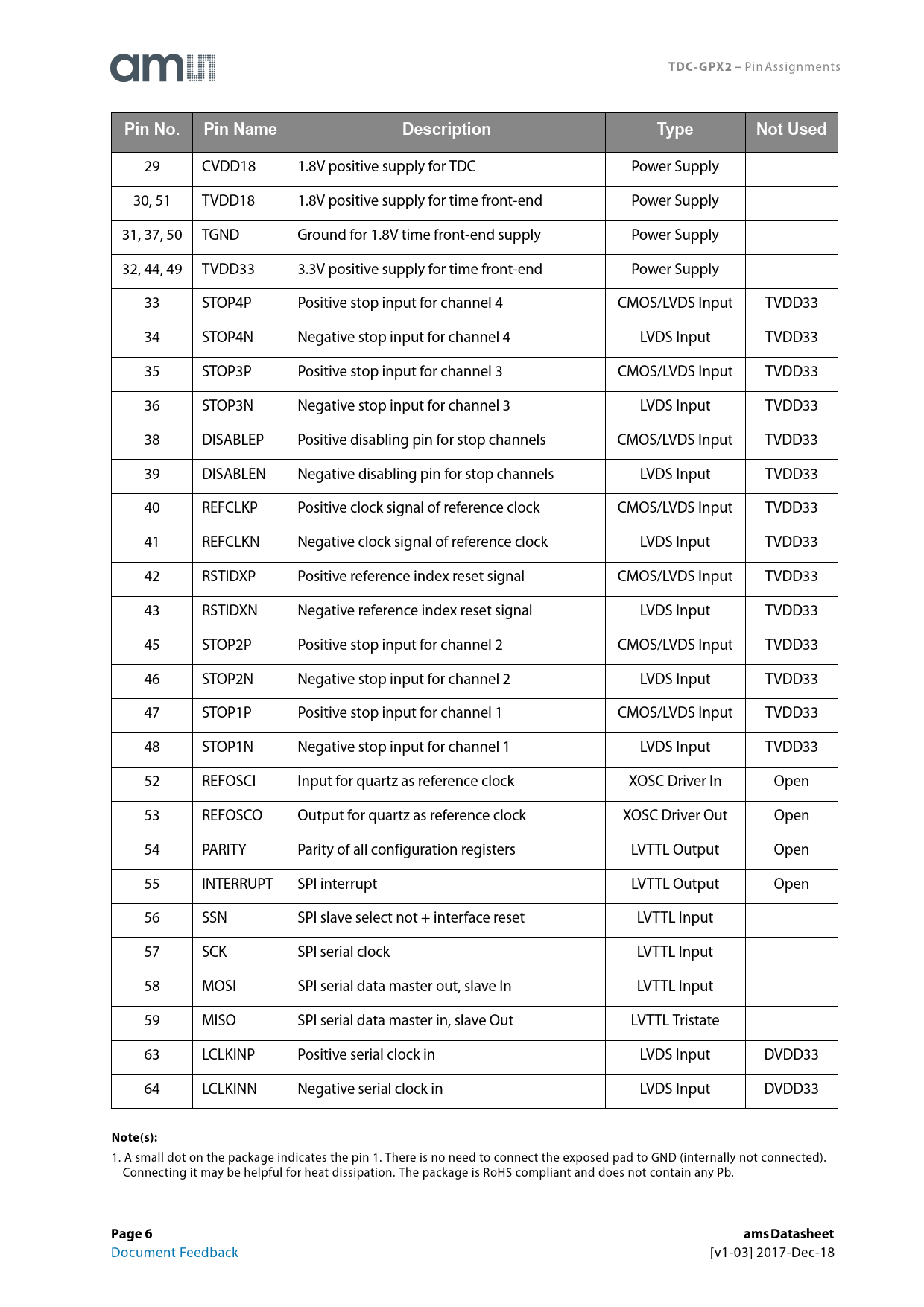

Pin Assignments
Pin No. Pin Name Description Type Not Used
29 CVDD18 1.8V positive supply for TDC Power Supply 30, 51 TVDD18 1.8V positive supply for time front-end Power Supply 31, 37, 50 TGND Ground for 1.8V time front-end supply Power Supply 32, 44, 49 TVDD33 3.3V positive supply for time front-end Power Supply 33 STOP4P Positive stop input for channel 4 CMOS/LVDS Input TVDD33 34 STOP4N Negative stop input for channel 4 LVDS Input TVDD33 35 STOP3P Positive stop input for channel 3 CMOS/LVDS Input TVDD33 36 STOP3N Negative stop input for channel 3 LVDS Input TVDD33 38 DISABLEP Positive disabling pin for stop channels CMOS/LVDS Input TVDD33 39 DISABLEN Negative disabling pin for stop channels LVDS Input TVDD33 40 REFCLKP Positive clock signal of reference clock CMOS/LVDS Input TVDD33 41 REFCLKN Negative clock signal of reference clock LVDS Input TVDD33 42 RSTIDXP Positive reference index reset signal CMOS/LVDS Input TVDD33 43 RSTIDXN Negative reference index reset signal LVDS Input TVDD33 45 STOP2P Positive stop input for channel 2 CMOS/LVDS Input TVDD33 46 STOP2N Negative stop input for channel 2 LVDS Input TVDD33 47 STOP1P Positive stop input for channel 1 CMOS/LVDS Input TVDD33 48 STOP1N Negative stop input for channel 1 LVDS Input TVDD33 52 REFOSCI Input for quartz as reference clock XOSC Driver In Open 53 REFOSCO Output for quartz as reference clock XOSC Driver Out Open 54 PARITY Parity of all configuration registers LVTTL Output Open 55 INTERRUPT SPI interrupt LVTTL Output Open 56 SSN SPI slave select not + interface reset LVTTL Input 57 SCK SPI serial clock LVTTL Input 58 MOSI SPI serial data master out, slave In LVTTL Input 59 MISO SPI serial data master in, slave Out LVTTL Tristate 63 LCLKINP Positive serial clock in LVDS Input DVDD33 64 LCLKINN Negative serial clock in LVDS Input DVDD33
Note(s):
1. A small dot on the package indicates the pin 1. There is no need to connect the exposed pad to GND (internally not connected). Connecting it may be helpful for heat dissipation. The package is RoHS compliant and does not contain any Pb.
