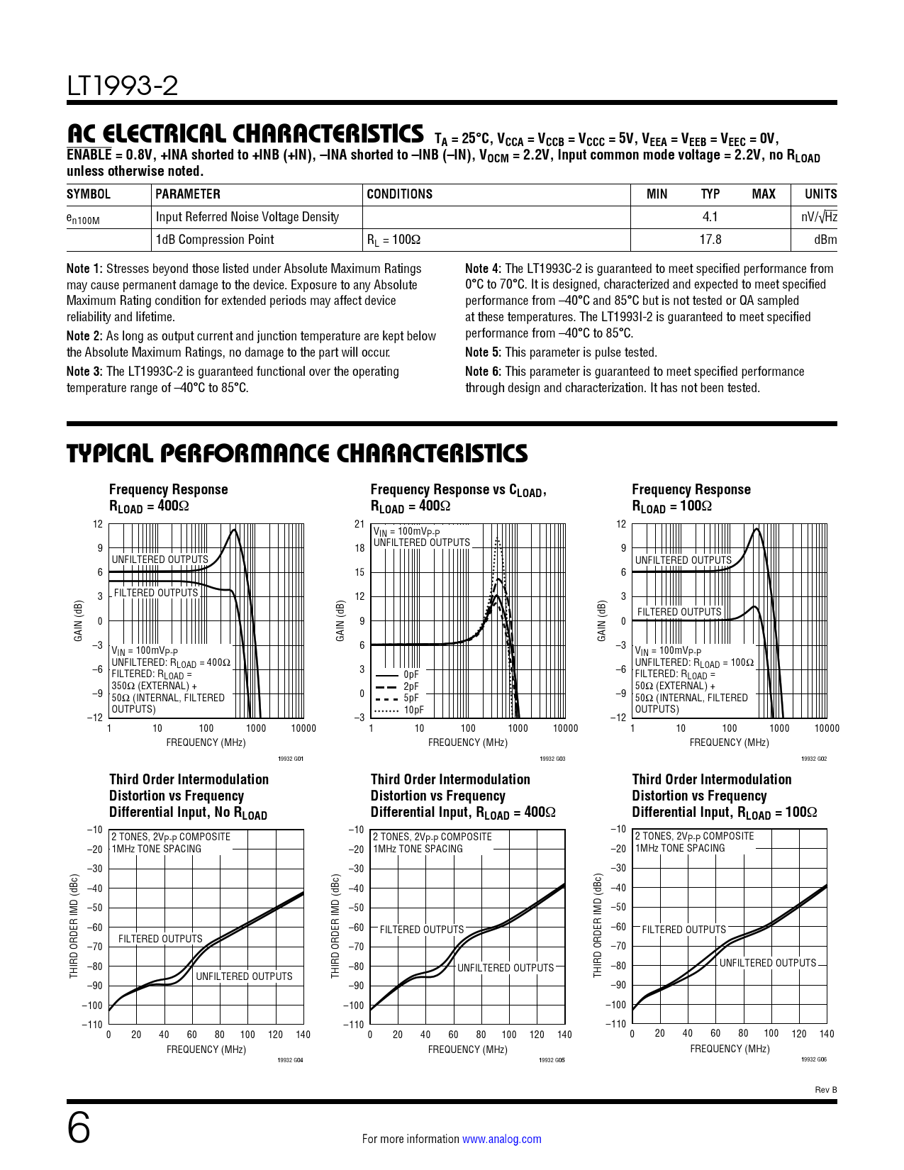

LT1993-2 AC ELECTRICAL CHARACTERISTICS
TA = 25°C, VCCA = VCCB = VCCC = 5V, VEEA = VEEB = VEEC = 0V, ENABLE = 0.8V, +INA shorted to +INB (+IN), –INA shorted to –INB (–IN), VOCM = 2.2V, Input common mode voltage = 2.2V, no RLOAD unless otherwise noted. SYMBOL PARAMETER CONDITIONS MIN TYP MAX UNITS
en100M Input Referred Noise Voltage Density 4.1 nV/√Hz 1dB Compression Point RL = 100 17.8 dBm
Note 1:
Note 4:
The LT1993C-2 is guaranteed to meet specified performance from may cause permanent damage to the device. Exposure to any Absolute 0°C to 70°C. It is designed, characterized and expected to meet specified Maximum Rating condition for extended periods may affect device performance from –40°C and 85°C but is not tested or QA sampled reliability and lifetime. at these temperatures. The LT1993I-2 is guaranteed to meet specified
Note 2:
As long as output current and junction temperature are kept below performance from –40°C to 85°C. the Absolute Maximum Ratings, no damage to the part will occur.
Note 5:
This parameter is pulse tested.
Note 3:
The LT1993C-2 is guaranteed functional over the operating
Note 6:
This parameter is guaranteed to meet specified performance temperature range of –40°C to 85°C. through design and characterization. It has not been tested. TYPICAL PERFORMANCE CHARACTERISTICS
Frequency Response Frequency Response vs CLOAD, Frequency Response RLOAD = 400 RLOAD = 400 RLOAD = 100
12 21 12 VIN = 100mVP-P 9 18 UNFILTERED OUTPUTS 9 UNFILTERED OUTPUTS UNFILTERED OUTPUTS 6 15 6 3 FILTERED OUTPUTS 12 3 FILTERED OUTPUTS 0 9 0 GAIN (dB) GAIN (dB) GAIN (dB) –3 6 V –3 IN = 100mVP-P VIN = 100mVP-P UNFILTERED: R UNFILTERED: R –6 LOAD = 400Ω 3 LOAD = 100Ω FILTERED: R –6 LOAD = 0pF FILTERED: RLOAD = 350Ω (EXTERNAL) + 2pF 50Ω (EXTERNAL) + –9 0 50Ω (INTERNAL, FILTERED 5pF –9 50Ω (INTERNAL, FILTERED OUTPUTS) 10pF OUTPUTS) –12 –3 –12 1 10 100 1000 10000 1 10 100 1000 10000 1 10 100 1000 10000 FREQUENCY (MHz) FREQUENCY (MHz) FREQUENCY (MHz) 19932 G01 19932 G03 19932 G02
Third Order Intermodulation Third Order Intermodulation Third Order Intermodulation Distortion vs Frequency Distortion vs Frequency Distortion vs Frequency Differential Input, No RLOAD Differential Input, RLOAD = 400 Differential Input, RLOAD = 100
–10 –10 –10 2 TONES, 2V 2 TONES, 2V 2 TONES, 2V P-P COMPOSITE P-P COMPOSITE P-P COMPOSITE –20 1MHz TONE SPACING –20 1MHz TONE SPACING –20 1MHz TONE SPACING –30 –30 –30 –40 –40 –40 –50 –50 –50 –60 –60 –60 FILTERED OUTPUTS FILTERED OUTPUTS FILTERED OUTPUTS –70 –70 –70 –80 –80 UNFILTERED OUTPUTS –80 UNFILTERED OUTPUTS THIRD ORDER IMD (dBc) UNFILTERED OUTPUTS THIRD ORDER IMD (dBc) THIRD ORDER IMD (dBc) –90 –90 –90 –100 –100 –100 –110 –110 –110 0 20 40 60 80 100 120 140 0 20 40 60 80 100 120 140 0 20 40 60 80 100 120 140 FREQUENCY (MHz) FREQUENCY (MHz) FREQUENCY (MHz) 19932 G04 19932 G05 19932 G06 Rev B 6 For more information www.analog.com
