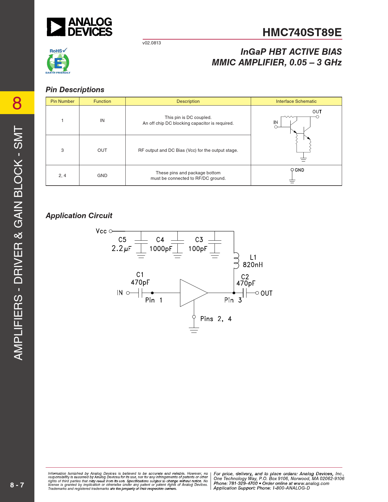

HMC740ST89E. InGaP HBT ACTIVE BIAS. MMIC AMPLIFIER, 0.05 – 3 GHz. Pin Descriptions. Application Circuit. 8 - 7
HMC740ST89E InGaP HBT ACTIVE BIAS MMIC AMPLIFIER, 0.05 – 3 GHz Pin Descriptions Application Circuit 8 - 7
HMC740ST89E
v02.0813
8 Pin Number Function Description Interface Schematic This pin is DC coupled. 1 IN T An off chip DC blocking capacitor is required. M 3 OUT RF output and DC Bias (Vcc) for the output stage. K - S C These pins and package bottom 2, 4 GND must be connected to RF/DC ground. LO IN B A
Application Circuit
