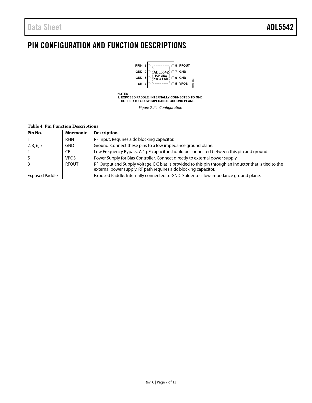

Data Sheet. ADL5542. PIN CONFIGURATION AND FUNCTION DESCRIPTIONS. RFIN 1. 8 RFOUT. GND 2. 7 GND. TOP VIEW. GND 3. 6 GND. (Not to Scale). CB 4
Data Sheet ADL5542 PIN CONFIGURATION AND FUNCTION DESCRIPTIONS RFIN 1 8 RFOUT GND 2 7 GND TOP VIEW GND 3 6 GND (Not to Scale) CB 4
Data Sheet ADL5542 PIN CONFIGURATION AND FUNCTION DESCRIPTIONS RFIN 1 8 RFOUT GND 2 7 GND ADL5542 TOP VIEW GND 3 6 GND (Not to Scale)
002
CB 4 5 VPOS
06879-
NOTES 1. EXPOSED PADDLE. INTERNALLY CONNECTED TO GND. SOLDER TO A LOW IMPEDANCE GROUND PLANE.
Figure 2. Pin Configuration
Table 4. Pin Function Descriptions Pin No. Mnemonic Description
1 RFIN RF Input. Requires a dc blocking capacitor. 2, 3, 6, 7 GND Ground. Connect these pins to a low impedance ground plane. 4 CB Low Frequency Bypass. A 1 µF capacitor should be connected between this pin and ground. 5 VPOS Power Supply for Bias Controller. Connect directly to external power supply. 8 RFOUT RF Output and Supply Voltage. DC bias is provided to this pin through an inductor that is tied to the external power supply. RF path requires a dc blocking capacitor. Exposed Paddle Exposed Paddle. Internally connected to GND. Solder to a low impedance ground plane. Rev. C | Page 7 of 13 Document Outline FEATURES FUNCTIONAL BLOCK DIAGRAM GENERAL DESCRIPTION TABLE OF CONTENTS REVISION HISTORY SPECIFICATIONS TYPICAL SCATTERING PARAMETERS ABSOLUTE MAXIMUM RATINGS ESD CAUTION PIN CONFIGURATION AND FUNCTION DESCRIPTIONS TYPICAL PERFORMANCE CHARACTERISTICS OPERATING TO 20 MHz BASIC CONNECTIONS SOLDERING INFORMATION AND RECOMMENDED PCB LAND PATTERN EVALUATION BOARD OUTLINE DIMENSIONS ORDERING GUIDE
