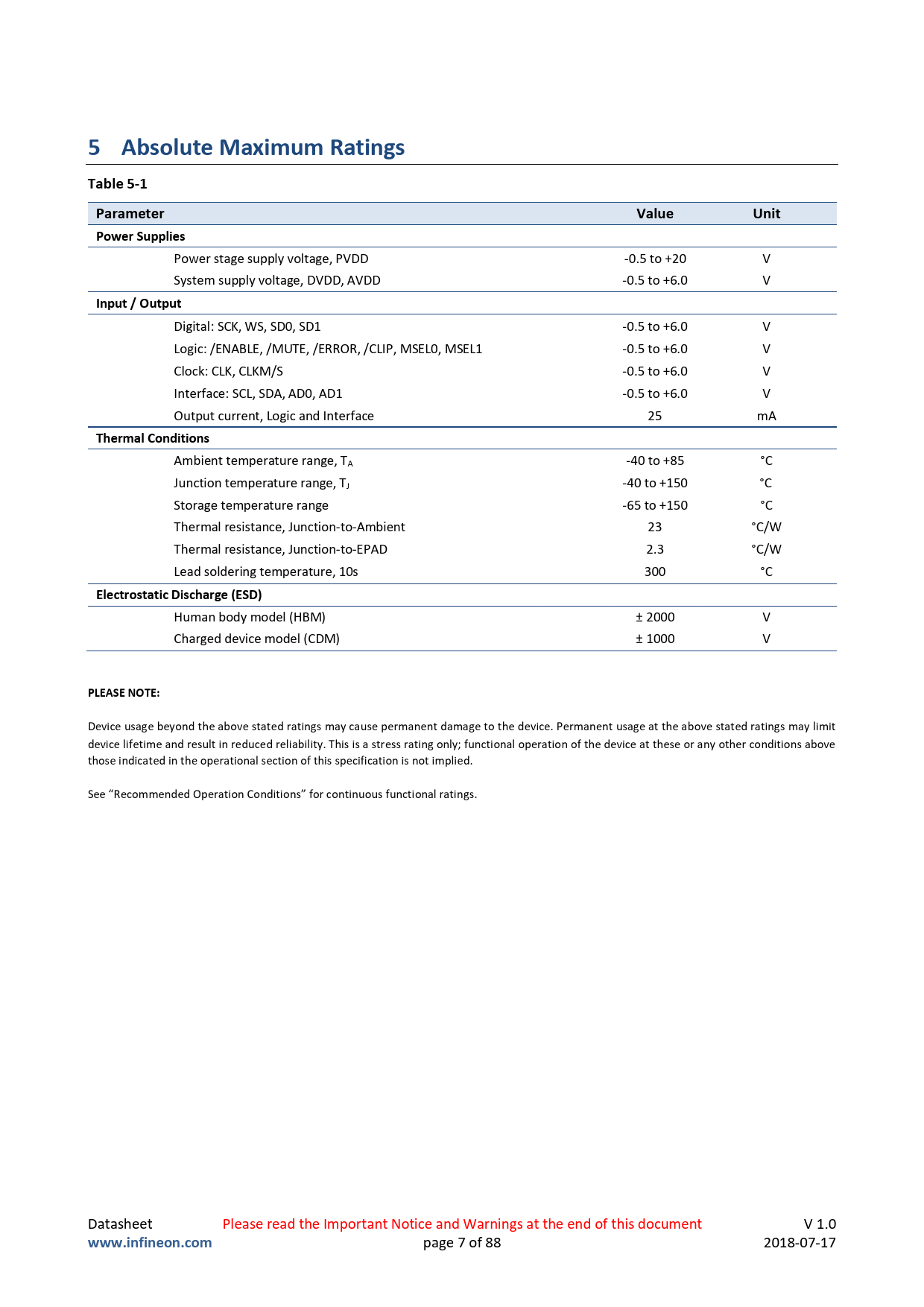

5 Absolute Maximum Ratings. Table 5-1. Parameter. Value. Unit. Power Supplies. Input / Output. Thermal Conditions
5 Absolute Maximum Ratings Table 5-1 Parameter Value Unit Power Supplies Input / Output Thermal Conditions
Power stage supply voltage, PVDD -0.5 to +20 V System supply voltage, DVDD, AVDD -0.5 to +6.0 V
Input / Output
Digital: SCK, WS, SD0, SD1 -0.5 to +6.0 V Logic: /ENABLE, /MUTE, /ERROR, /CLIP, MSEL0, MSEL1 -0.5 to +6.0 V Clock: CLK, CLKM/S -0.5 to +6.0 V Interface: SCL, SDA, AD0, AD1 -0.5 to +6.0 V Output current, Logic and Interface 25 mA
Thermal Conditions
Ambient temperature range, TA -40 to +85 °C Junction temperature range, TJ -40 to +150 °C Storage temperature range -65 to +150 °C Thermal resistance, Junction-to-Ambient 23 °C/W Thermal resistance, Junction-to-EPAD 2.3 °C/W Lead soldering temperature, 10s 300 °C
Electrostatic Discharge (ESD)
Human body model (HBM) ± 2000 V Charged device model (CDM) ± 1000 V
PLEASE NOTE:
Device usage beyond the above stated ratings may cause permanent damage to the device. Permanent usage at the above stated ratings may limit device lifetime and result in reduced reliability. This is a stress rating only; functional operation of the device at these or any other conditions above those indicated in the operational section of this specification is not implied. See “Recommended Operation Conditions” for continuous functional ratings. Datasheet Please read the Important Notice and Warnings at the end of this document V 1.0
