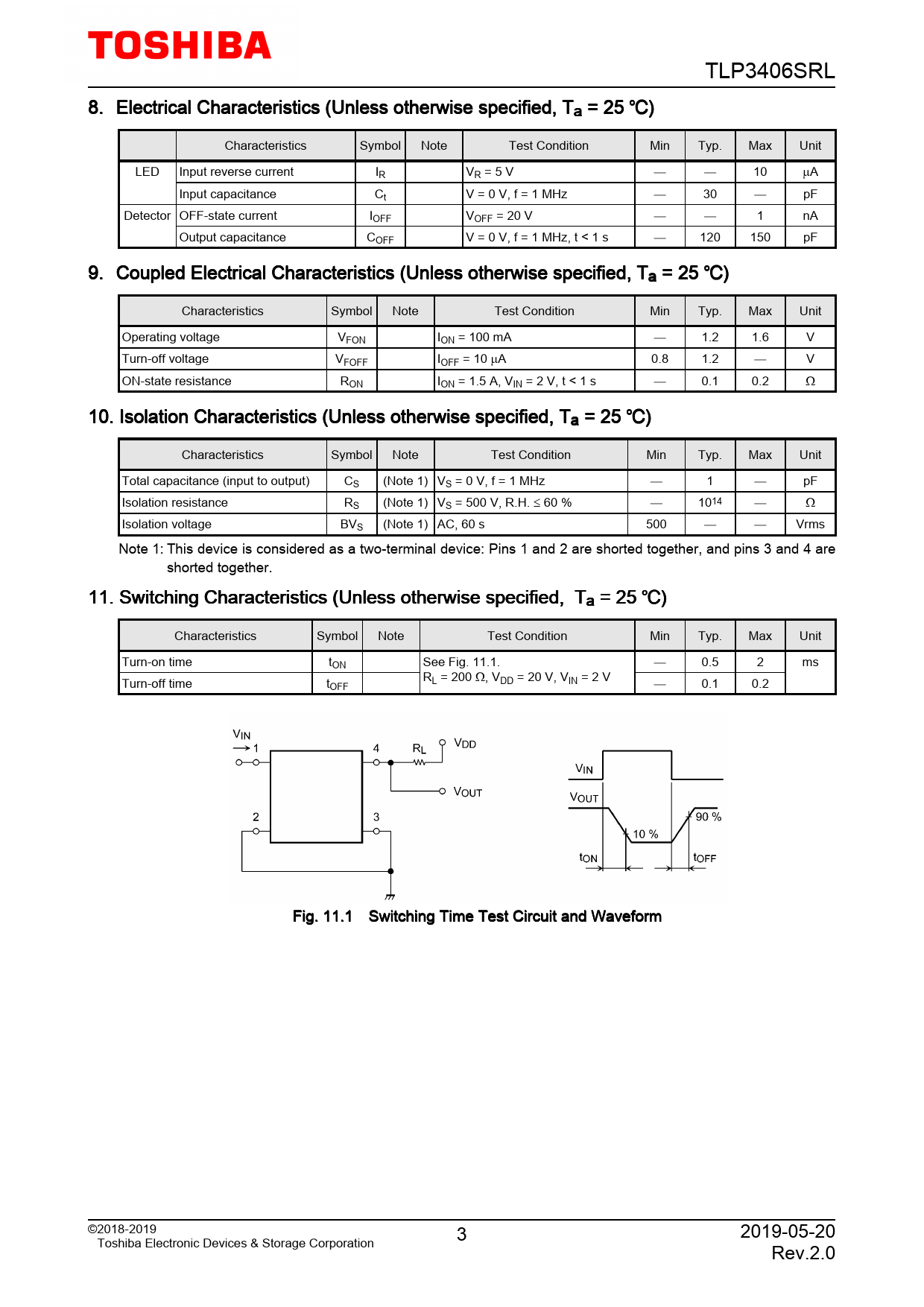

TLP3406SRL. 8. Electrical. Characteristics. (Unless. otherwise. specified,. Ta. =. 25. ). Characteristics. Symbol. Note. Test. Condition. Min. Typ. Max. Unit
TLP3406SRL 8 Electrical Characteristics (Unless otherwise specified, Ta = 25 ) Characteristics Symbol Note Test Condition Min Typ Max Unit
TLP3406SRL 8. Electrical Characteristics (Unless otherwise specified, Ta = 25 ) Characteristics Symbol Note Test Condition Min Typ. Max Unit LED Input reverse current IR VR = 5 V   10 µA Input capacitance Ct V = 0 V, f = 1 MHz  30  pF Detector OFF-state current IOFF VOFF = 20 V   1 nA Output capacitance COFF V = 0 V, f = 1 MHz, t < 1 s  120 150 pF 9. Coupled Electrical Characteristics (Unless otherwise specified, Ta = 25 ) Characteristics Symbol Note Test Condition Min Typ. Max Unit Operating voltage VFON ION = 100 mA  1.2 1.6 V Turn-off voltage VFOFF IOFF = 10 µA 0.8 1.2  V ON-state resistance RON ION = 1.5 A, VIN = 2 V, t < 1 s  0.1 0.2 Ω 10. Isolation Characteristics (Unless otherwise specified, Ta = 25 ) Characteristics Symbol Note Test Condition Min Typ. Max Unit Total capacitance (input to output) CS (Note 1) VS = 0 V, f = 1 MHz  1  pF Isolation resistance RS (Note 1) VS = 500 V, R.H. ≤ 60 %  1014  Ω Isolation voltage BVS (Note 1) AC, 60 s 500   Vrms Note 1: This device is considered as a two-terminal device: Pins 1 and 2 are shorted together, and pins 3 and 4 are shorted together. 11. Switching Characteristics (Unless otherwise specified, Ta = 25 ) Characteristics Symbol Note Test Condition Min Typ. Max Unit Turn-on time tON See Fig. 11.1.  0.5 2 ms Turn-off time t RL = 200 Ω, VDD = 20 V, VIN = 2 V OFF  0.1 0.2 Fig. 11.1 Switching Time Test Circuit and Waveform ©2018-2019 3 2019-05-20 Toshiba Electronic Devices & Storage Corporation Rev.2.0
