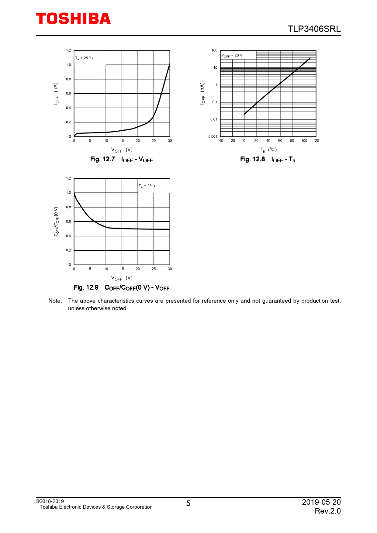

Pages / Page14 / 5 — TLP3406SRL. Fig. 12.7. IOFF. -. VOFF. Fig. 12.8. IOFF. -. Ta. Fig. 12.9. …
File Format / SizePDF / 436 Kb
TLP3406SRL. Fig. 12.7. IOFF. -. VOFF. Fig. 12.8. IOFF. -. Ta. Fig. 12.9. COFF/COFF(0. V). -. VOFF. Note:. The. above. characteristics. curves. are. presented. for
TLP3406SRL Fig 12.7 IOFF - VOFF Fig 12.8 IOFF - Ta Fig 12.9 COFF/COFF(0 V) - VOFF Note: The above characteristics curves are presented for
TLP3406SRL Fig. 12.7 IOFF - VOFF Fig. 12.8 IOFF - Ta Fig. 12.9 COFF/COFF(0 V) - VOFF Note: The above characteristics curves are presented for reference only and not guaranteed by production test, unless otherwise noted. ©2018-2019 5 2019-05-20 Toshiba Electronic Devices & Storage Corporation Rev.2.0
