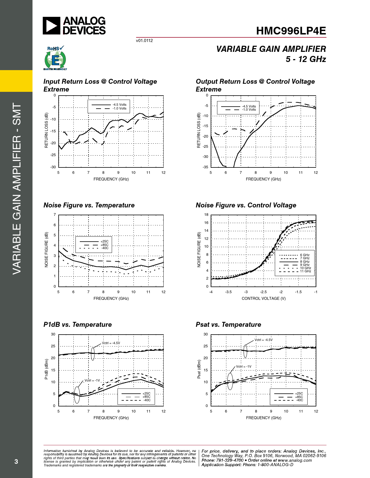

Datasheet HMC996LP4E (Analog Devices) - 3
DescriptionAnalog Variable Gain Amplifier SMT, 5 - 12 GHz
Pages / Page8 / 3 — HMC996LP4E. VARIABLE GAIN AMPLIFIER. 5 - 12 GHz. Input Return Loss @ …
File Format / SizePDF / 491 Kb
HMC996LP4E. VARIABLE GAIN AMPLIFIER. 5 - 12 GHz. Input Return Loss @ Control Voltage. Output Return Loss @ Control Voltage
HMC996LP4E VARIABLE GAIN AMPLIFIER 5 - 12 GHz Input Return Loss @ Control Voltage Output Return Loss @ Control Voltage
HMC996LP4E
v01.0112
VARIABLE GAIN AMPLIFIER 5 - 12 GHz Input Return Loss @ Control Voltage Output Return Loss @ Control Voltage Extreme Extreme
0 0 T -4.5 Volts -5 -5 -4.5 Volts m -1.0 Volts -1.0 Volts -10 (dB) -10 (dB) -15 LOSS -15 LOSS r - S -20 ie -20 RETURN RETURN -25 -25 -30 lif p -30 -35 5 6 7 8 9 10 11 12 5 6 7 8 9 10 11 12 m FREQUENCY (GHz) FREQUENCY (GHz) a in a
Noise Figure vs. Temperature Noise Figure vs. Control Voltage
7 18 16 6 le G ) 14 ) b 5 (dB (dB 12 E +25C E ia R 4 +85C R U -40C U 10 IG IG r F F 3 8 E 6 GHz E 7 GHz a IS IS O 6 8 GHz O V N 2 9 GHz N 10 GHz 4 11 GHz 1 2 0 0 5 6 7 8 9 10 11 12 -4 -3.5 -3 -2.5 -2 -1.5 -1 FREQUENCY (GHz) CONTROL VOLTAGE (V)
P1dB vs. Temperature Psat vs. Temperature
30 30 Vctrl = -4.5V Vctrl = -4.5V 25 25 20 20 (dBm) Vctrl = -1V 15 (dBm) 15 P1dB Psat 10 Vctrl = -1V 10 5 +25C 5 +25C +85C +85C -40C -40C 0 0 5 6 7 8 9 10 11 12 5 6 7 8 9 10 11 12 FREQUENCY (GHz) FREQUENCY (GHz) Inf F or o m r p atio r n ifc ur e n , d ishe e d lbiv y e A r n y a alog n D d t evic o p es is la beclie o eved rd to ebre sa: H ccur iattti e tae M nd re ilicarbloew . H a o ve C wever, o n rp o For price, delivery, and to place orders: Analog Devices, Inc., responsibility is assumed by Analog Devices for its use, nor for any infringements of patents or other oration, 2 Elizabeth Drive, Chelmsford, MA 01824 One Technology Way, P.O. Box 9106, Norwood, MA 02062-9106 Phone: 978-250-3343 Fax: 978-250-3373 O rights of third parties that may result from its use. Specifications subject to change without notice. No P rd ho e ne r O : 7 n 81- -3li 2n 9 e a -47 t w 0 w 0 • O w rd .h e it r o tniltie n .c e ao t m
