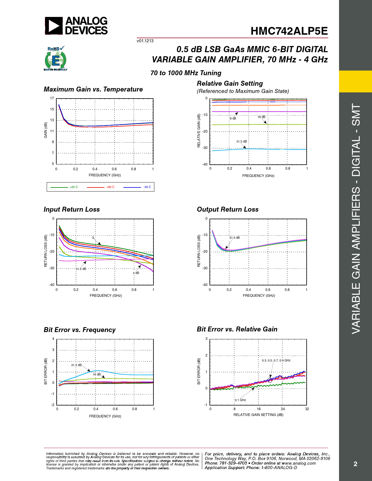

0.5 dB LSB GaAs MMIC 6-BIT DIGITAL VARIABLE GAIN AMPLIFIER, 70 MHz - 4 GHz 70 to 1000 MHz Tuning Relative Gain Setting Maximum Gain vs. Temperature
(Referenced to Maximum Gain State) 17 0 15 T -10 B) 16 dB 8 dB 13 (d M ) N B d AI ( G 11 IN -20 A IVE G AT 9 31.5 dB L - S EL R -30 7 ITA 5 -40 0 0.2 0.4 0.6 0.8 1 0 0.2 0.4 0.6 0.8 1 IG FREQUENCY (GHz) FREQUENCY (GHz) +25 C +85 C -40 C S - D R
Input Return Loss Output Return Loss
IE 0 0 LIF ) P -10 -10 B IL B 31.5 dB (d (d S S M S S O O L -20 L -20 N N UR UR T T IN A RE RE -30 31.5 dB -30 A 4 dB -40 -40 0 0.2 0.4 0.6 0.8 1 0 0.2 0.4 0.6 0.8 1 FREQUENCY (GHz) FREQUENCY (GHz) LE G B IA R A
Bit Error vs. Frequency Bit Error vs. Relative Gain
V 4 3 3 2 ) B 2 B d d 0.3, 0.5, 0.7, 0.9 GHz ( 31.5 dB ( R R O O R 1 R 1 R 16 dB R E E IT IT B 0 B 0 -1 0.1 GHz -2 -1 0 0.2 0.4 0.6 0.8 1 0 8 16 24 32 FREQUENCY (GHz) RELATIVE GAIN SETTING (dB) I F nf o or r p mati r o in cfe ur , d nish e e l d iv b e y r A y a nalo n g d t Devi o p ces i la s c bele o ieve rd d t e o rbs e : H acc iutrtatite e M and ic reli rao bl w e. a H v o e C wever o , nrp o For price, delivery, and to place orders: Analog Devices, Inc., responsibility is assumed by Analog Devices for its use, nor for any infringements of patents or other oration, 2 Elizabeth Drive, Chelmsford, MA 01824 One Technology Way, P.O. Box 9106, Norwood, MA 02062-9106 Phone: 978-250-3343 Fax: 978-250-3373 O rights of third parties that may result from its use. Specifications subject to change without notice. No rd Phoe n r O e: 7 n- 81-li 3 n 2 e a 9-4 t w 70 ww 0 • O . rdh e itt r o it nle i . n co e a m license is granted by implication or otherwise under any patent or patent rights of Analog Devices. t www.analog.com
