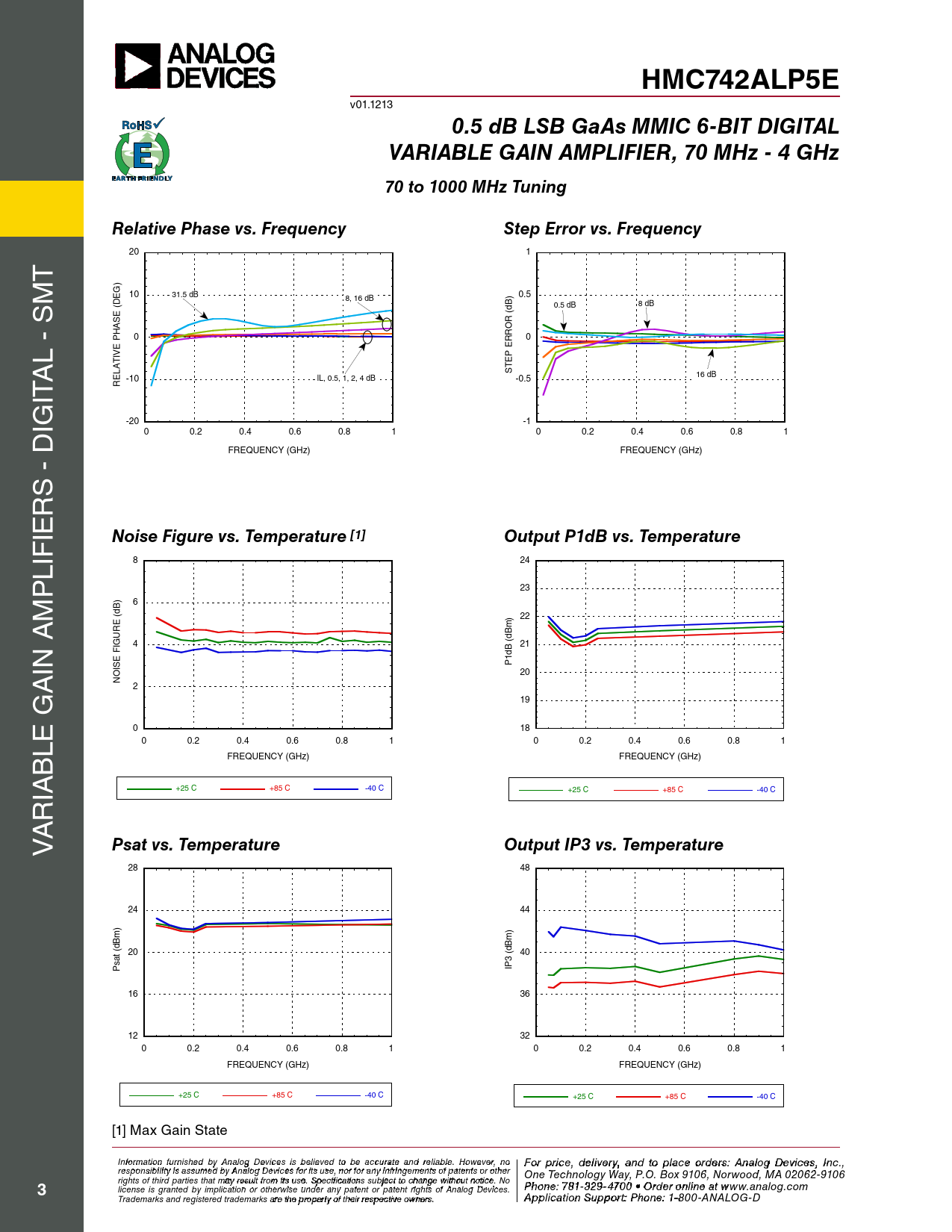

Description0.5 dB LSB GaAs MMIC 6-Bit Digital Variable Gain Amplifier SMT, 0.07 - 4 GHz
Pages / Page12 / 3 — HMC742ALP5E. 0.5 dB LSB GaAs MMIC 6-BIT DIGITAL. VARIABLE GAIN AMPLIFIER, …
File Format / SizePDF / 769 Kb
HMC742ALP5E. 0.5 dB LSB GaAs MMIC 6-BIT DIGITAL. VARIABLE GAIN AMPLIFIER, 70 MHz - 4 GHz. 70 to 1000 MHz Tuning
HMC742ALP5E 0.5 dB LSB GaAs MMIC 6-BIT DIGITAL VARIABLE GAIN AMPLIFIER, 70 MHz - 4 GHz 70 to 1000 MHz Tuning
HMC742ALP5E
v01.1213
0.5 dB LSB GaAs MMIC 6-BIT DIGITAL VARIABLE GAIN AMPLIFIER, 70 MHz - 4 GHz 70 to 1000 MHz Tuning Relative Phase vs. Frequency Step Error vs. Frequency
20 1 T M ) EG 10 31.5 dB 0.5 8, 16 dB (D B) 0.5 dB 8 dB (d R ASE O R PH 0 0 L - S ER IVE EP AT ST EL 16 dB ITA -10 IL, 0.5, 1, 2, 4 dB -0.5 R IG -20 -1 0 0.2 0.4 0.6 0.8 1 0 0.2 0.4 0.6 0.8 1 FREQUENCY (GHz) FREQUENCY (GHz) S - D R IE
Noise Figure vs. Temperature [1] Output P1dB vs. Temperature
LIF 8 24 P 23 M ) 6 B d ( ) 22 E R m U IG 4 (dB 21 IN A F E 1dB IS P A O 20 N 2 19 0 18 LE G 0 0.2 0.4 0.6 0.8 1 0 0.2 0.4 0.6 0.8 1 B FREQUENCY (GHz) FREQUENCY (GHz) IA +25 C +85 C -40 C +25 C +85 C -40 C R A V
Psat vs. Temperature Output IP3 vs. Temperature
28 48 24 44 ) m m (dB 20 (dB 40 at 3 s P IP 16 36 12 32 0 0.2 0.4 0.6 0.8 1 0 0.2 0.4 0.6 0.8 1 FREQUENCY (GHz) FREQUENCY (GHz) +25 C +85 C -40 C +25 C +85 C -40 C [1] Max Gain State I F nf o or r p mati r o in cfe ur , d nish e e l d iv b e y r A y a nalo n g d t Devi o p ces i la s c bele o ieve rd d t e o rbs e : H acc iutrtatite e M and ic reli rao bl w e. a H v o e C wever o , nrp o For price, delivery, and to place orders: Analog Devices, Inc., responsibility is assumed by Analog Devices for its use, nor for any infringements of patents or other oration, 2 Elizabeth Drive, Chelmsford, MA 01824 One Technology Way, P.O. Box 9106, Norwood, MA 02062-9106 Phone: 978-250-3343 Fax: 978-250-3373 O rights of third parties that may result from its use. Specifications subject to change without notice. No rd Phoe n r O e: 7 n- 81-li 3 n 2 e a 9-4 t w 70 ww 0 • O . rdh e itt r o it nle i . n co e a m
