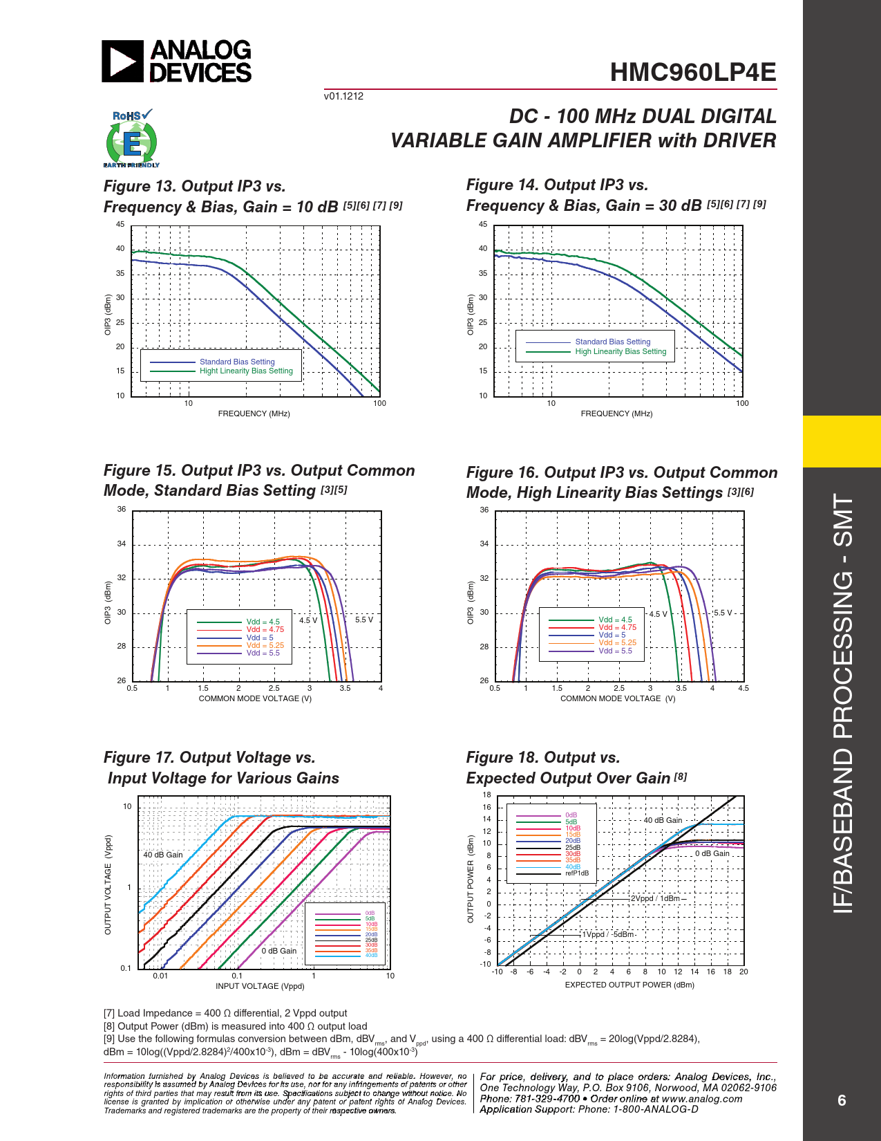

HMC960LP4E. DC - 100 MHz DUAL DigitAL. VAriAbLe gAin AMpLifier with DriVer. figure 13. Output ip3 vs. figure 14. Output ip3 vs
HMC960LP4E DC - 100 MHz DUAL DigitAL VAriAbLe gAin AMpLifier with DriVer figure 13 Output ip3 vs figure 14 Output ip3 vs
HMC960LP4E
v01.1212
DC - 100 MHz DUAL DigitAL VAriAbLe gAin AMpLifier with DriVer figure 13. Output ip3 vs. figure 14. Output ip3 vs. frequency & bias, gain = 10 db [5][6] [7] [9] frequency & bias, gain = 30 db [5][6] [7] [9]
45 45 40 40 35 35 ) 30 ) 30 Bm Bm (d (d 25 25 IP3 IP3 O O Standard Bias Setting 20 20 High Linearity Bias Setting Standard Bias Setting 15 Hight Linearity Bias Setting 15 10 10 10 100 10 100 FREQUENCY (MHz) FREQUENCY (MHz)
figure 15. Output ip3 vs. Output Common figure 16. Output ip3 vs. Output Common Mode, Standard bias Setting [3][5] Mode, High Linearity bias Settings [3][6]
36 36 T M 34 34 S - 32 ) 32 ) m m B B G (d (d 3 3 30 30 4.5 V 5.5 V IN OIP Vdd = 4.5 4.5 V 5.5 V Vdd = 4.5 OIP Vdd = 4.75 Vdd = 4.75 Vdd = 5 S Vdd = 5 28 Vdd = 5.25 28 Vdd = 5.25 Vdd = 5.5 Vdd = 5.5 S E 26 26 C 0.5 1 1.5 2 2.5 3 3.5 4 0.5 1 1.5 2 2.5 3 3.5 4 4.5 COMMON MODE VOLTAGE (V) COMMON MODE VOLTAGE (V) RO P
figure 17. Output Voltage vs. figure 18. Output vs.
D
input Voltage for Various gains expected Output Over gain [8]
N 18 A 10 16 14 0dB 5dB 40 dB Gain B 12 10dB ) 15dB E d p 10 20dB Bm 25dB 40 dB Gain 8 30dB 0 dB Gain S (Vp (d 35dB E ER 6 40dB A refP1dB AG W T 4 L 1 PO 2 T VO 2Vppd / 1dBm T PU 0 T 0dB PU U -2 5dB IF/B T O 10dB U 15dB -4 O 20dB 1Vppd / -5dBm 25dB -6 30dB 35dB 0 dB Gain -8 40dB 0.1 -10 -10 -8 -6 -4 -2 0 2 4 6 8 10 12 14 16 18 20 0.01 0.1 1 10 INPUT VOLTAGE (Vppd) EXPECTED OUTPUT POWER (dBm) [7] Load Impedance = 400 Ω differential, 2 Vppd output [8] Output Power (dBm) is measured into 400 Ω output load [9] Use the following formulas conversion between dBm, dBV , and V , using a 400 Ω differential load: dBV = 20log(Vppd/2.8284), rms ppd rms dBm = 10log((Vppd/2.8284)2/400x10-3), dBm = dBV - 10log(400x10-3) rms Inf F or o m r p atio r n fic ur e n , d ishe e d lbiv y e An ry a alog n Ded t viceo p s is la belciee o ved rd to e b r e sa: H ccur iattte itae M nd rel iic a r bl o e. w H a o v we e C ver, noo For price, delivery, and to place orders: Analog Devices, Inc., responsibility is assumed by Analog Devices for its use, nor for any infringements of patents or other rporation, 2 Elizabeth Drive, Chelmsford, MA 01824 One Technology Way, P.O. Box 9106, Norwood, MA 02062-9106 978-250-3343 tel • 978-250-3373 fax • O rights of third parties that may result from its use. Specifications subject to change without notice. No rd P e hor O ne n : 7 -li 81 n -3e a 29- t w 470 ww. 0 • O h rdit e tit r oe n .lic n om license is granted by implication or otherwise under any patent or patent rights of Analog Devices. e at www.analog.com
