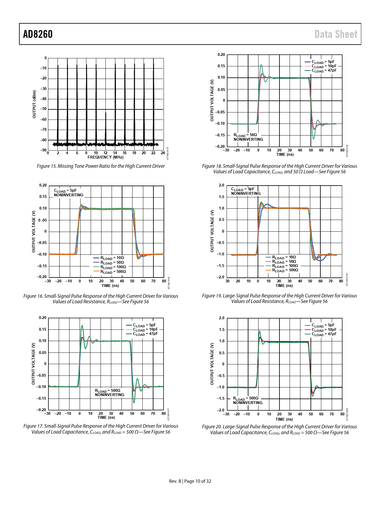

19 07 07 Figure 15. Missing Tone Power Ratio for the High Current Driver Figure 18. Small-Signal Pulse Response of the High Current Driver for Various Values of Load Capacitance, CLOAD, and 50 Ω Load—See Figure 56

07 07 Figure 16. Small-Signal Pulse Response of the High Current Driver for Various Figure 19. Large-Signal Pulse Response of the High Current Driver for Various Values of Load Resistance, RLOAD—See Figure 56 Values of Load Resistance, RLOAD—See Figure 56

07 Figure 17. Small-Signal Pulse Response of the High Current Driver for Various Figure 20. Large-Signal Pulse Response of the High Current Driver for Various Values of Load Capacitance, CLOAD, and RLOAD = 500 Ω—See Figure 56 Values of Load Capacitance, CLOAD, and RLOAD = 500 Ω—See Figure 56 Rev. B | Page 10 of 32 Document Outline FEATURES APPLICATIONS FUNCTIONAL BLOCK DIAGRAM GENERAL DESCRIPTION TABLE OF CONTENTS REVISION HISTORY SPECIFICATIONS ABSOLUTE MAXIMUM RATINGS ESD CAUTION PIN CONFIGURATION AND FUNCTION DESCRIPTIONS TYPICAL PERFORMANCE CHARACTERISTICS TEST CIRCUITS THEORY OF OPERATION OVERVIEW HIGH CURRENT DRIVER AMPLIFIER PRECAUTIONS TO BE OBSERVED DURING HALF-DUPLEX OPERATION VMID BUFFER PREAMPLIFIER PREAMPLIFIER NOISE DGA GAIN CONTROL OUTPUT STAGE ATTENUATOR SINGLE-SUPPLY OPERATION AND AC COUPLING POWER-UP/POWER-DOWN SEQUENCE LOGIC INTERFACES APPLICATIONS INFORMATION EVALUATION BOARD CONNECTING THE EVALUATION BOARD OUTLINE DIMENSIONS ORDERING GUIDE
