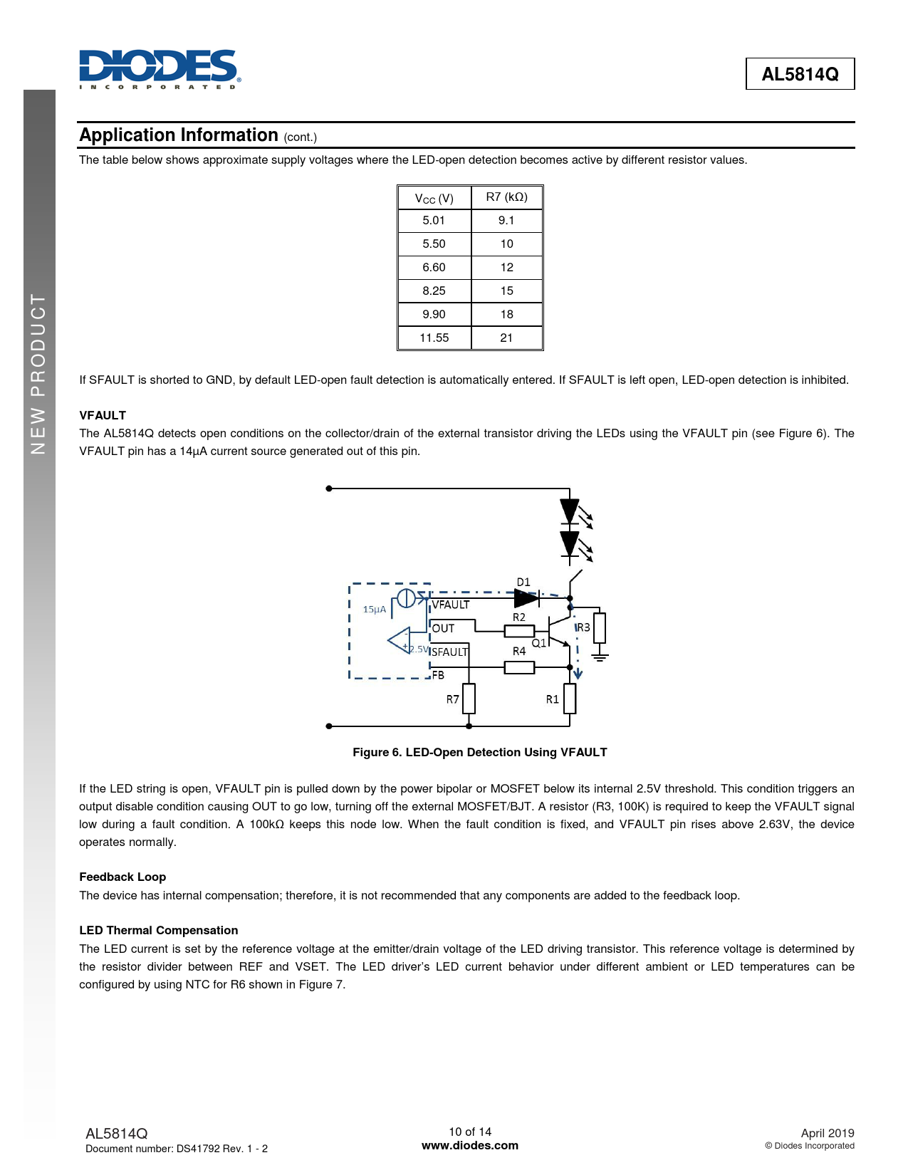

(cont.) The table below shows approximate supply voltages where the LED-open detection becomes active by different resistor values. VCC (V) R7 (kΩ) 5.01 9.1 5.50 10 6.60 12

If SFAULT is shorted to GND, by default LED-open fault detection is automatically entered. If SFAULT is left open, LED-open detection is inhibited.
P W VFAULT E
The AL5814Q detects open conditions on the collector/drain of the external transistor driving the LEDs using the VFAULT pin (see Figure 6). The
N
VFAULT pin has a 14µA current source generated out of this pin.
Figure 6. LED-Open Detection Using VFAULT
If the LED string is open, VFAULT pin is pulled down by the power bipolar or MOSFET below its internal 2.5V threshold. This condition triggers an output disable condition causing OUT to go low, turning off the external MOSFET/BJT. A resistor (R3, 100K) is required to keep the VFAULT signal low during a fault condition. A 100kΩ keeps this node low. When the fault condition is fixed, and VFAULT pin rises above 2.63V, the device operates normally.
