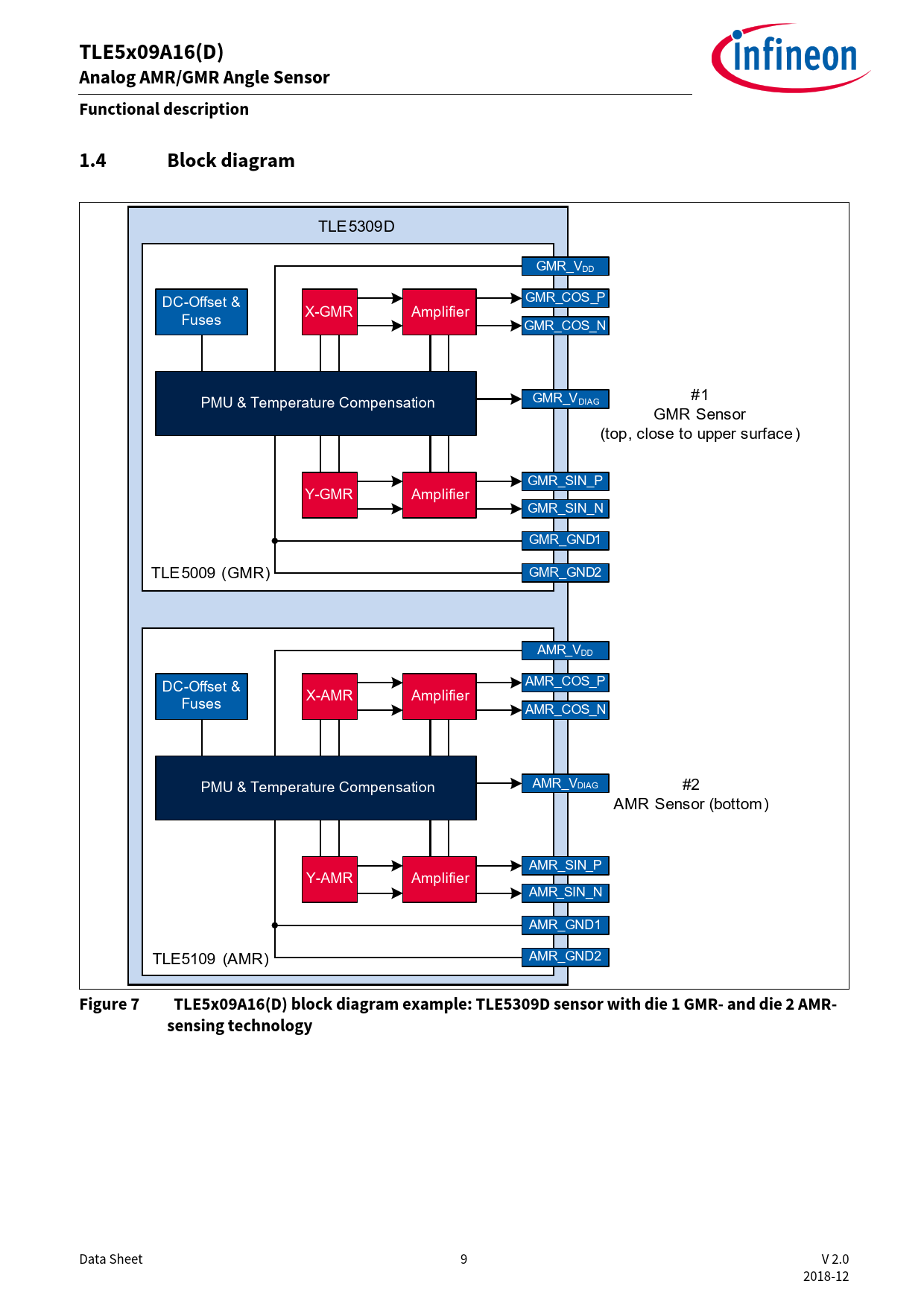

TLE5x09A16(D) Analog AMR/GMR Angle Sensor. Functional description. 1.4. Block diagram. Figure 7
TLE5x09A16(D) Analog AMR/GMR Angle Sensor Functional description 1.4 Block diagram Figure 7
TLE5309D GMR_VDD DC-Offset & GMR_COS_P X-GMR Amplifier Fuses GMR_COS_N GMR_V #1 DIAG PMU & Temperature Compensation GMR Sensor (top, close to upper surface ) GMR_SIN_P Y-GMR Amplifier GMR_SIN_N GMR_GND1 TLE5009 (GMR) GMR_GND2 AMR_VDD DC-Offset & AMR_COS_P X-AMR Amplifier Fuses AMR_COS_N AMR_VDIAG PMU & Temperature Compensation #2 AMR Sensor (bottom) AMR_SIN_P Y-AMR Amplifier AMR_SIN_N AMR_GND1 AMR_GND2 TLE5109 (AMR)
Figure 7 TLE5x09A16(D) block diagram example: TLE5309D sensor with die 1 GMR- and die 2 AMR- sensing technology
