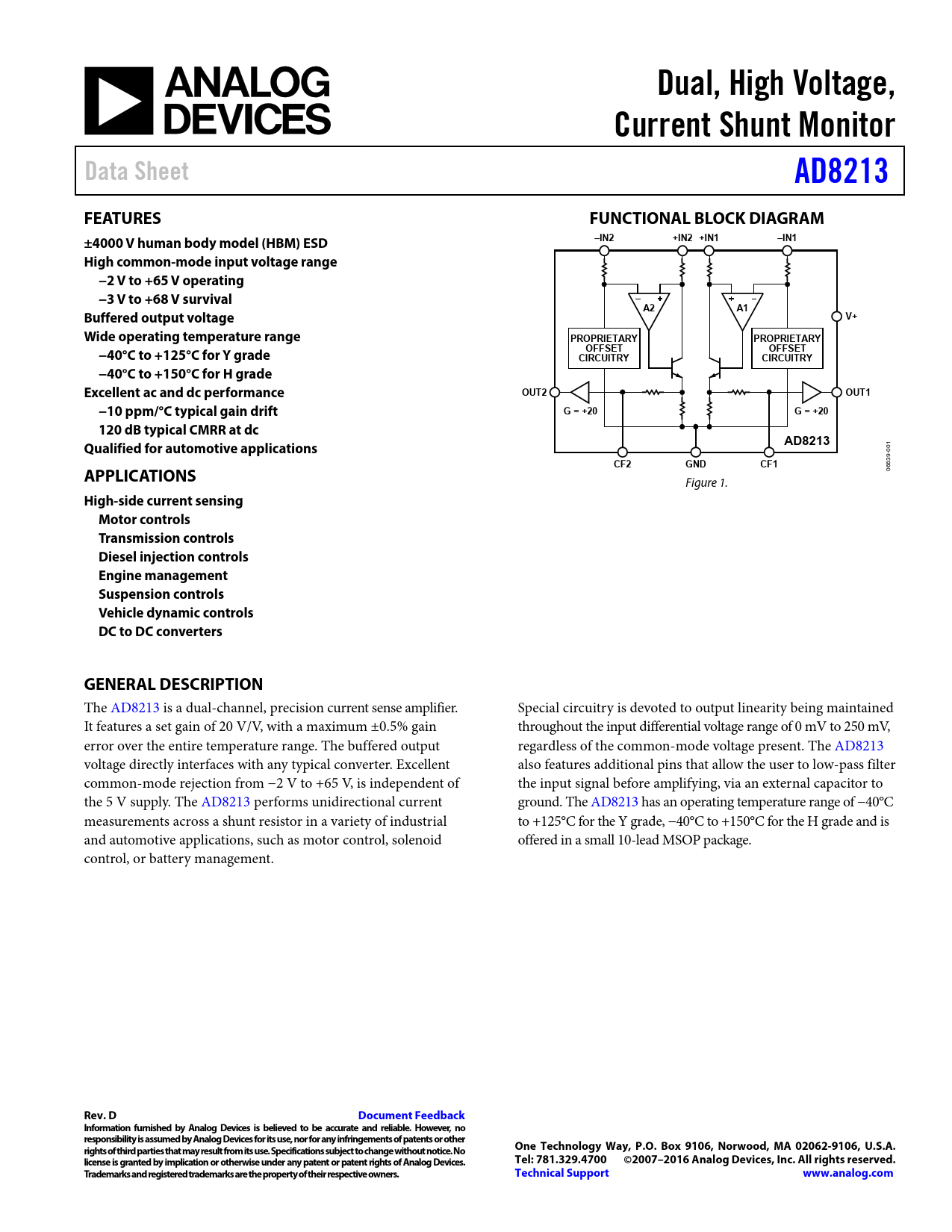

Dual, High Voltage,. Current Shunt Monitor. Data Sheet. AD8213. FEATURES. FUNCTIONAL BLOCK DIAGRAM. –IN2. +IN2 +IN1. –IN1
Datasheet AD8213 Analog Devices, Revision: D
Dual, High Voltage, Current Shunt Monitor Data Sheet AD8213 FEATURES FUNCTIONAL BLOCK DIAGRAM –IN2 +IN2 +IN1 –IN1 ±4000 V human body model (HBM) ESD High common-mode input voltage range −2 V to +65 V operating −3 V to +68 V survival A2 A1 Buffered output voltage V+ Wide operating temperature range PROPRIETARY PROPRIETARY OFFSET OFFSET −40°C to +125°C for Y grade CIRCUITRY CIRCUITRY −40°C to +150°C for H grade Excellent ac and dc performance OUT2 OUT1 −10 ppm/°C typical gain drift G = +20 G = +20 120 dB typical CMRR at dc AD8213 Qualified for automotive applications
01 0 9-
CF2 GND CF1
0663
APPLICATIONS
Figure 1.
High-side current sensing Motor controls Transmission controls Diesel injection controls Engine management Suspension controls Vehicle dynamic controls DC to DC converters GENERAL DESCRIPTION
The AD8213 is a dual-channel, precision current sense amplifier. Special circuitry is devoted to output linearity being maintained It features a set gain of 20 V/V, with a maximum ±0.5% gain throughout the input differential voltage range of 0 mV to 250 mV, error over the entire temperature range. The buffered output regardless of the common-mode voltage present. The AD8213 voltage directly interfaces with any typical converter. Excellent also features additional pins that allow the user to low-pass filter common-mode rejection from −2 V to +65 V, is independent of the input signal before amplifying, via an external capacitor to the 5 V supply. The AD8213 performs unidirectional current ground. The AD8213 has an operating temperature range of −40°C measurements across a shunt resistor in a variety of industrial to +125°C for the Y grade, −40°C to +150°C for the H grade and is and automotive applications, such as motor control, solenoid offered in a small 10-lead MSOP package. control, or battery management.
