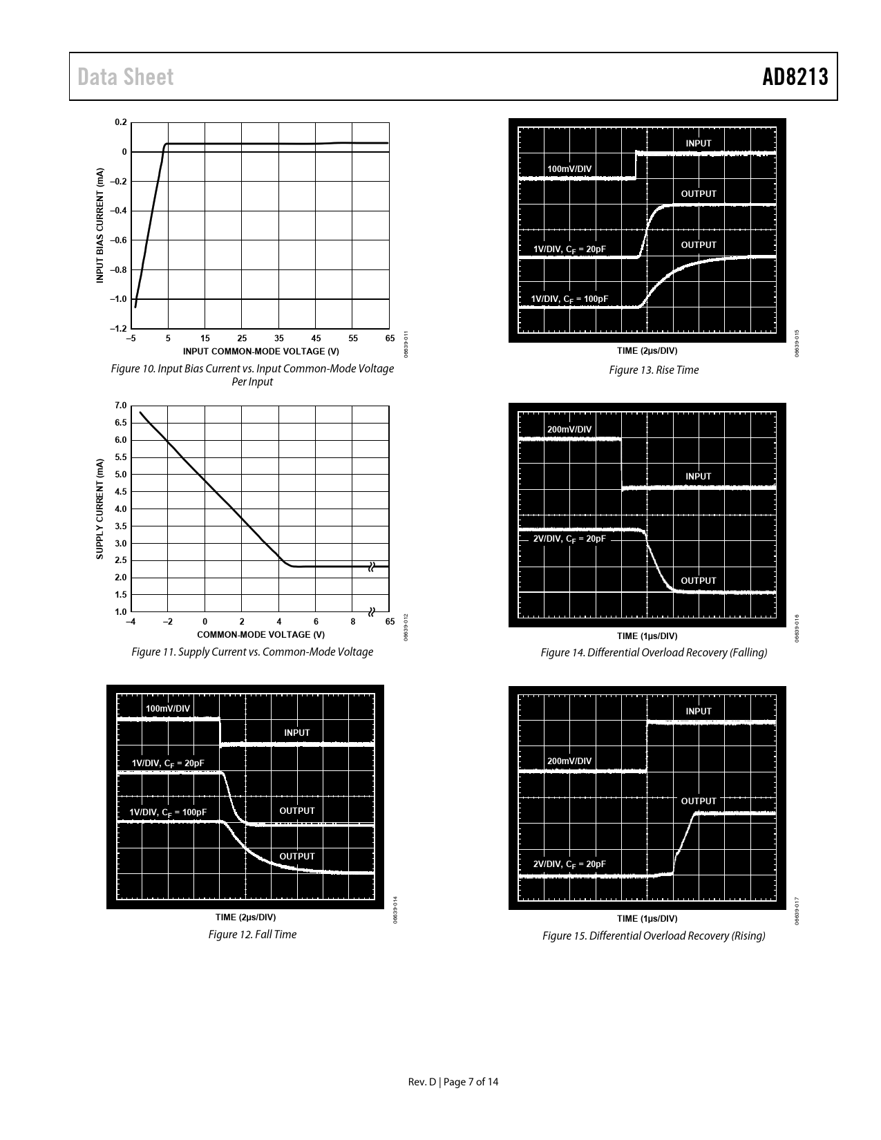

Data Sheet. AD8213. 0.2. INPUT. 100mV/DIV. A) m –0.2. ( NT. OUTPUT. –0.4. URRE C –0.6. 1V/DIV, C. F = 20pF. UT –0.8 INP. –1.0. 1V/DIV, CF = 100pF
Data Sheet AD8213 0.2 INPUT 100mV/DIV A) m –0.2 ( NT OUTPUT –0.4 URRE C –0.6 1V/DIV, C F = 20pF UT –0.8 INP –1.0 1V/DIV, CF = 100pF
Data Sheet AD8213 0.2 INPUT 0 100mV/DIV A) m –0.2 ( NT OUTPUT –0.4 URRE C –0.6 AS 1V/DIV, C OUTPUT BI F = 20pF UT –0.8 INP –1.0 1V/DIV, CF = 100pF –1.2–5 5 15 25 35 45 55 65

663 06 0 Figure 10. Input Bias Current vs. Input Common-Mode Voltage Figure 13. Rise Time Per Input

06 663 0 Figure 11. Supply Current vs. Common-Mode Voltage Figure 14. Differential Overload Recovery (Falling)

0 663 0 Figure 12. Fall Time Figure 15. Differential Overload Recovery (Rising) Rev. D | Page 7 of 14 Document Outline FEATURES APPLICATIONS FUNCTIONAL BLOCK DIAGRAM GENERAL DESCRIPTION TABLE OF CONTENTS REVISION HISTORY SPECIFICATIONS ABSOLUTE MAXIMUM RATINGS ESD CAUTION PIN CONFIGURATION AND FUNCTION DESCRIPTIONS TYPICAL PERFORMANCE CHARACTERISTICS THEORY OF OPERATION APPLICATION NOTES OUTPUT LINEARITY LOW-PASS FILTERING APPLICATIONS INFORMATION HIGH-SIDE CURRENT SENSE WITH A LOW-SIDE SWITCH HIGH-SIDE CURRENT SENSING LOW-SIDE CURRENT SENSING BIDIRECTIONAL CURRENT SENSING OUTLINE DIMENSIONS ORDERING GUIDE AUTOMOTIVE PRODUCTS
