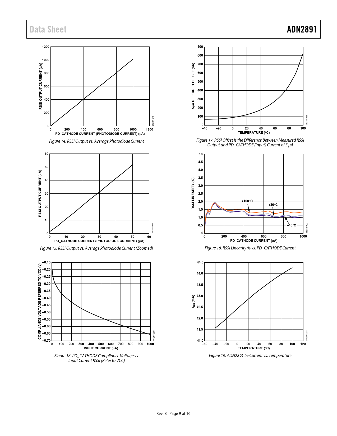

Data Sheet. ADN2891. 1200. 900. 800. 1000. 700. 600. 500. 400. 300. A REFERRED OFFSET (nA). RSSI OUTPUT CURRENT (. 200. 100. –40. –20
Data Sheet ADN2891 1200 900 800 1000 700 600 500 400 300 A REFERRED OFFSET (nA) RSSI OUTPUT CURRENT ( 200 100 –40 –20

Figure 14. RSSI Output vs. Average Photodiode Current Figure 17. RSSI Offset is the Difference Between Measured RSSI Output and PD_CATHODE (Input) Current of 5 µA

Figure 15. RSSI Output vs. Average Photodiode Current (Zoomed) Figure 18. RSSI Linearity % vs. PD_CATHODE Current

Figure 16. PD_CATHODE Compliance Voltage vs. Figure 19. ADN2891 ICC Current vs. Temperature Input Current RSSI (Refer to VCC) Rev. B | Page 9 of 16 Document Outline FEATURES APPLICATIONS GENERAL DESCRIPTION FUNCTIONAL BLOCK DIAGRAM SPECIFICATIONS ABSOLUTE MAXIMUM RATINGS THERMAL RESISTANCE ESD CAUTION PIN CONFIGURATION AND FUNCTION DESCRIPTIONS TYPICAL PERFORMANCE CHARACTERISTICS THEORY OF OPERATION LIMITING AMPLIFIER Input Buffer CML Output Buffer LOSS OF SIGNAL (LOS) DETECTOR RECEIVED SIGNAL STRENGTH INDICATOR (RSSI) SQUELCH MODE APPLICATIONS PCB DESIGN GUIDELINES Output Buffer Power Supply and Ground Planes PCB Layout Soldering Guidelines for the LFCSP OUTLINE DIMENSIONS ORDERING GUIDE
