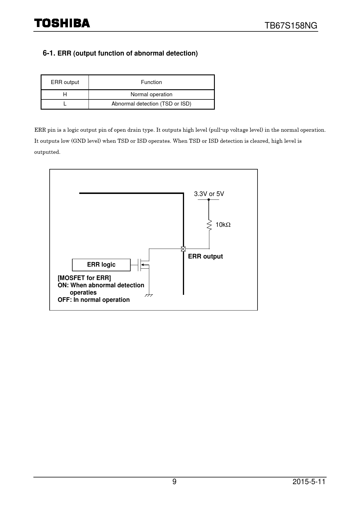

6-1. ERR (output function of abnormal detection). ERR output. ERR logic. [MOSFET for ERR]. ON: When abnormal detection. operaties
6-1 ERR (output function of abnormal detection) ERR output ERR logic [MOSFET for ERR] ON: When abnormal detection operaties
TB67S158NG
ERR output Function H Normal operation L Abnormal detection (TSD or ISD) ERR pin is a logic output pin of open drain type. It outputs high level (pull-up voltage level) in the normal operation. It outputs low (GND level) when TSD or ISD operates. When TSD or ISD detection is cleared, high level is outputted. 3.3V or 5V 10kΩ
ERR output ERR logic [MOSFET for ERR] ON: When abnormal detection operaties OFF: In normal operation
