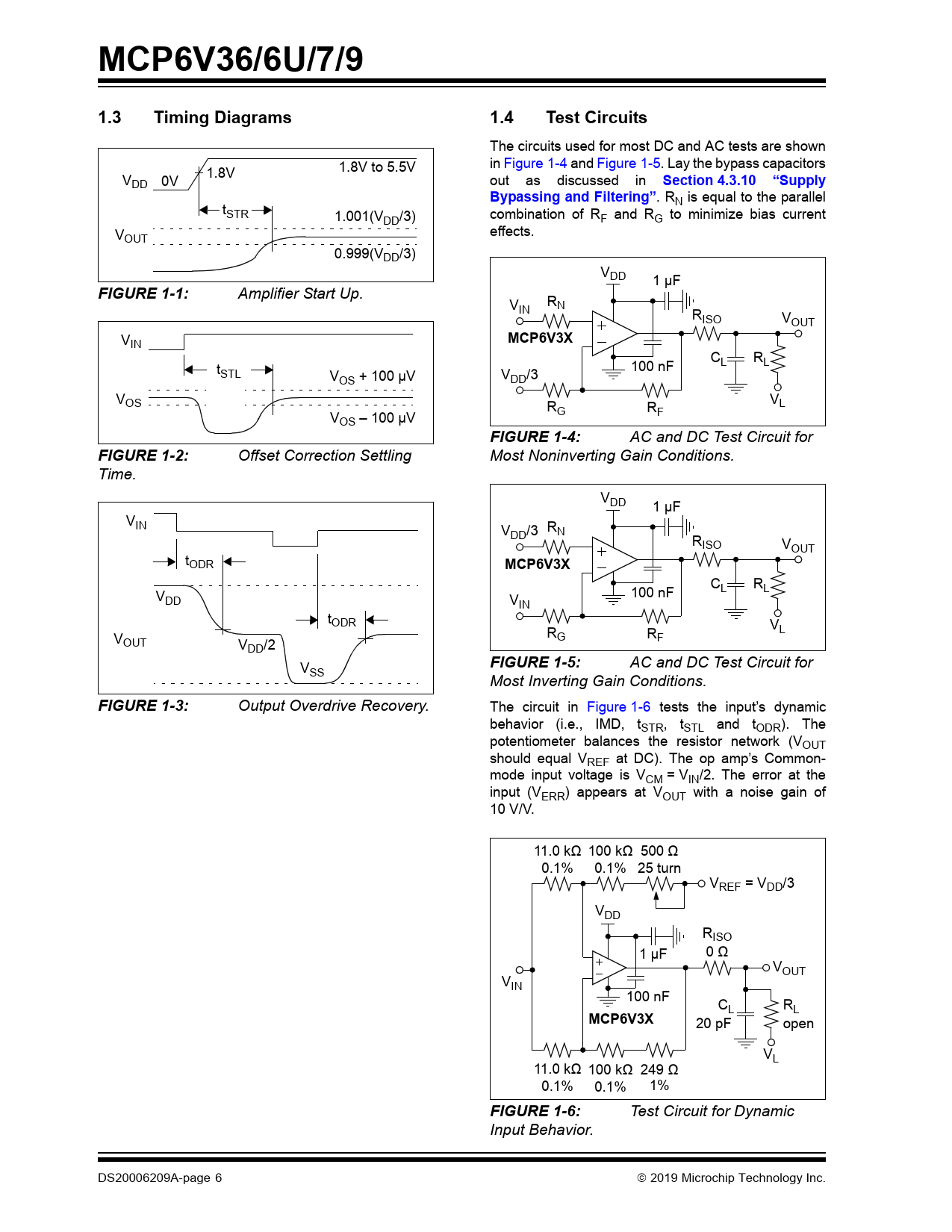

MCP6V36/6U/7/9 1.3 Timing Diagrams 1.4 Test Circuits
The circuits used for most DC and AC tests are shown in Figure 1-4 and Figure 1-5. Lay the bypass capacitors 1.8V to 5.5V V 1.8V 0V out as discussed in
Section 4.3.10 “Supply
DD
Bypassing and Filtering”
. RN is equal to the parallel tSTR 1.001(V combination of R DD/3) F and RG to minimize bias current effects. VOUT 0.999(VDD/3) VDD 1 µF
FIGURE 1-1:
Amplifier Start Up. R V N IN RISO VOUT V
MCP6V3X
IN C t L RL 100 nF STL VOS + 100 µV VDD/3 VOS R VL V G RF OS – 100 µV
FIGURE 1-4:
AC and DC Test Circuit for
FIGURE 1-2:
Offset Correction Settling Most Noninverting Gain Conditions. Time. VDD 1 µF VIN R V N DD/3 RISO VOUT tODR
MCP6V3X
CL RL V 100 nF DD VIN tODR VL V R OUT V G RF DD/2
FIGURE 1-5:
AC and DC Test Circuit for VSS Most Inverting Gain Conditions.
FIGURE 1-3:
Output Overdrive Recovery. The circuit in Figure 1-6 tests the input’s dynamic behavior (i.e., IMD, tSTR, tSTL and tODR). The potentiometer balances the resistor network (VOUT should equal VREF at DC). The op amp’s Common- mode input voltage is VCM = VIN/2. The error at the input (VERR) appears at VOUT with a noise gain of 10 V/V. 11.0 kΩ 100 kΩ 500 Ω 0.1% 0.1% 25 turn VREF = VDD/3 VDD RISO 1 µF 0 Ω VOUT VIN 100 nF CL RL
MCP6V3X
20 pF open VL 11.0 kΩ 100 kΩ 249 Ω 0.1% 0.1% 1%
FIGURE 1-6:
