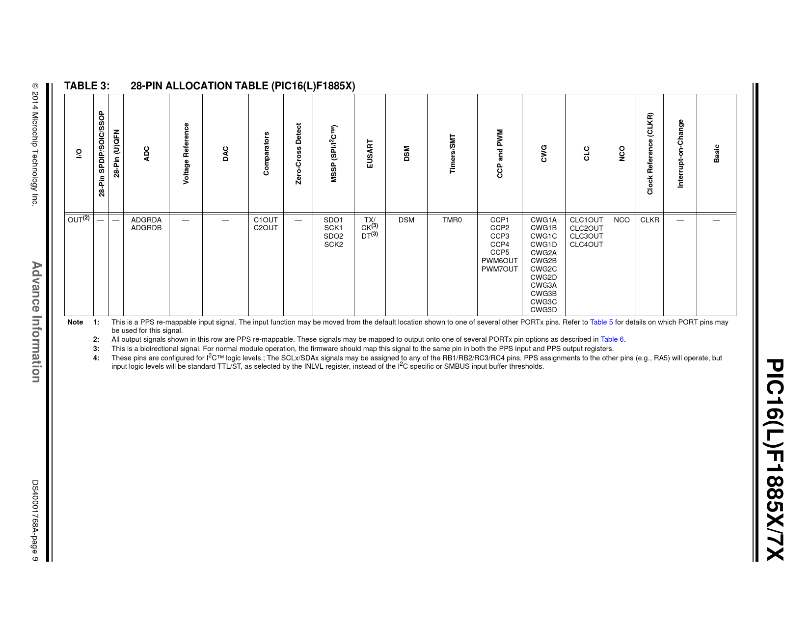

4: NCO Clock Reference (CLKR) Interrupt-on-Change Basic CCP1. CCP2. CCP3. CCP4. CCP5. PWM6OUT
4: NCO Clock Reference (CLKR) Interrupt-on-Change Basic CCP1 CCP2 CCP3 CCP4 CCP5 PWM6OUT
1:
2:
3:
CCP2
CCP3
CCP4
CCP5
PWM6OUT
PWM7OUT CLC TMR0 CCP and PWM DSM CWG TX/
CK(3)
DT(3) Timers/SMT SDO1
SCK1
SDO2
SCK2 EUSART — DSM C1OUT
C2OUT MSSP (SPI/I2C™) — Zero-Cross Detect — CWG1A
CWG1B
CWG1C
CWG1D
CWG2A
CWG2B
CWG2C
CWG2D
CWG3A
CWG3B
CWG3C
CWG3D CLC1OUT
CLC2OUT
CLC3OUT
CLC4OUT NCO CLKR — — This is a PPS re-mappable input signal. The input function may be moved from the default location shown to one of several other PORTx pins. Refer to Table 5 for details on which PORT pins may
be used for this signal.
All output signals shown in this row are PPS re-mappable. These signals may be mapped to output onto one of several PORTx pin options as described in Table 6.
This is a bidirectional signal. For normal module operation, the firmware should map this signal to the same pin in both the PPS input and PPS output registers.
These pins are configured for I2C™ logic levels.; The SCLx/SDAx signals may be assigned to any of the RB1/RB2/RC3/RC4 pins. PPS assignments to the other pins (e.g., RA5) will operate, but
input logic levels will be standard TTL/ST, as selected by the INLVL register, instead of the I2C specific or SMBUS input buffer thresholds. DS40001768A-page 9 PIC16(L)F1885X/7X Advance Information Note ADGRDA
ADGRDB Comparators — DAC — Voltage Reference 28-Pin (U)QFN OUT(2) ADC 28-Pin SPDIP/SOIC/SSOP 28-PIN ALLOCATION TABLE (PIC16(L)F1885X) I/O  2014 Microchip Technology Inc. TABLE 3:
