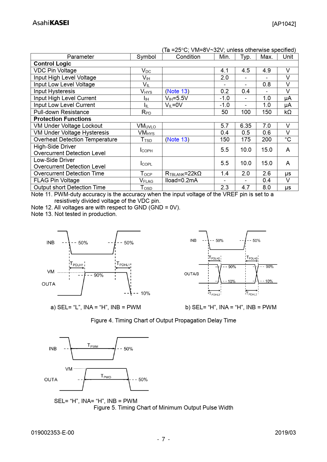

link to page 7 link to page 7 [AP1042] (Ta =25C; VM=8V~32V; unless otherwise specified) Parameter Symbol Condition Min. Typ. Max. Unit
Control Logic
VDC Pin Voltage VDC 4.1 4.5 4.9 V Input High Level Voltage VIH 2.0 - - V Input Low Level Voltage VIL - - 0.8 V Input Hysteresis VHYS (Note 13) 0.2 0.4 - V Input High Level Current IIH VIH=5.5V -1.0 - 1.0 μA Input Low Level Current IIL VIL=0V -1.0 - 1.0 μA Pull-down Resistance RPD 50 100 150 kΩ
Protection Functions
VM Under Voltage Lockout VMUVLO 5.7 6.35 7.0 V VM Under Voltage Hysteresis VMHYS 0.4 0.5 0.6 V Overheat Detection Temperature TTSD (Note 13) 150 175 200 °C High-Side Driver I 5.5 Overcurrent Detection Level 10.0 15.0 A COPH Low-Side Driver I 5.5 Overcurrent Detection Level 10.0 15.0 A COPL Overcurrent Detection Time TOCP RTBLANK=22kΩ 1.4 2.0 2.6 μs FLAG Pin Voltage VFLAG Iload=0.2mA - - 0.4 V Output short Detection Time TOSD 2.3 4.7 8.0 μs Note 11. PWM-duty accuracy is the accuracy when the input voltage of the VREF pin is set to a resistively divided voltage of the VDC pin. Note 12. All voltages are with respect to GND (GND = 0V). Note 13. Not tested in production. a) SEL= “L”, INA = “H”, INB = PWM b) SEL= “H”, INA = “H”, INB = PWM Figure 4. Timing Chart of Output Propagation Delay Time SEL= “H”, INA= “H”, INB = PWM Figure 5. Timing Chart of Minimum Output Pulse Width 019002353-E-00 2019/03 - 7 - Document Outline 1. General Description 2. Features 3. Table of Contents 4. Block Diagram 5. Pin Configulations and Functions 5.1. Pin Layout 5.2. Pin Functions 6. Absolute Maximum Ratings 7. Recommended Operation Conditions 8. Electric Characteristics 9. Functional Descriptions 9.1. Control Logic 9.2. PWM Duty Control 9.3. Protection Functions 10. Recommended External Circuit 11. Package 11.1. Outline Dimensions 11.2. Land Pattern 11.3. Marking 12. Ordering Guide 13. Revision History IMPORTANT NOTICE
