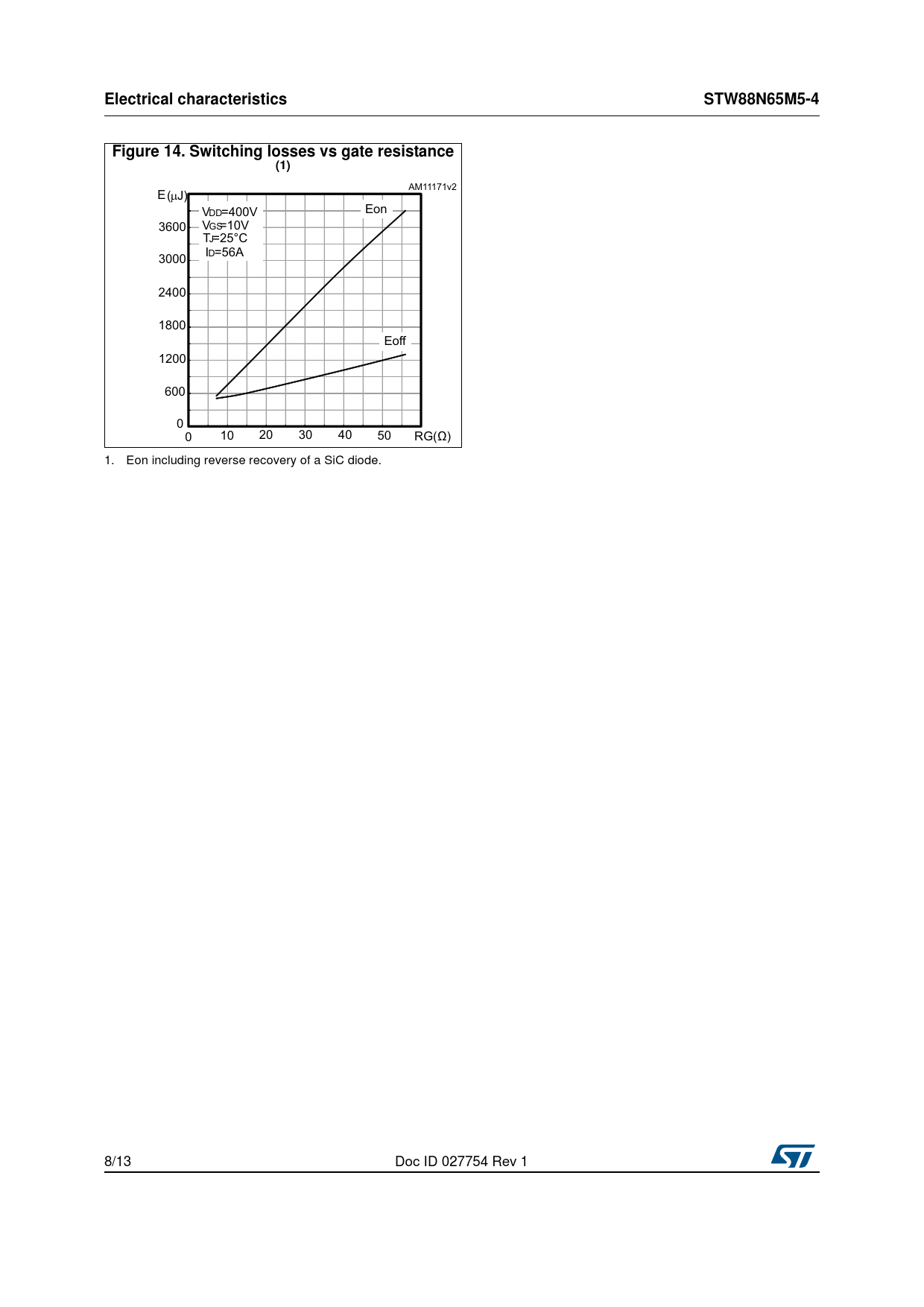

Electrical characteristics. STW88N65M5-4. Figure 14. Switching losses vs gate resistance. (1)
Electrical characteristics STW88N65M5-4 Figure 14 Switching losses vs gate resistance (1)
Electrical characteristics STW88N65M5-4 Figure 14. Switching losses vs gate resistance (1)
