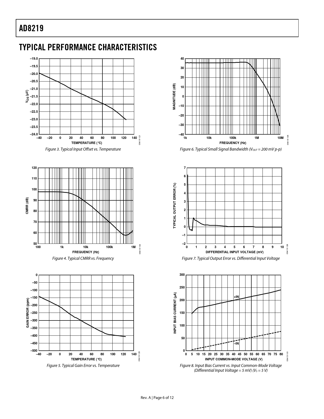

AD8219. TYPICAL PERFORMANCE CHARACTERISTICS. –19.0. –19.5. –20.0. –20.5. ) B d. –21.0. E D. (µ –21.5. ITU. V –22.0. GN A. –10. –22.5. –20. –23.0. –30
AD8219 TYPICAL PERFORMANCE CHARACTERISTICS –19.0 –19.5 –20.0 –20.5 ) B d –21.0 E D (µ –21.5 ITU V –22.0 GN A –10 –22.5 –20 –23.0 –30
AD8219 TYPICAL PERFORMANCE CHARACTERISTICS –19.0 40 –19.5 30 –20.0 20 –20.5 ) B d 10 –21.0 ) ( V E D (µ –21.5 0 OS ITU V –22.0 GN A –10 M –22.5 –20 –23.0 –30 –23.5 –24.0

41 09 09 Figure 3. Typical Input Offset vs. Temperature Figure 6. Typical Small Signal Bandwidth (VOUT = 200 mV p-p)

41 09 09 Figure 4. Typical CMRR vs. Frequency Figure 7. Typical Output Error vs. Differential Input Voltage

41 09 09 Figure 5. Typical Gain Error vs. Temperature Figure 8. Input Bias Current vs. Input Common-Mode Voltage (Differential Input Voltage = 5 mV) (VS = 5 V) Rev. A | Page 6 of 12 Document Outline FEATURES APPLICATIONS GENERAL DESCRIPTION FUNCTIONAL BLOCK DIAGRAM TABLE OF CONTENTS REVISION HISTORY SPECIFICATIONS ABSOLUTE MAXIMUM RATINGS ESD CAUTION PIN CONFIGURATION AND FUNCTION DESCRIPTIONS TYPICAL PERFORMANCE CHARACTERISTICS THEORY OF OPERATION AMPLIFIER CORE SUPPLY CONNECTIONS OUTPUT CLAMPING OUTPUT LINEARITY APPLICATIONS INFORMATION HIGH-SIDE CURRENT SENSING MOTOR CONTROL CURRENT SENSING OUTLINE DIMENSIONS ORDERING GUIDE
