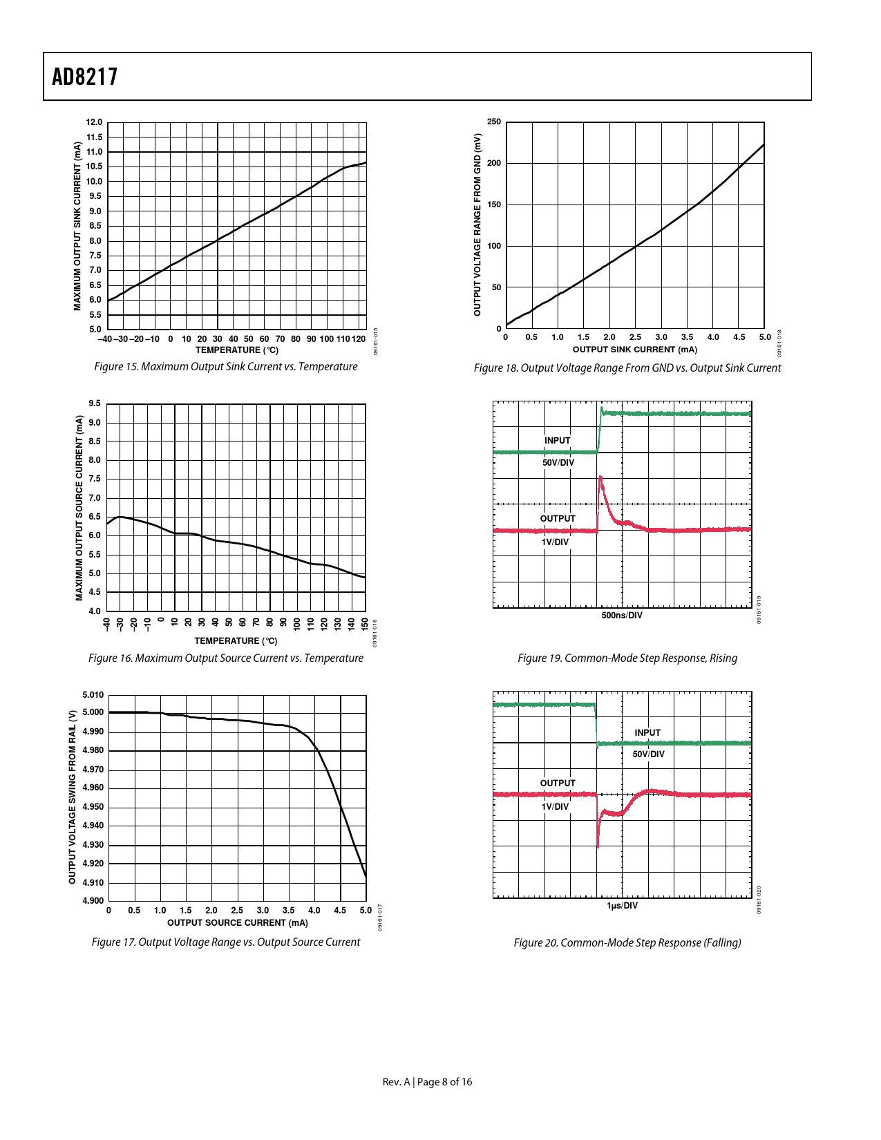

AD8217. 12.0. 250. 11.5. ) V. 11.0. (m 10.5. ND ( 200. 10.0. 9.5. RO F 150. 9.0. INK CURRE. 8.5. S UT. 8.0. E 100. 7.5. AG T. 7.0. 6.5. U P. 6.0. 5.5. 5.0
AD8217 12.0 250 11.5 ) V 11.0 (m 10.5 ND ( 200 10.0 9.5 RO F 150 9.0 INK CURRE 8.5 S UT 8.0 E 100 7.5 AG T 7.0 6.5 U P 6.0 5.5 5.0
AD8217 12.0 250 11.5 ) V A) m 11.0 (m 10.5 ND ( 200 NT G 10.0 M 9.5 RO F 150 9.0 E INK CURRE NG 8.5 S UT RA 8.0 P E 100 UT 7.5 AG T O L 7.0 O UM V 6.5 T IM 50 U P AX 6.0 T M 5.5 OU 5.0

16 09 09 Figure 15. Maximum Output Sink Current vs. Temperature Figure 18. Output Voltage Range From GND vs. Output Sink Current

16 09 Figure 16. Maximum Output Source Current vs. Temperature Figure 19. Common-Mode Step Response, Rising

161 09 Figure 17. Output Voltage Range vs. Output Source Current Figure 20. Common-Mode Step Response (Falling) Rev. A | Page 8 of 16 Document Outline FEATURES APPLICATIONS FUNCTIONAL BLOCK DIAGRAM GENERAL DESCRIPTION TABLE OF CONTENTS REVISION HISTORY SPECIFICATIONS ABSOLUTE MAXIMUM RATINGS ESD CAUTION PIN CONFIGURATION AND FUNCTION DESCRIPTIONS TYPICAL PERFORMANCE CHARACTERISTICS THEORY OF OPERATION AMPLIFIER CORE INTERNAL LDO APPLICATION NOTES OUTPUT LINEARITY APPLICATIONS INFORMATION HIGH-SIDE CURRENT SENSING MOTOR CONTROL CURRENT SENSING OUTLINE DIMENSIONS ORDERING GUIDE
