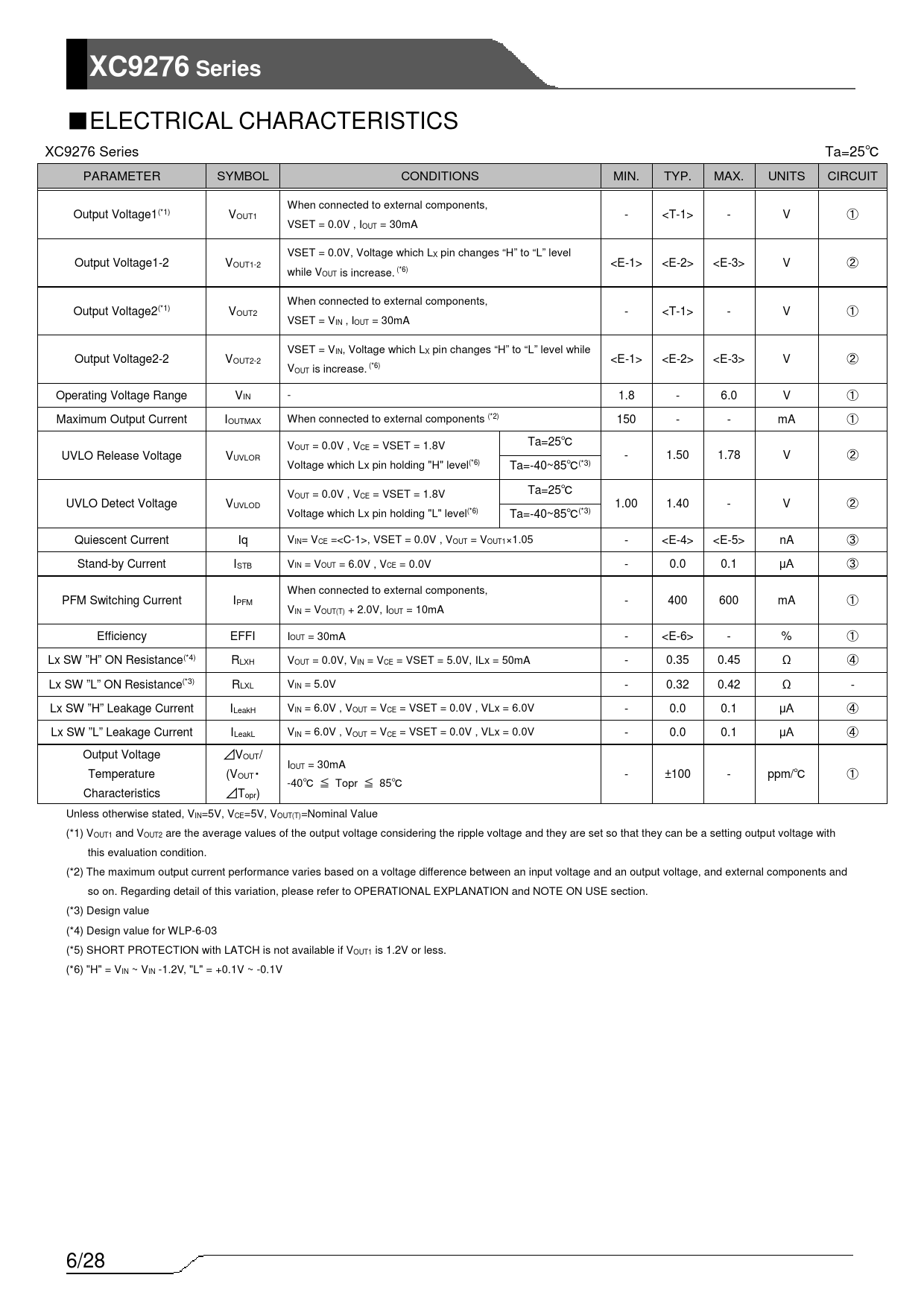

■ELECTRICAL CHARACTERISTICS XC9276 Series Ta=25℃ PARAMETER SYMBOL CONDITIONS MIN. TYP. MAX. UNITS CIRCUIT When connected to external components, Output Voltage1(*1) VOUT1 - <T-1> - V ① VSET = 0.0V , IOUT = 30mA VSET = 0.0V, Voltage which LX pin changes “H” to “L” level Output Voltage1-2 VOUT1-2 <E-1> <E-2> <E-3> V ② while VOUT is increase. (*6) When connected to external components, Output Voltage2(*1) VOUT2 - <T-1> - V ① VSET = VIN , IOUT = 30mA VSET = VIN, Voltage which LX pin changes “H” to “L” level while Output Voltage2-2 VOUT2-2 <E-1> <E-2> <E-3> V ② VOUT is increase. (*6) Operating Voltage Range VIN - 1.8 - 6.0 V ① Maximum Output Current IOUTMAX When connected to external components (*2) 150 - - mA ① V Ta=25℃ OUT = 0.0V , VCE = VSET = 1.8V UVLO Release Voltage VUVLOR - 1.50 1.78 V ② Voltage which Lx pin holding "H" level(*6) Ta=-40~85℃(*3) V Ta=25℃ OUT = 0.0V , VCE = VSET = 1.8V UVLO Detect Voltage VUVLOD 1.00 1.40 - V ② Voltage which Lx pin holding "L" level(*6) Ta=-40~85℃(*3) Quiescent Current Iq VIN= VCE =<C-1>, VSET = 0.0V , VOUT = VOUT1×1.05 - <E-4> <E-5> nA ③ Stand-by Current ISTB VIN = VOUT = 6.0V , VCE = 0.0V - 0.0 0.1 μA ③ When connected to external components, PFM Switching Current IPFM - 400 600 mA ① VIN = VOUT(T) + 2.0V, IOUT = 10mA Efficiency EFFI IOUT = 30mA - <E-6> - % ① Lx SW ”H” ON Resistance(*4) RLXH VOUT = 0.0V, VIN = VCE = VSET = 5.0V, ILx = 50mA - 0.35 0.45 Ω ④ Lx SW ”L” ON Resistance(*3) RLXL VIN = 5.0V - 0.32 0.42 Ω - Lx SW ”H” Leakage Current ILeakH VIN = 6.0V , VOUT = VCE = VSET = 0.0V , VLx = 6.0V - 0.0 0.1 μA ④ Lx SW ”L” Leakage Current ILeakL VIN = 6.0V , VOUT = VCE = VSET = 0.0V , VLx = 0.0V - 0.0 0.1 μA ④ Output Voltage ⊿VOUT/ IOUT = 30mA Temperature (VOUT・ - ±100 - ppm/℃ ① -40℃ ≦ Topr ≦ 85℃ Characteristics ⊿Topr) Unless otherwise stated, VIN=5V, VCE=5V, VOUT(T)=Nominal Value (*1) VOUT1 and VOUT2 are the average values of the output voltage considering the ripple voltage and they are set so that they can be a setting output voltage with this evaluation condition. (*2) The maximum output current performance varies based on a voltage difference between an input voltage and an output voltage, and external components and so on. Regarding detail of this variation, please refer to OPERATIONAL EXPLANATION and NOTE ON USE section. (*3) Design value (*4) Design value for WLP-6-03 (*5) SHORT PROTECTION with LATCH is not available if VOUT1 is 1.2V or less. (*6) "H" = VIN ~ VIN -1.2V, "L" = +0.1V ~ -0.1V 6/28 Document Outline GRM188R61A106ME69 LMK107BBJ106MALT GRM188R61A106ME69 GRM188R60J226MEA0 GRM188R61A226ME15 GRM188R60J476ME15 LMK107BBJ106MALT JMK107BBJ226MA C1608X5R0J226M080AC
