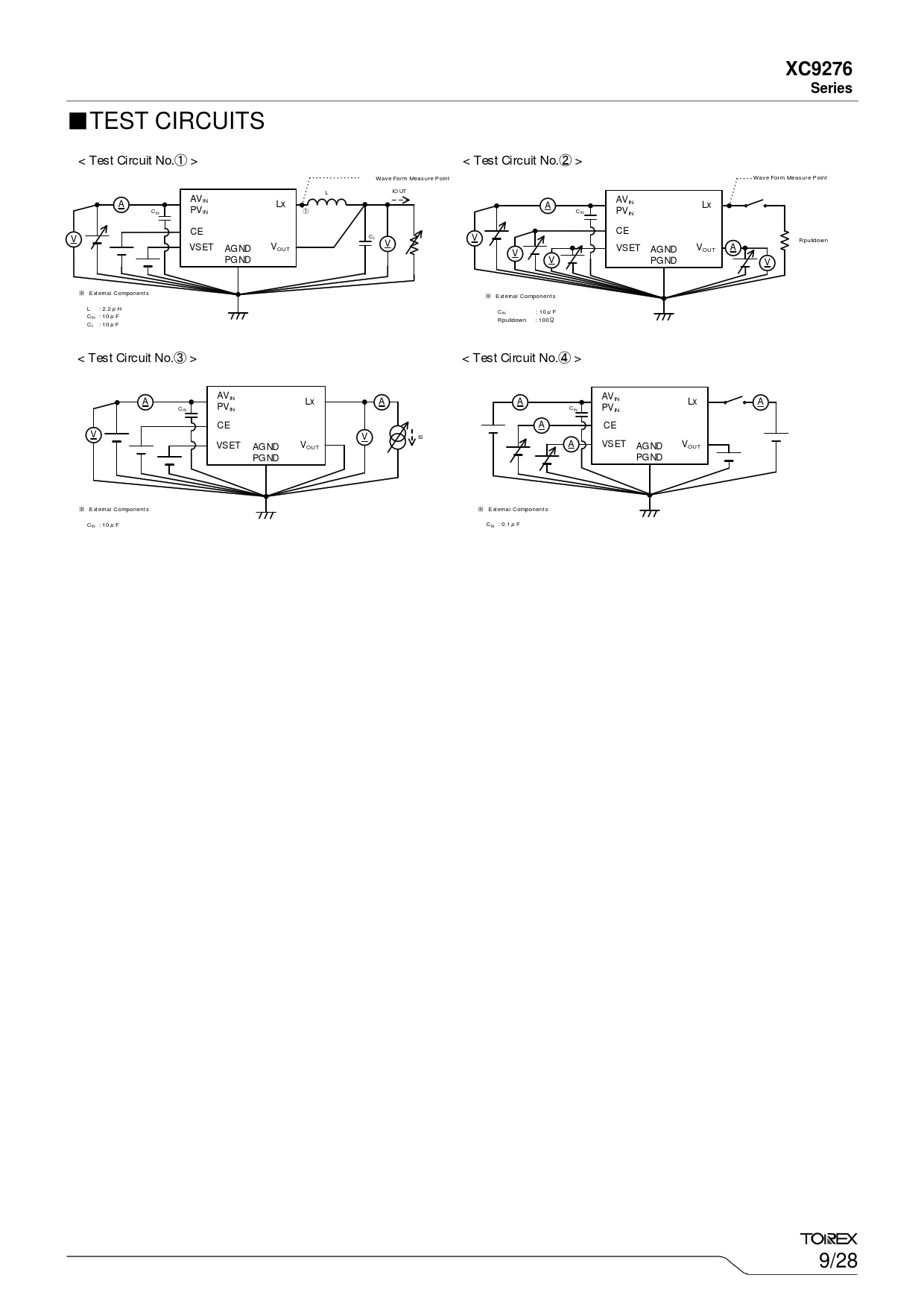

■TEST CIRCUITS < Test Circuit No.① > < Test Circuit No.② > Wav e Form Meas ure P oint Wav e Form Meas ure P oint IO UT L AVIN AV A Lx IN A Lx C ① CIN PV IN PVIN IN CE CE CL V V V Rpulldown VSET AG ND VOUT VSET AG ND VOUT A V PG ND V PG ND V ※ E xt ernal Component s ※ E xt ernal Component s    L : 2.2μH     C     IN           : 10μ F CIN : 10μF     Rpulldown : 100Ω    CL : 10μF     < Test Circuit No.③ > < Test Circuit No.④ > AVIN AV A Lx IN A A Lx A C CIN PV IN PVIN IN CE A CE V V IS VSET AG ND V A OUT VSET AG ND VOUT PG ND PG ND ※ E xt ernal Component s ※ E xt ernal Component s    C    C IN : 10μ F IN : 0.1μ F 9/28 Document Outline GRM188R61A106ME69 LMK107BBJ106MALT GRM188R61A106ME69 GRM188R60J226MEA0 GRM188R61A226ME15 GRM188R60J476ME15 LMK107BBJ106MALT JMK107BBJ226MA C1608X5R0J226M080AC
