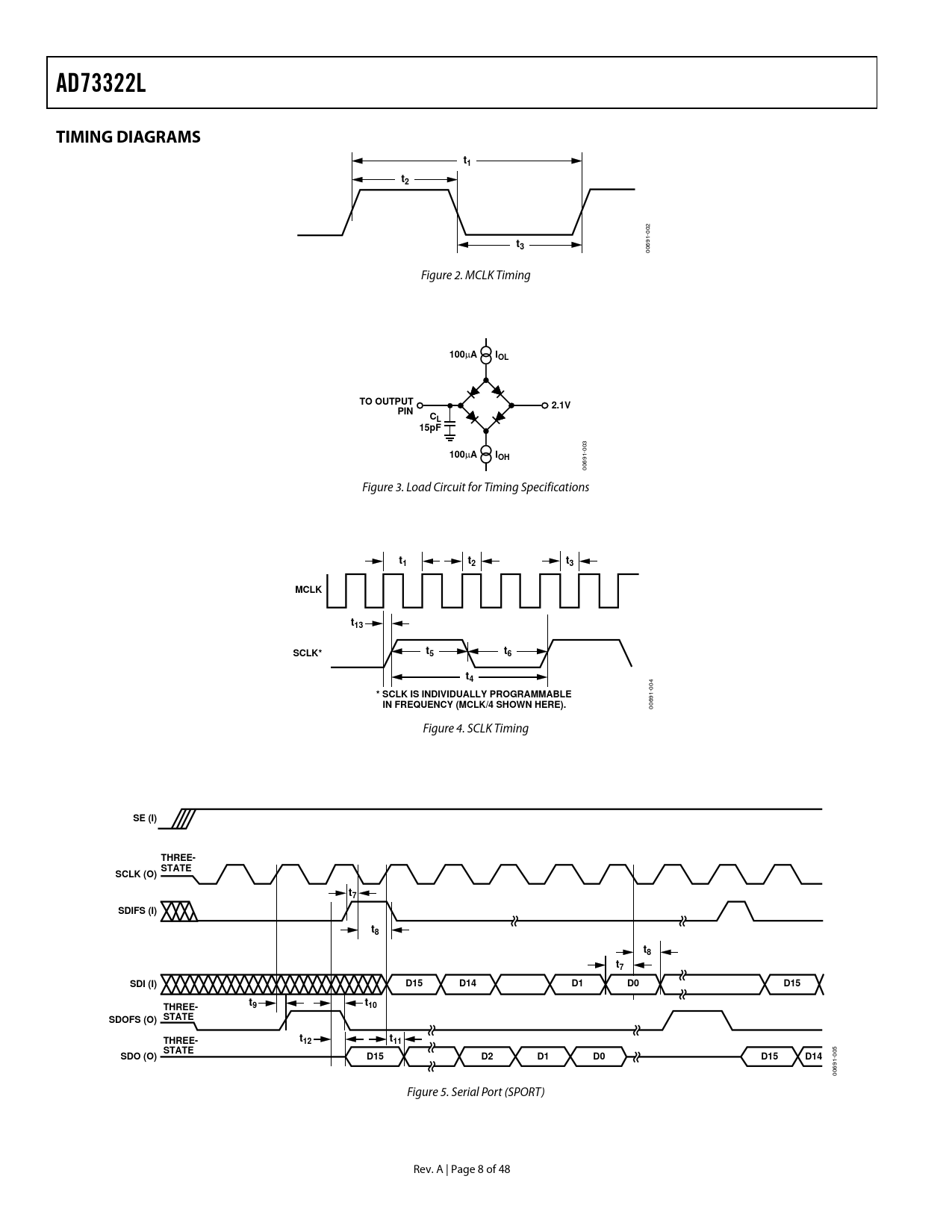

AD73322L. TIMING DIAGRAMS. 100. IOL. TO OUTPUT. 2.1V. PIN. 15pF. IOH. MCLK. t13. SCLK*. * SCLK IS INDIVIDUALLY PROGRAMMABLE
AD73322L TIMING DIAGRAMS 100 IOL TO OUTPUT 2.1V PIN 15pF IOH MCLK t13 SCLK* * SCLK IS INDIVIDUALLY PROGRAMMABLE
AD73322L TIMING DIAGRAMS t1 t2 t3
00691-002 Figure 2. MCLK Timing
100
µ
A IOL TO OUTPUT 2.1V PIN CL 15pF 100
µ
A IOH
00691-003 Figure 3. Load Circuit for Timing Specifications
t1 t2 t3 MCLK t13 SCLK* t5 t6 t4 * SCLK IS INDIVIDUALLY PROGRAMMABLE IN FREQUENCY (MCLK/4 SHOWN HERE).
00691-004 Figure 4. SCLK Timing
SE (I) THREE- STATE SCLK (O) t7 SDIFS (I) t8 t8 t7 SDI (I) D15 D14 D1 D0 D15 t t THREE- 9 10 SDOFS (O) STATE THREE- t12 t11 STATE SDO (O) D15 D2 D1 D0 D15 D14
