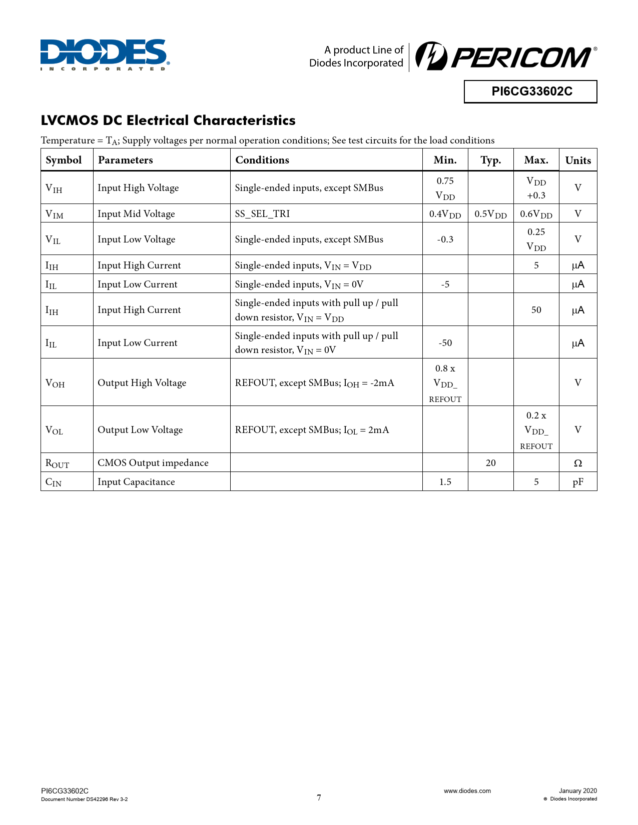

PI6CG33801C LVCMOS DC Electrical Characteristics
Temperature = TA; Supply voltages per normal operation conditions; See test circuits for the load conditions
Symbol Parameters Conditions Min. Typ. Max. Units
0.75 V V DD IH Input High Voltage Single-ended inputs, except SMBus V VDD +0.3 VIM Input Mid Voltage SS_SEL_TRI 0.4VDD 0.5VDD 0.6VDD V 0.25 VIL Input Low Voltage Single-ended inputs, except SMBus -0.3 V VDD IIH Input High Current Single-ended inputs, VIN = VDD 5 mA IIL Input Low Current Single-ended inputs, VIN = 0V -5 mA Single-ended inputs with pull up / pull IIH Input High Current 50 mA down resistor, VIN = VDD Single-ended inputs with pull up / pull IIL Input Low Current -50 mA down resistor, VIN = 0V 0.8 x VOH Output High Voltage REFOUT, except SMBus; IOH = -2mA VDD_ V REFOUT 0.2 x VOL Output Low Voltage REFOUT, except SMBus; IOL = 2mA VDD_ V REFOUT ROUT CMOS Output impedance 20 W CIN Input Capacitance 1.5 5 pF PI6CG33801C www.diodes.com January 2020 Document Number DS42297 Rev 3-2 7 Diodes Incorporated
