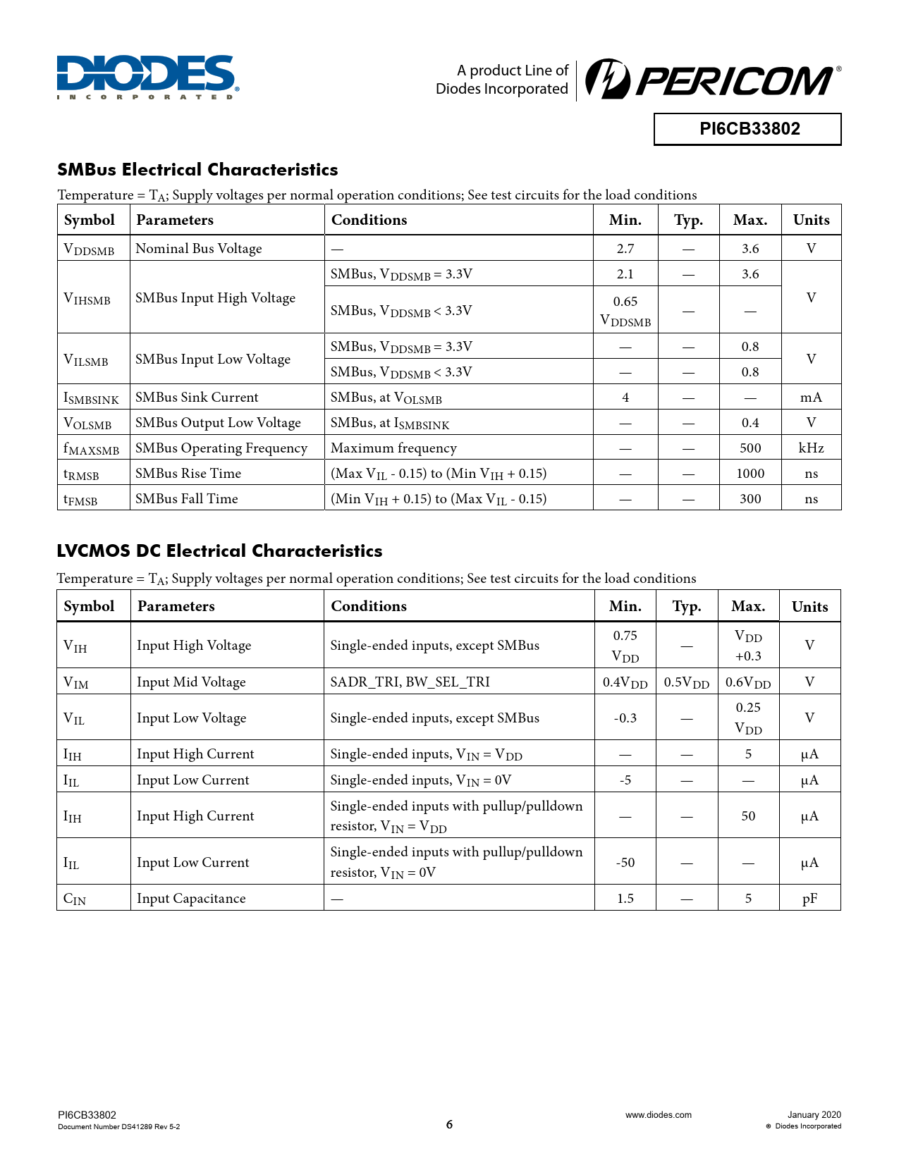

PI6CB33802 SMBus Electrical Characteristics
Temperature = TA; Supply voltages per normal operation conditions; See test circuits for the load conditions
Symbol Parameters Conditions Min. Typ. Max. Units
VDDSMB Nominal Bus Voltage — 2.7 — 3.6 V SMBus, VDDSMB = 3.3V 2.1 — 3.6 VIHSMB SMBus Input High Voltage V SMBus, VDDSMB < 3.3V 0.65 V — — DDSMB SMBus, V V DDSMB = 3.3V — — 0.8 ILSMB SMBus Input Low Voltage V SMBus, VDDSMB < 3.3V — — 0.8 ISMBSINK SMBus Sink Current SMBus, at VOLSMB 4 — — mA VOLSMB SMBus Output Low Voltage SMBus, at ISMBSINK — — 0.4 V fMAXSMB SMBus Operating Frequency Maximum frequency — — 500 kHz tRMSB SMBus Rise Time (Max VIL - 0.15) to (Min VIH + 0.15) — — 1000 ns tFMSB SMBus Fall Time (Min VIH + 0.15) to (Max VIL - 0.15) — — 300 ns
LVCMOS DC Electrical Characteristics
0.75 V V DD IH Input High Voltage Single-ended inputs, except SMBus — V VDD +0.3 VIM Input Mid Voltage SADR_TRI, BW_SEL_TRI 0.4VDD 0.5VDD 0.6VDD V 0.25 VIL Input Low Voltage Single-ended inputs, except SMBus -0.3 — V VDD IIH Input High Current Single-ended inputs, VIN = VDD — — 5 µA IIL Input Low Current Single-ended inputs, VIN = 0V -5 — — µA Single-ended inputs with pullup/pulldown IIH Input High Current — — 50 µA resistor, VIN = VDD Single-ended inputs with pullup/pulldown IIL Input Low Current -50 — — µA resistor, VIN = 0V CIN Input Capacitance — 1.5 — 5 pF PI6CB33802 www.diodes.com January 2020 Document Number DS41289 Rev 5-2 6 Diodes Incorporated
