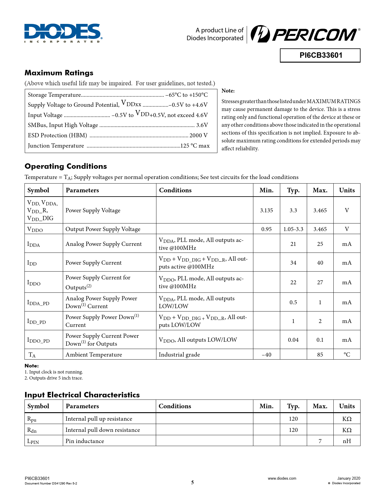

PI6CB33601. Maximum Ratings. Note:. Operating Conditions. Symbol. Parameters. Conditions. Min. Typ. Max. Units
PI6CB33601 Maximum Ratings Note: Operating Conditions Symbol Parameters Conditions Min Typ Max Units
A product Line of Diodes Incorporated
(Above which useful life may be impaired. For user guidelines, not tested.) Storage Temperature .. –65°C to +150°C
Note:
Supply Voltage to Ground Potential, VDDxx ..–0.5V to +4.6V Stresses greater than those listed under MAXIMUM RATINGS may cause permanent damage to the device. This is a stress Input Voltage ... –0.5V to VDD+0.5V, not exceed 4.6V rating only and functional operation of the device at these or SMBus, Input High Voltage .. 3.6V any other conditions above those indicated in the operational ESD Protection (HBM) ... 2000 V sections of this specification is not implied. Exposure to ab- solute maximum rating conditions for extended periods may Junction Temperature ..125 °C max affect reliability.
Temperature = TA; Supply voltages per normal operation conditions; See test circuits for the load conditions
Symbol Parameters Conditions Min. Typ. Max. Units
VDD, VDDA, VDD_R, Power Supply Voltage 3.135 3.3 3.465 V VDD_DIG VDDO Output Power Supply Voltage 0.95 1.05-3.3 3.465 V IDDA Analog Power Supply Current VDDA, PLL mode, All outputs ac- tive @100MHz 21 25 mA IDD Power Supply Current VDD + VDD_DIG + VDD_R, All out- puts active @100MHz 34 40 mA Power Supply Current for I VDDO, PLL mode, All outputs ac- DDO Outputs(2) tive @100MHz 22 27 mA I Analog Power Supply Power VDDA, PLL mode, All outputs DDA_PD Down(1) Current LOW/LOW 0.5 1 mA I Power Supply Power Down(1) VDD + VDD_DIG + VDD_R, All out- DD_PD Current puts LOW/LOW 1 2 mA I Power Supply Current Power DDO_PD Down(1) for Outputs VDDO, All outputs LOW/LOW 0.04 0.1 mA TA Ambient Temperature Industrial grade –40 85 °C
Note:
1. Input clock is not running. 2. Outputs drive 5 inch trace.
Input Electrical Characteristics Symbol Parameters Conditions Min. Typ. Max. Units
Rpu Internal pull up resistance 120 KW Rdn Internal pull down resistance 120 KW LPIN Pin inductance 7 nH PI6CB33601 www.diodes.com January 2020 Document Number DS41290 Rev 5-2 5 Diodes Incorporated
