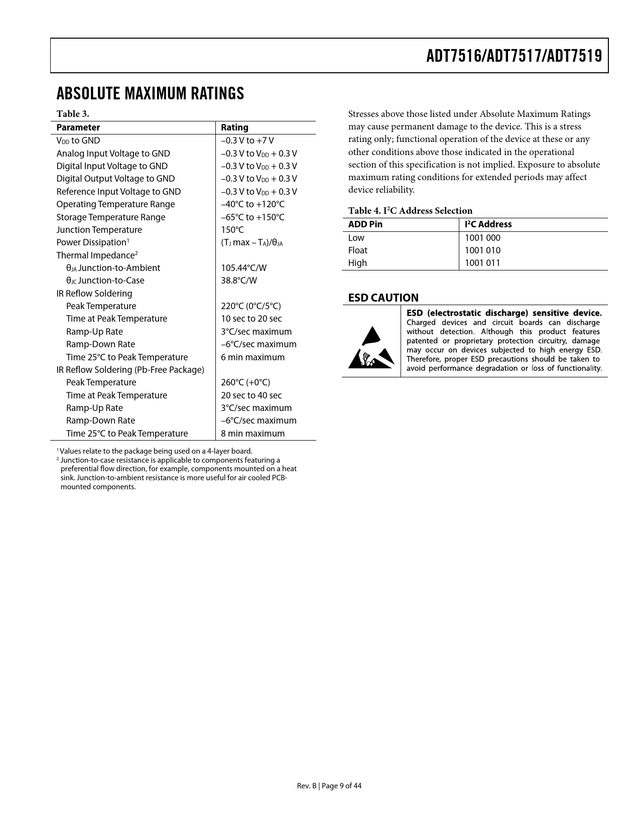

ADT7516/ADT7517/ADT7519 ABSOLUTE MAXIMUM RATINGS Table 3.
Stresses above those listed under Absolute Maximum Ratings
Parameter Rating
may cause permanent damage to the device. This is a stress VDD to GND –0.3 V to +7 V rating only; functional operation of the device at these or any Analog Input Voltage to GND –0.3 V to V other conditions above those indicated in the operational DD + 0.3 V Digital Input Voltage to GND –0.3 V to V section of this specification is not implied. Exposure to absolute DD + 0.3 V Digital Output Voltage to GND –0.3 V to V maximum rating conditions for extended periods may affect DD + 0.3 V Reference Input Voltage to GND –0.3 V to V device reliability. DD + 0.3 V Operating Temperature Range –40°C to +120°C
Table 4. I2C Address Selection
Storage Temperature Range –65°C to +150°C
ADD Pin I2C Address
Junction Temperature 150°C Low 1001 000 Power Dissipation1 (TJ max – TA)/θJA Float 1001 010 Thermal Impedance2 High 1001 011 θJA Junction-to-Ambient 105.44°C/W θJC Junction-to-Case 38.8°C/W IR Reflow Soldering
ESD CAUTION
Peak Temperature 220°C (0°C/5°C) Time at Peak Temperature 10 sec to 20 sec Ramp-Up Rate 3°C/sec maximum Ramp-Down Rate –6°C/sec maximum Time 25°C to Peak Temperature 6 min maximum IR Reflow Soldering (Pb-Free Package) Peak Temperature 260°C (+0°C) Time at Peak Temperature 20 sec to 40 sec Ramp-Up Rate 3°C/sec maximum Ramp-Down Rate –6°C/sec maximum Time 25°C to Peak Temperature 8 min maximum 1 Values relate to the package being used on a 4-layer board. 2 Junction-to-case resistance is applicable to components featuring a preferential flow direction, for example, components mounted on a heat sink. Junction-to-ambient resistance is more useful for air cooled PCB- mounted components. Rev. B | Page 9 of 44 Document Outline FEATURES APPLICATIONS PIN CONFIGURATION GENERAL DESCRIPTION TABLE OF CONTENTS REVISION HISTORY SPECIFICATIONS DAC AC CHARACTERISTICS TIMING DIAGRAMS FUNCTIONAL BLOCK DIAGRAM ABSOLUTE MAXIMUM RATINGS ESD CAUTION PIN CONFIGURATION AND FUNCTIONAL DESCRIPTIONS TYPICAL PERFORMANCE CHARACTERISTICS TERMINOLOGY THEORY OF OPERATION POWER-UP CALIBRATION CONVERSION SPEED FUNCTION DESCRIPTION—VOLTAGE OUTPUT Digital-to-Analog Converters Digital-to-Analog Section Resistor String DAC Reference Inputs Output Amplifier Thermal Voltage Output FUNCTIONAL DESCRIPTION—ANALOG INPUTS Single-Ended Inputs Converter Operation ADC TRANSFER FUNCTION Analog Input ESD Protection AIN Interrupts FUNCTIONAL DESCRIPTION—MEASUREMENT Temperature Sensor VDD Monitoring On-Chip Reference Round Robin Measurement Single Channel Measurement Temperature Measurement Method Layout Considerations Interrupts ADT7516/ADT7517/ADT7519 REGISTERS Interrupt Status 1 Register (Read-Only) [Address 0x00] Interrupt Status 2 Register (Read-Only) [Address = 0x01] Internal Temperature Value/VDD Value Register LSBs (Read-Only) [Address = 0x03] External Temperature Value and Analog Input 1 to Analog Input 4 Register LSBs (Read-Only) [Address = 0x04] VDD Value Register MSBs (Read-Only) [Address = 0x06] Internal Temperature Value Register MSBs (Read-Only) [Address = 0x07] External Temperature Value or Analog Input AIN1 Register MSBs (Read-Only) [Address = 0x08] AIN2 Register MSBs (Read) [Address = 0x09] AIN3 Register MSBs (Read) [Address = 0x0A] AIN4 Register MSBs (Read) [Address = 0x0B] DAC A Register LSBs (Read/Write) [Address = 0x10] DAC A Register MSBs (Read/Write) [Address = 0x11] DAC B Register LSBs (Read/Write) [Address = 0x12] DAC B Register MSBs (Read/Write) [Address = 0x13] DAC C Register LSBs (Read/Write) [Address = 0x14] DAC C Register MSBs (Read/Write) [Address = 0x15] DAC D Register LSBs (Read/Write) [Address = 0x16] DAC D Register MSBs (Read/Write) [Address = 0x17] Control Configuration 1 Register (Read/Write) [Address = 0x18] Control Configuration 2 Register (Read/Write) [Address = 0x19] Control Configuration 3 Register (Read/Write) [Address = 0x1A] DAC Configuration Register (Read/Write) [Address = 0x1B] LDAC Configuration Register (Write-Only)[Address = 0x1C] Interrupt Mask 1 Register (Read/Write) [Address = 0x1D] Interrupt Mask 2 Register (Read/Write) [Address = 0x1E] Internal Temperature Offset Register (Read/Write) [Address = 0x1F] External Temperature Offset Register (Read/Write) [Address = 0x20] Internal Analog Temperature Offset Register (Read/Write) [Address = 0x21] External Analog Temperature Offset Register (Read/Write) [Address = 0x22] VDD VHIGH Limit Register (Read/Write) [Address = 0x23] VDD VLOW Limit Register (Read/Write) [Address = 0x24] Internal THIGH Limit Register (Read/Write) [Address = 0x25] Internal TLOW Limit Register (Read/Write) [Address = 0x26] External THIGH/AIN1 VHIGH Limit Register (Read/Write) [Address = 0x27] External TLOW/AIN1 VLOW Limit Register (Read/Write) [Address = 0x28] AIN2 VHIGH Limit Register (Read/Write) [Address = 0x2B] AIN2 VLOW Limit Register (Read/Write) [Address = 0x2C] AIN3 VHIGH Limit Register (Read/Write) [Address = 0x2D] AIN3 VLOW Limit Register (Read/Write) [Address = 0x2E] AIN4 VHIGH Limit Register (Read/Write) [Address = 0x2F] AIN4 VLOW Limit Register (Read/Write) [Address = 0x30] Device ID Register (Read-Only) [Address = 0x4D] Manufacturer’s ID Register (Read-Only) [Address = 0x4E] Silicon Revision Register (Read-Only) [Address = 0x4F] SPI Lock Status Register (Read-Only) [Address = 0x7F] SERIAL INTERFACE Serial Interface Selection I2C Serial Interface Writing to the ADT7516/ADT7517/ADT7519 Writing to the Address Pointer Register for a Subsequent Read Writing Data to a Register Reading Data from the ADT7516/ADT7517/ADT7519 SPI Serial Interface Write Operation Read Operation SMBus/SPI INT/ SMBUS ALERT RESPONSE OUTLINE DIMENSIONS ORDERING GUIDE
