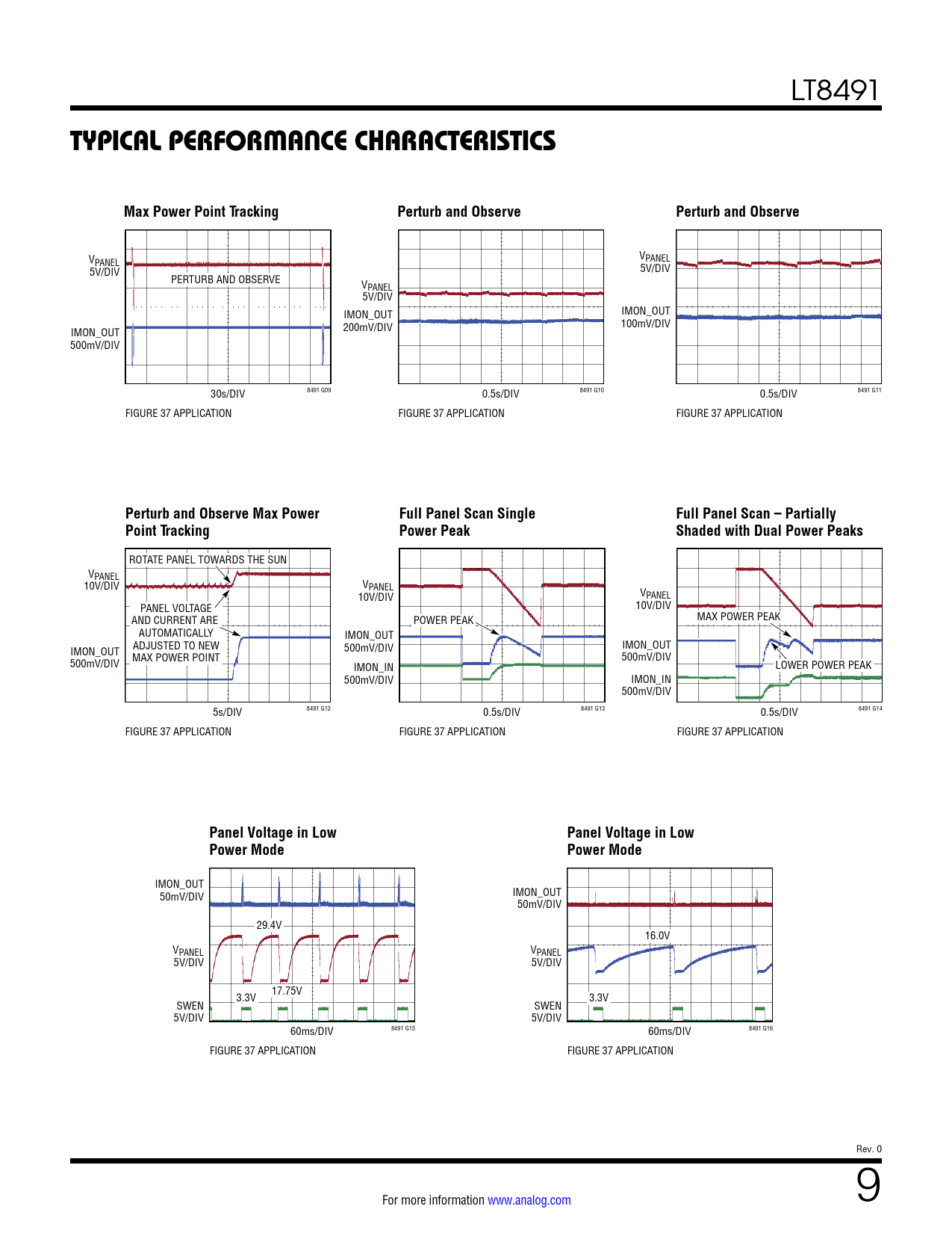

TYPICAL PERFORMANCE CHARACTERISTICS. Max Power Point Tracking. Perturb and Observe. Perturb and Observe Max Power
TYPICAL PERFORMANCE CHARACTERISTICS Max Power Point Tracking Perturb and Observe Perturb and Observe Max Power
LT8491
V V PANEL PANEL 5V/DIV 5V/DIV PERTURB AND OBSERVE VPANEL 5V/DIV IMON_OUT IMON_OUT 100mV/DIV IMON_OUT 200mV/DIV 500mV/DIV 8491 G09 30s/DIV 8491 G10 0.5s/DIV 8491 G11 0.5s/DIV FIGURE 37 APPLICATION FIGURE 37 APPLICATION FIGURE 37 APPLICATION
Perturb and Observe Max Power Full Panel Scan Single Full Panel Scan – Partially Point Tracking Power Peak Shaded with Dual Power Peaks
ROTATE PANEL TOWARDS THE SUN VPANEL 10V/DIV VPANEL 10V/DIV VPANEL PANEL VOLTAGE 10V/DIV AND CURRENT ARE POWER PEAK MAX POWER PEAK AUTOMATICALLY IMON_OUT IMON_OUT ADJUSTED TO NEW 500mV/DIV IMON_OUT 500mV/DIV MAX POWER POINT 500mV/DIV IMON_IN LOWER POWER PEAK 500mV/DIV IMON_IN 500mV/DIV 8491 G12 5s/DIV 8491 G13 0.5s/DIV 8491 G14 0.5s/DIV FIGURE 37 APPLICATION FIGURE 37 APPLICATION FIGURE 37 APPLICATION
Panel Voltage in Low Panel Voltage in Low Power Mode Power Mode
IMON_OUT 50mV/DIV IMON_OUT 50mV/DIV 29.4V 16.0V VPANEL VPANEL 5V/DIV 5V/DIV 17.75V 3.3V 3.3V SWEN SWEN 5V/DIV 5V/DIV 8491 G15 60ms/DIV 8491 G16 60ms/DIV FIGURE 37 APPLICATION FIGURE 37 APPLICATION Rev. 0 For more information www.analog.com 9 Document Outline Features Applications Typical Application Description Absolute Maximum Ratings Order Information Pin Configuration Electrical Characteristics Typical Performance Characteristics Pin Functions Block Diagram Operation Overview I2C Serial Interface I2C: START and STOP Conditions I2C: ACKnowledge I2C: Chip Addressing I2C: Clock Stretching I2C: Data Transfer Transactions I2C: Powering the Interface I2C Data Data: Memory Regions Data: Bytes, Words and Long Words Data: Min/Max Register Values Data: Access Permissions Startup Sequence Battery Charging Algorithm Stage 0: Trickle Charging Stage 1: Full Constant Current Stage 2: Constant Voltage Stage 3: (Optional) Reduced Constant Voltage Done Charging Charging Faults Maximum Power Point Tracking Telemetry Operation Telemetry: Configuration Settings Telemetry: Acquisition CRC Operation EEPROM Operation EEPROM: Startup EEPROM: Reading EEPROM: Writing I2C Register Map I2C Register Descriptions Telemetry Registers TELE_TBAT TELE_POUT TELE_PIN TELE_EFF TELE_IOUT TELE_IIN TELE_VBAT TELE_VIN TELE_VINR Status Registers STAT_CHARGER STAT_SYSTEM STAT_SUPPLY STAT_TSx_REMAIN STAT_CHRG_FAULTS STAT_VERSION STAT_BOOT_CRC STAT_CFG_CRC Control The EEPROM CTRL_WRT_TO_BOOT CTRL_EE_WRT_EN Control Other Functions CTRL_HALT_STARTUP CTRL_CHRG_EN CTRL_RESTART_CHIP CTRL_RESET_FLAG CTRL_UPDATE_TELEM Configure The Telemetry CFG_RSENSE1 CFG_RIMON_OUT CFG_RSENSE2 CFG_RDACO CFG_RFBOUT1 CFG_RFBOUT2 CFG_RDACI CFG_RFBIN2 CFG_RFBIN1 Configure Initial Charger Enable CFG_INIT_CHRG_EN Configure VBAT for Stages 0, 1 and 3 CFG_VS3_25C CFG_UV_S0 CFG_S0_UV CFG_S0_S1 CFG_S1_S0 Configure Temperature Fault Limits CFG_TBAT_MIN CFG_TBAT_MAX Configure Stage Timeout Limits CFG_TMR_S0 CFG_TMR_S1 CFG_TMR_S2 CFG_TMR_S3 Configure Automatic Restart CFG_RSTRT_IN_FLT CFG_RSTRT_IN_DONEA CFG_RSTRT_IN_DONEB CFG_RSTRT_IN_S3 Configure Charge Termination CFG_TERMINATE Configure Misc. CFG_SCAN_RATE_LP CFG_SCAN_RATE CFG_CHRG_MISC Configure Temperature Compensation CFG_TC3, CFG_TC2, CFG_TC1 Configure User Code CFG_USER_CODE Manufacturer Data MFR_DATA1 MFR_DATA2 MFR_DATA3 Applications Information Hardware Configuration HW Config: Input Voltage Sensing and Modulation HW Config: VINR Pin Connections HW Config: Solar Panel Powered Charging HW Config: DC Supply Powered Charging HW Config: VBAT in Stage 2 (VS2) HW Config: Input Current Sense and Limit HW Config: Output Current Sense and Limit HW Config: Current Sense Filtering HW Config: Battery Temperature and Disconnect Sensing HW Config: SHDN Pin Connections HW Config: MODE Pin – Current Conduction Mode HW Config: Driving an LED with the STATUS Pin HW Config: I2C Chip Address Pin In-Situ Battery Charging Hot-Plugging Considerations STATUS Indicator Pin Lithium-Ion Battery Charging Lead-Acid Battery Charging Optional Features Optional: Low Power Mode Optional: Output Feedback Resistor Disconnect Optional: EXTVCC Disconnect Optional: Remote Battery Voltage Sensing Optional: DC Supply Detection Circuit Board Layout Considerations Design Example Typical Applications Package Description Typical Application Related Parts
