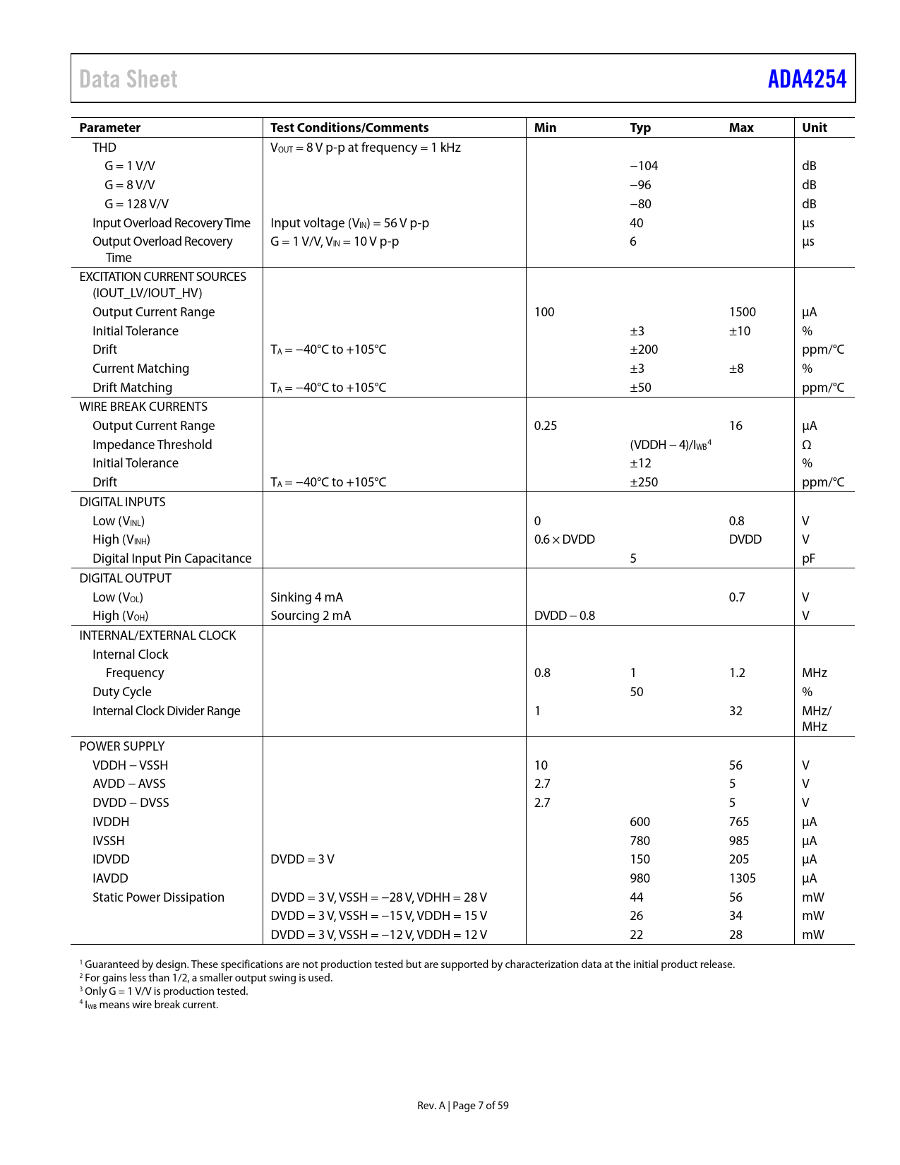

Data Sheet. ADA4254. Parameter. Test Conditions/Comments. Min. Typ. Max. Unit
Data Sheet ADA4254 Parameter Test Conditions/Comments Min Typ Max Unit
THD VOUT = 8 V p-p at frequency = 1 kHz G = 1 V/V −104 dB G = 8 V/V −96 dB G = 128 V/V −80 dB Input Overload Recovery Time Input voltage (VIN) = 56 V p-p 40 μs Output Overload Recovery G = 1 V/V, VIN = 10 V p-p 6 μs Time EXCITATION CURRENT SOURCES (IOUT_LV/IOUT_HV) Output Current Range 100 1500 µA Initial Tolerance ±3 ±10 % Drift TA = −40°C to +105°C ±200 ppm/°C Current Matching ±3 ±8 % Drift Matching TA = −40°C to +105°C ±50 ppm/°C WIRE BREAK CURRENTS Output Current Range 0.25 16 μA Impedance Threshold (VDDH − 4)/I 4 WB Ω Initial Tolerance ±12 % Drift TA = −40°C to +105°C ±250 ppm/°C DIGITAL INPUTS Low (VINL) 0 0.8 V High (VINH) 0.6 × DVDD DVDD V Digital Input Pin Capacitance 5 pF DIGITAL OUTPUT Low (VOL) Sinking 4 mA 0.7 V High (VOH) Sourcing 2 mA DVDD − 0.8 V INTERNAL/EXTERNAL CLOCK Internal Clock Frequency 0.8 1 1.2 MHz Duty Cycle 50 % Internal Clock Divider Range 1 32 MHz/ MHz POWER SUPPLY VDDH − VSSH 10 56 V AVDD − AVSS 2.7 5 V DVDD − DVSS 2.7 5 V IVDDH 600 765 µA IVSSH 780 985 µA IDVDD DVDD = 3 V 150 205 µA IAVDD 980 1305 µA Static Power Dissipation DVDD = 3 V, VSSH = −28 V, VDHH = 28 V 44 56 mW DVDD = 3 V, VSSH = −15 V, VDDH = 15 V 26 34 mW DVDD = 3 V, VSSH = −12 V, VDDH = 12 V 22 28 mW 1 Guaranteed by design. These specifications are not production tested but are supported by characterization data at the initial product release. 2 For gains less than 1/2, a smal er output swing is used. 3 Only G = 1 V/V is production tested. 4 IWB means wire break current. Rev. A | Page 7 of 59 Document Outline FEATURES APPLICATIONS GENERAL DESCRIPTION SIMPLIFIED FUNCTIONAL BLOCK DIAGRAM COMPANION PRODUCTS TABLE OF CONTENTS REVISION HISTORY SPECIFICATIONS TIMING SPECIFICATIONS Timing Diagrams ABSOLUTE MAXIMUM RATINGS THERMAL RESISTANCE ESD CAUTION PIN CONFIGURATIONS AND FUNCTION DESCRIPTIONS TYPICAL PERFORMANCE CHARACTERISTICS THEORY OF OPERATION PROGRAMMABLE GAIN INSTRUMENTATION AMPLIFIER INPUT MULTIPLEXER EMI REDUCTION AND INTERNAL EMI FILTER INPUT AMPLIFIER OUTPUT AMPLIFIER POWER SUPPLIES ESD MAP OUTPUT RIPPLE CALIBRATION CONFIGURATION GENERAL-PURPOSE INPUTS/OUTPUTS (GPIOs) EXCITATION CURRENTS EXTERNAL CLOCK SYNCHRONIZATION SEQUENTIAL CHIP SELECT (SCS) GAIN ERROR CALIBRATION WIRE BREAK DETECTION TEST MULTIPLEXER EXTERNAL MUX CONTROL DIGITAL INTERFACE SPI INTERFACE ACCESSING THE ADA4254 REGISTER MAP CHECKSUM PROTECTION CRC CALCULATION MEMORY MAP CHECKSUM PROTECTION READ-ONLY MEMORY (ROM) CHECKSUM PROTECTION SPI READ/WRITE ERROR DETECTION SPI COMMAND LENGTH ERROR DETECTION APPLICATIONS INFORMATION INPUT AND OUTPUT OFFSET VOLTAGE AND NOISE ADC CLOCK SYNCHRONIZATION PROGRAMMABLE LOGIC CONTROLLER (PLC)VOLTAGE/CURRENT INPUT 3-WIRE RTD WITH CURRENT EXCITATION HIGH RAIL CURRENT SENSING REGISTER SUMMARY REGISTER DETAILS GAIN_MUX REGISTER DETAILS Bit 7, G4—Output Amplifier Scaling Gain (1.375 V/V) Bits[6:3], G[3:0]—Input Amplifier Gain Setting Bits[1:0], EXT_MUX[1:0]—External Multiplexer Control SOFTWARE RESET REGISTER (RESET) DETAILS Bit 0, RST—Soft Reset CLOCK SYNCHRONIZATION CONFIGURATION REGISTER (SYNC_CFG) DETAILS Bit 6, CLK_OUT_SEL—Clock Output Select Bit 4, SYNC_POL—Clock Synchronization Polarity Bits[2:0], SYNC[2:0]—Internal Clock Divider Value DIGITAL ERROR REGISTER (DIGITAL_ERR) DETAILS Bit 6, CAL_BUSY—Calibration Busy (Read Only) Bit 5, SPI_CRC_ERR—SPI CRC Error Bit 4, SPI_RW_ERR—SPI Read/Write Error Bit 3, SPI_SCLK_CNT_ERR—SPI SCLK Count Error Bit 1, MM_CRC_ERR—Memory Map CRC Error Bit 0, ROM_CRC_ERR—ROM CRC Error ANALOG ERROR REGISTER (ANALOG_ERR) DETAILS Bit 7, G_RST—Gain Reset Flag Bit 6, POR_HV—Power-On Reset HV Supply Bit 4, WB_ERR—Wire Break Detect Error Bit 3, FAULT_INT—Fault Interrupt Bit 2, OUTPUT_ERR—Output Amplifier Error Bit 1, INPUT_ERR—Input Amplifier Error Bit 0, MUX_OVER_VOLT_ERR—Input Multiplexer Overvoltage Error GPIO DATA REGISTER (GPIO_DATA) DETAILS Bits[6:0], GPIO_DATA[6:0]—GPIO Data Values INTERNAL MUX CONTROL REGISTER (INPUT_MUX) DETAILS Bit 6, SW_A1, and Bit 5, SW_A2—Channel 1 Input Switches Bit 4, SW_B1, and Bit 3, SW_B2—Channel 2 Input Switches Bit 2, SW_C1, and Bit 1, SW_C2—PGIA Input Test Multiplexer Switches Bit 0, SW_D12—PGIA Input Short Switch WIRE BREAK DETECT REGISTER (WB_DETECT) DETAILS Bit 7, WB_G_RST_DIS—Wire Break Gain Reset Disable Bit 3, SW_F1, and Bit 2, SW_F2—Fault Switch Selection Bits[1:0], WB_CURRENT—Detection Current Selection GPIO DIRECTION REGISTER (GPIO_DIR) DETAILS Bits[6:0], GPIO_DIR—GPIO Direction Configuration SEQUENTIAL CHIP SELECT REGISTER (SCS) DETAILS Bits[6:0], SCS—Sequential Chip Select Configuration ANALOG ERROR MASK REGISTER (ANALOG_ERR_DIS) DETAILS Bit 7, G_RST_DIS—Disable Gain Reset Error Flag Bit 6, POR_HV_DIS—Disable High Voltage Power Reset Flag Bit 4, WB_ERR_DIS—Disable Wire-Break Detection Flag Bit 3, MUX_PROT_DIS—Disable Input Multiplexer Protection Bit 2, OUTPUT_ERR_DIS—Disable Output Amplifier Error Flag Bit 1, INPUT_ERR_DIS—Disable Input Amplifier Error Flag Bit 0, MUX_OVER_VOLT_ERR_DIS—Disable Multiplexer Overvoltage Flag. DIGITAL ERROR MASK REGISTER (DIGITAL_ERR_DIS) DETAILS Bit 6, CAL_BUSY_DIS—Disable Calibration Busy Error Flag Bit 5, SPI_CRC_ERR_DIS—Disable SPI CRC Error Flag Bit 4, SPI_RW_ERR_DIS—Disable SPI Read/Write Error Flag Bit 3, SPI_SCLK_CNT_ERR_DIS—Disable SPI SCLK Count Error Flag Bit 2, M_CLK_CNT_ERR_DIS—Disable Master Clock Count Output Bit 1, MM_CRC_ERR_DIS—Disable Memory Map CRC Error Flag Bit 0, ROM_CRC_ERR_DIS—Disable ROM CRC Error Flag SPECIAL FUNCTION CONFIGURATION REGISTER (SF_CFG) DETAILS Bit 5, INT_CLK_OUT—Internal Oscillator Output Bit 4, EXT_CLK_IN—External Oscillator Input Bit 3, FAULT_INT_OUT—Fault Interrupt Output Bit 2, CAL_BUSY_OUT—Calibration Busy Output Bits[1:0], EXT_MUX_EN[1:0]—Enable External Multiplexer Control ERROR CONFIGURATION REGISTER Bit 7, ERR_LATCH_DIS—Disable Error Latching Bits[3:0], ERR_DELAY[3:0] —Error Suppression Time TEST MULTIPLEXER REGISTER (TEST_MUX) DETAILS Bit 7, G5—Output Amplifier Scaling Gain = 1.25 V/V Bit 6, CAL_SEL—Calibration Type Configuration Bits[5:4], CAL_EN[1:0]—Scheduled Calibration Enable and Interval Bits[3:0], TEST_MUX[3:0]—Input Test Multiplexer Configuration EXCITATION CURRENT CONFIGURATION REGISTER (EX_CURRENT_CFG) DETAILS Bits[7:6], EX_CURRENT_SEL[1:0]—Excitation Current Connection Configuration Bits[3:0], EX_CURRENT[3:0]—Excitation Current Value GAIN CALIBRATION REGISTERS (GAIN_CALx) DETAILS TRIGGER CALIBRATION REGISTER (TRIG_CAL) DETAILS Bit 0, TRIG_CAL—Trigger Calibration Input MASTER CLOCK COUNT REGISTER (M_CLK_CNT) DETAILS Bits[7:0], M_CLK_CNT[7:0]—Master Clock Count DIE REVISION IDENTIFICATION REGISTER (DIE_REV_ID) DETAILS Bits[7:0], DIE_REV_ID[7:0]—Die Revision Identification Number DEVICE IDENTIFICATION REGISTERS (PART_ID) DETAILS PART_ID[39:0]—Part ID Number OUTLINE DIMENSIONS ORDERING GUIDE
