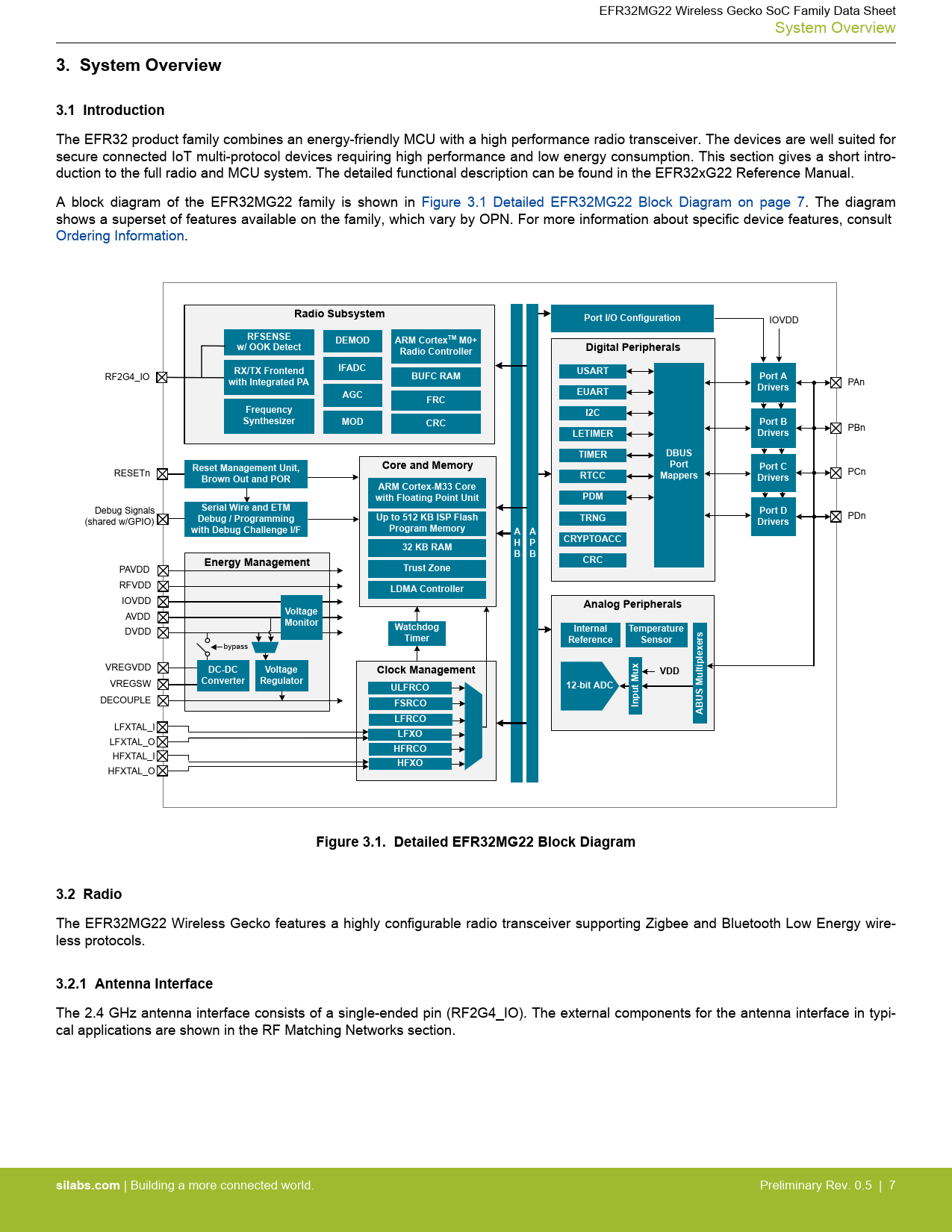

3. System Overview 3.1 Introduction
The EFR32 product family combines an energy-friendly MCU with a high performance radio transceiver. The devices are well suited for secure connected IoT multi-protocol devices requiring high performance and low energy consumption. This section gives a short intro- duction to the full radio and MCU system. The detailed functional description can be found in the EFR32xG22 Reference Manual. A block diagram of the EFR32MG22 family is shown in Figure 3.1 Detailed EFR32MG22 Block Diagram on page 7. The diagram shows a superset of features available on the family, which vary by OPN. For more information about specific device features, consult Ordering Information.
Radio Subsystem Port I/O Configuration
IOVDD
RFSENSE DEMOD ARM CortexTM M0+ w/ OOK Detect Digital Peripherals Radio Controller RX/TX Frontend IFADC USART
RF2G4_IO
BUFC RAM Port A with Integrated PA
PAn
Drivers EUART AGC FRC Frequency I2C Synthesizer MOD CRC Port B
PBn
LETIMER Drivers TIMER DBUS Reset Management Unit, Core and Memory Port Port C
RESETn
RTCC Mappers
PCn
Brown Out and POR Drivers ARM Cortex-M33 Core with Floating Point Unit PDM
Debug Signals
Serial Wire and ETM Port D Debug / Programming Up to 512 KB ISP Flash TRNG
PDn (shared w/GPIO)
Drivers with Debug Challenge I/F Program Memory A A CRYPTOACC 32 KB RAM H P B B CRC Energy Management
PAVDD
Trust Zone
RFVDD
LDMA Controller
IOVDD
Analog Peripherals Voltage
AVDD
Monitor Watchdog Internal Temperature
DVDD
Timer Reference Sensor
bypass VREGVDD
DC-DC Voltage Clock Management VDD
VREGSW
Converter Regulator ULFRCO 12-bit ADC Multiplexers
DECOUPLE
FSRCO Input Mux ABUS LFRCO
LFXTAL_I
LFXO
LFXTAL_O
HFRCO
HFXTAL_I
HFXO
HFXTAL_O
Figure 3.1. Detailed EFR32MG22 Block Diagram 3.2 Radio
The EFR32MG22 Wireless Gecko features a highly configurable radio transceiver supporting Zigbee and Bluetooth Low Energy wire- less protocols.
3.2.1 Antenna Interface
The 2.4 GHz antenna interface consists of a single-ended pin (RF2G4_IO). The external components for the antenna interface in typi- cal applications are shown in the RF Matching Networks section.
