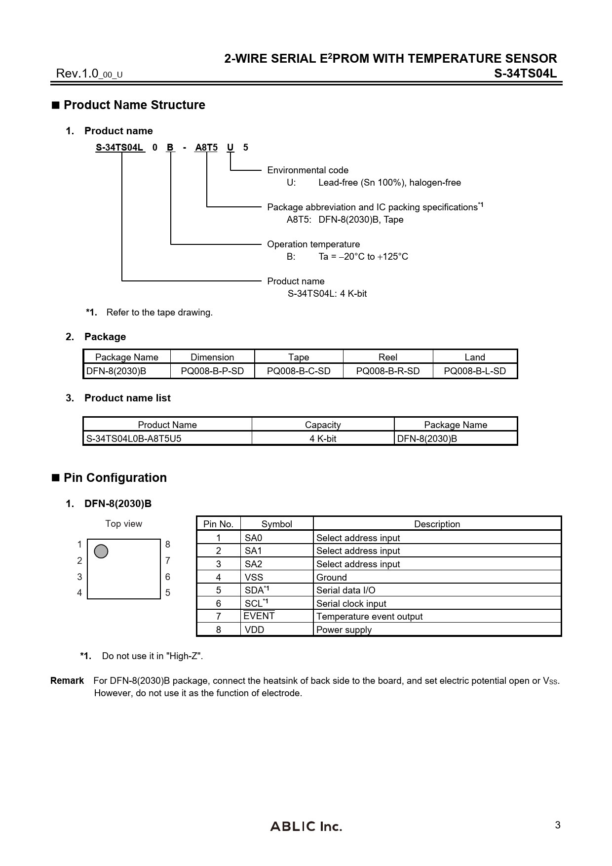

2-WIRE SERIAL E2PROM WITH TEMPERATURE SENSOR. S-34TS04L. Product Name Structure. 1. Product name. S-34TS04L 0 B - A8T5 U 5. *1
2-WIRE SERIAL E2PROM WITH TEMPERATURE SENSOR S-34TS04L Product Name Structure 1 Product name S-34TS04L 0 B - A8T5 U 5 *1
Rev.1.0_00_U
S-34TS04L Product Name Structure 1. Product name S-34TS04L 0 B - A8T5 U 5
Environmental code U: Lead-free (Sn 100%), halogen-free Package abbreviation and IC packing specifications
*1
A8T5: DFN-8(2030)B, Tape Operation temperature B: Ta = −20°C to +125°C Product name S-34TS04L: 4 K-bit
*1.
Refer to the tape drawing.
2. Package
Package Name Dimension Tape Reel Land DFN-8(2030)B PQ008-B-P-SD PQ008-B-C-SD PQ008-B-R-SD PQ008-B-L-SD
3. Product name list
Product Name Capacity Package Name S-34TS04L0B-A8T5U5 4 K-bit DFN-8(2030)B
Pin Configuration 1. DFN-8(2030)B
Top view Pin No. Symbol Description 1 SA0 Select address input 1 8 2 SA1 Select address input 2 7 3 SA2 Select address input 3 6 4 VSS Ground 4 5 5 SDA
*1
Serial data I/O 6 SCL
*1
Serial clock input ___________ 7 EVENT Temperature event output 8 VDD Power supply
*1.
Do not use it in "High-Z".
Remark
For DFN-8(2030)B package, connect the heatsink of back side to the board, and set electric potential open or VSS. However, do not use it as the function of electrode. 3
