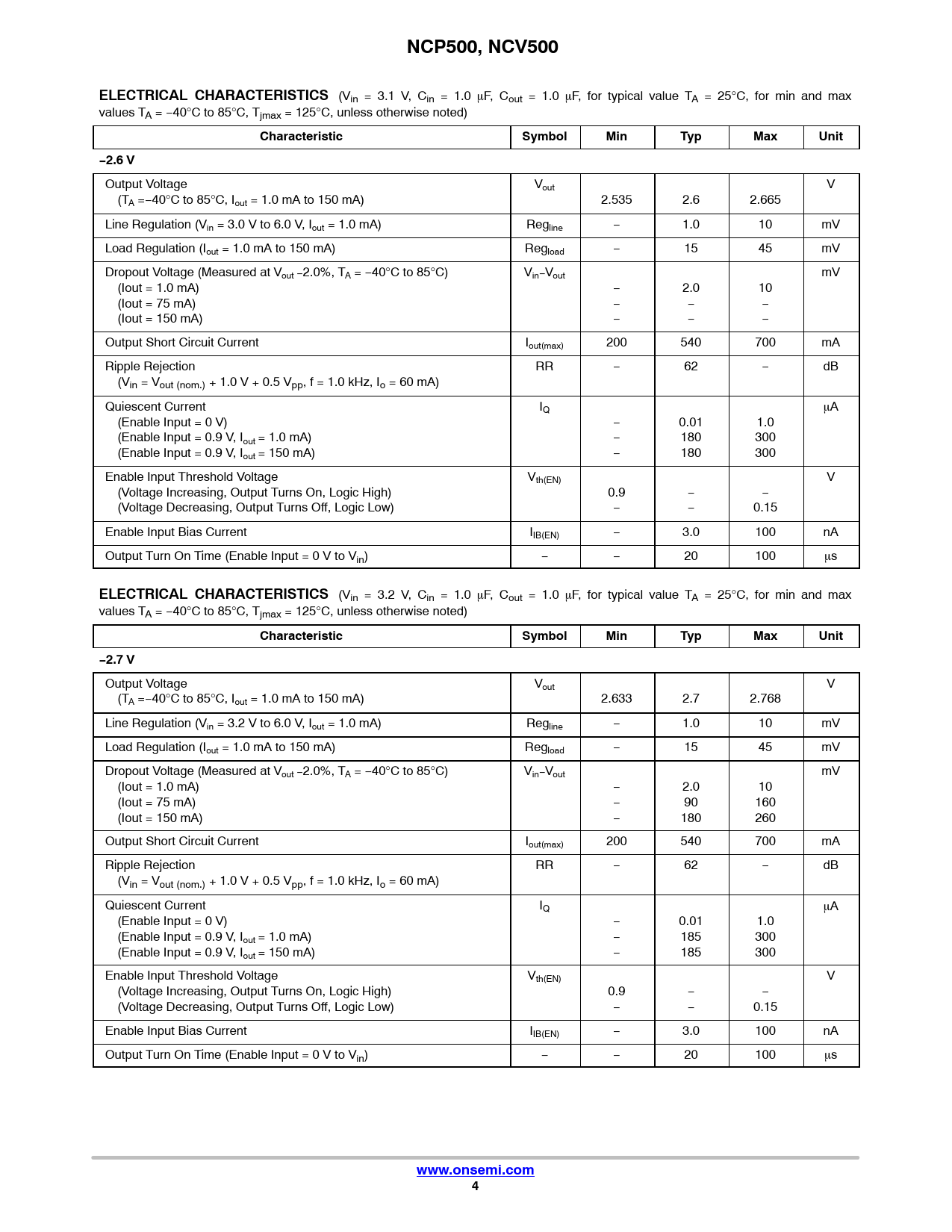

NCP500, NCV500. ELECTRICAL CHARACTERISTICS. Characteristic. Symbol. Min. Typ. Max. Unit. −2.6 V. −2.7 V. www.onsemi.com
![NCP500, NCV500 ELECTRICAL CHARACTERISTICS Characteristic Symbol Min Typ Max Unit −2.6 V −2.7 V www.onsemi.com](https://www.rlocman.ru/datasheet/img.php?di=168403&p=3)
(Vin = 3.1 V, Cin = 1.0 mF, Cout = 1.0 mF, for typical value TA = 25°C, for min and max values TA = −40°C to 85°C, Tjmax = 125°C, unless otherwise noted)
Output Voltage Vout V (TA =−40°C to 85°C, Iout = 1.0 mA to 150 mA) 2.535 2.6 2.665 Line Regulation (Vin = 3.0 V to 6.0 V, Iout = 1.0 mA) Regline − 1.0 10 mV Load Regulation (Iout = 1.0 mA to 150 mA) Regload − 15 45 mV Dropout Voltage (Measured at Vout −2.0%, TA = −40°C to 85°C) Vin−Vout mV (Iout = 1.0 mA) − 2.0 10 (Iout = 75 mA) − − − (Iout = 150 mA) − − − Output Short Circuit Current Iout(max) 200 540 700 mA Ripple Rejection RR − 62 − dB (Vin = Vout (nom.) + 1.0 V + 0.5 Vpp, f = 1.0 kHz, Io = 60 mA) Quiescent Current IQ mA (Enable Input = 0 V) − 0.01 1.0 (Enable Input = 0.9 V, Iout = 1.0 mA) − 180 300 (Enable Input = 0.9 V, Iout = 150 mA) − 180 300 Enable Input Threshold Voltage Vth(EN) V (Voltage Increasing, Output Turns On, Logic High) 0.9 − − (Voltage Decreasing, Output Turns Off, Logic Low) − − 0.15 Enable Input Bias Current IIB(EN) − 3.0 100 nA Output Turn On Time (Enable Input = 0 V to Vin) − − 20 100 ms
(Vin = 3.2 V, Cin = 1.0 mF, Cout = 1.0 mF, for typical value TA = 25°C, for min and max values TA = −40°C to 85°C, Tjmax = 125°C, unless otherwise noted)
Characteristic Symbol Min Typ Max Unit −2.7 V
Output Voltage Vout V (TA =−40°C to 85°C, Iout = 1.0 mA to 150 mA) 2.633 2.7 2.768 Line Regulation (Vin = 3.2 V to 6.0 V, Iout = 1.0 mA) Regline − 1.0 10 mV Load Regulation (Iout = 1.0 mA to 150 mA) Regload − 15 45 mV Dropout Voltage (Measured at Vout −2.0%, TA = −40°C to 85°C) Vin−Vout mV (Iout = 1.0 mA) − 2.0 10 (Iout = 75 mA) − 90 160 (Iout = 150 mA) − 180 260 Output Short Circuit Current Iout(max) 200 540 700 mA Ripple Rejection RR − 62 − dB (Vin = Vout (nom.) + 1.0 V + 0.5 Vpp, f = 1.0 kHz, Io = 60 mA) Quiescent Current IQ mA (Enable Input = 0 V) − 0.01 1.0 (Enable Input = 0.9 V, Iout = 1.0 mA) − 185 300 (Enable Input = 0.9 V, Iout = 150 mA) − 185 300 Enable Input Threshold Voltage Vth(EN) V (Voltage Increasing, Output Turns On, Logic High) 0.9 − − (Voltage Decreasing, Output Turns Off, Logic Low) − − 0.15 Enable Input Bias Current IIB(EN) − 3.0 100 nA Output Turn On Time (Enable Input = 0 V to Vin) − − 20 100 ms
www.onsemi.com 4
