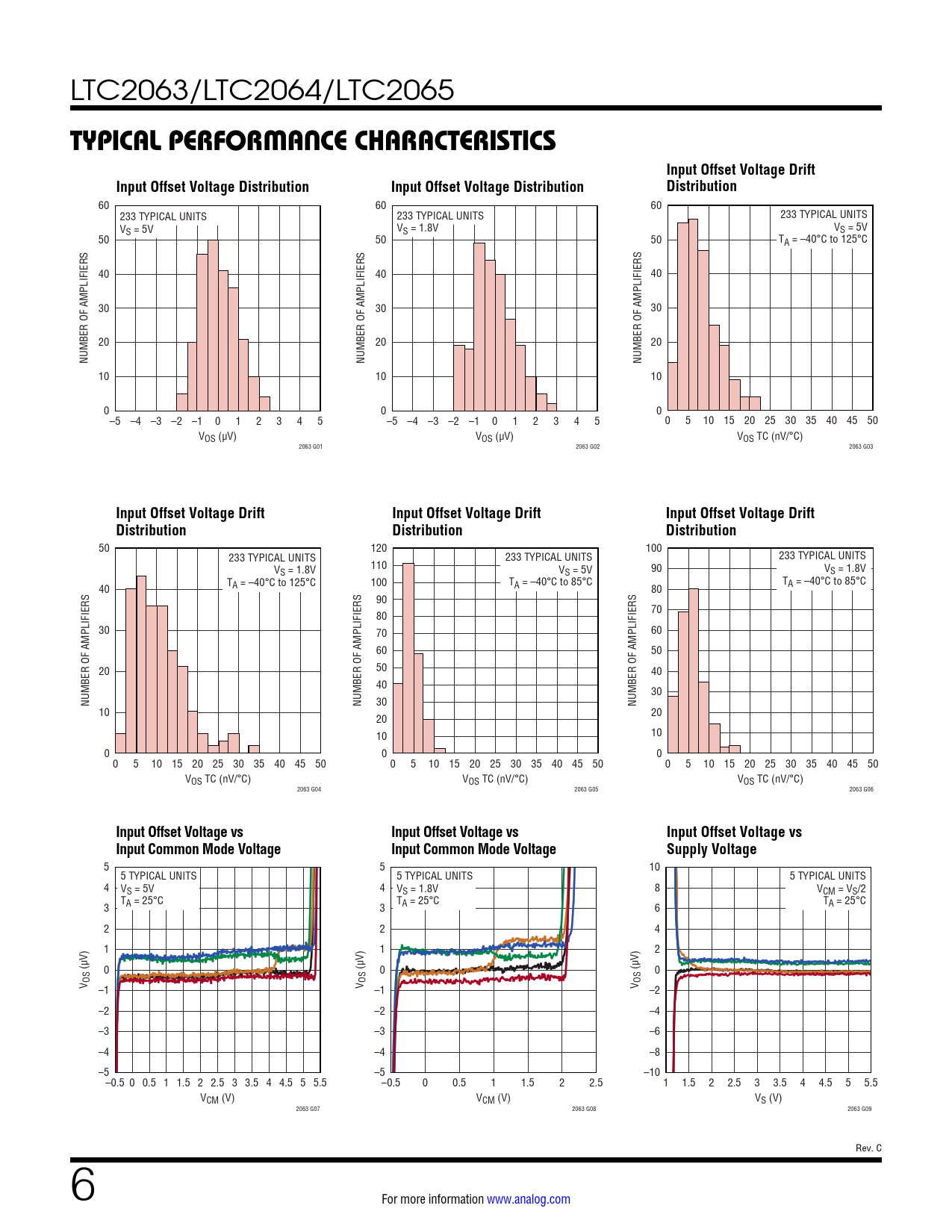

TYPICAL PERFORMANCE CHARACTERISTICS. Input Offset Voltage Drift. Input Offset Voltage Distribution. Distribution
TYPICAL PERFORMANCE CHARACTERISTICS Input Offset Voltage Drift Input Offset Voltage Distribution Distribution
LTC2063/LTC2064/LTC2065
TYPICAL PERFORMANCE CHARACTERISTICS Input Offset Voltage Drift Input Offset Voltage Distribution Input Offset Voltage Distribution Distribution
60 60 60 233 TYPICAL UNITS 233 TYPICAL UNITS 233 TYPICAL UNITS VS = 5V VS = 1.8V VS = 5V 50 50 50 TA = –40°C to 125°C 40 40 40 30 30 30 20 20 20 NUMBER OF AMPLIFIERS NUMBER OF AMPLIFIERS NUMBER OF AMPLIFIERS 10 10 10 0 0 0 –5 –4 –3 –2 –1 0 1 2 3 4 5 –5 –4 –3 –2 –1 0 1 2 3 4 5 0 5 10 15 20 25 30 35 40 45 50 VOS (µV) VOS (µV) VOS TC (nV/°C) 2063 G01 2063 G02 2063 G03
Input Offset Voltage Drift Input Offset Voltage Drift Input Offset Voltage Drift Distribution Distribution Distribution
50 120 100 233 TYPICAL UNITS 233 TYPICAL UNITS 233 TYPICAL UNITS V 110 S = 1.8V VS = 5V 90 VS = 1.8V TA = –40°C to 125°C 100 T T 40 A = –40°C to 85°C A = –40°C to 85°C 80 90 70 80 30 70 60 60 50 20 50 40 40 30 NUMBER OF AMPLIFIERS NUMBER OF AMPLIFIERS 30 NUMBER OF AMPLIFIERS 10 20 20 10 10 0 0 0 0 5 10 15 20 25 30 35 40 45 50 0 5 10 15 20 25 30 35 40 45 50 0 5 10 15 20 25 30 35 40 45 50 VOS TC (nV/°C) VOS TC (nV/°C) VOS TC (nV/°C) 2063 G04 2063 G05 2063 G06
Input Offset Voltage vs Input Offset Voltage vs Input Offset Voltage vs Input Common Mode Voltage Input Common Mode Voltage Supply Voltage
5 5 10 5 TYPICAL UNITS 5 TYPICAL UNITS 5 TYPICAL UNITS 4 VS = 5V 4 VS = 1.8V 8 VCM = VS/2 TA = 25°C T T 3 A = 25°C 3 A = 25°C 6 2 2 4 1 1 2 V) V) V) (µ 0 (µ 0 (µ 0 V OS –1 V OS –1 V OS –2 –2 –2 –4 –3 –3 –6 –4 –4 –8 –5 –5 –10 –0.5 0 0.5 1 1.5 2 2.5 3 3.5 4 4.5 5 5.5 –0.5 0 0.5 1 1.5 2 2.5 1 1.5 2 2.5 3 3.5 4 4.5 5 5.5 VCM (V) VCM (V) VS (V) 2063 G07 2063 G08 2063 G09 Rev. C 6 For more information www.analog.com Document Outline Features Applications Typical Application Description Absolute Maximum Ratings Pin Configuration Order Information Electrical Characteristics Typical Performance Characteristics Pin Functions Block Diagram Applications Information Typical Applications Package Description Revision History Typical Application Related Parts
