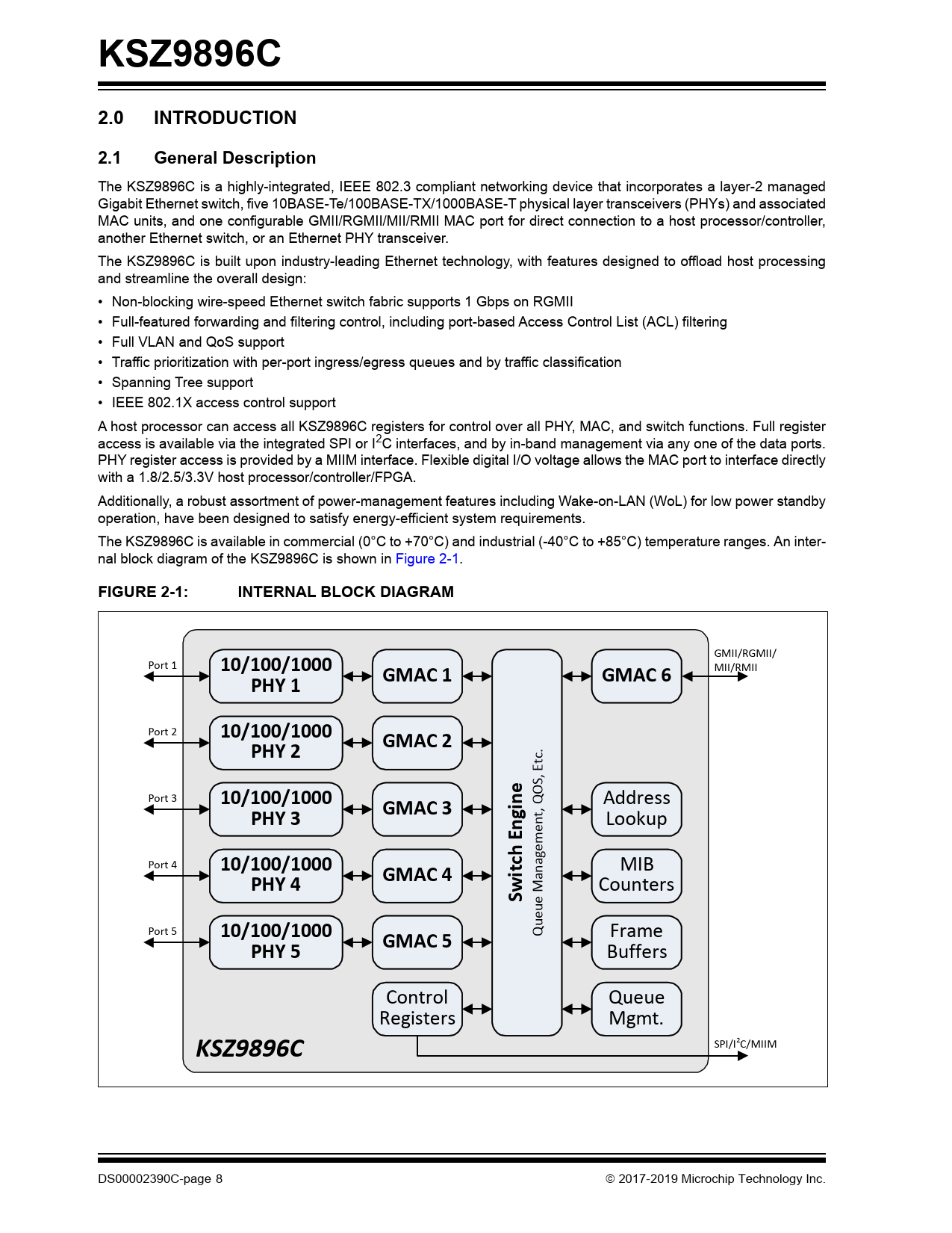

KSZ9896C 2.0 INTRODUCTION 2.1 General Description
The KSZ9896C is a highly-integrated, IEEE 802.3 compliant networking device that incorporates a layer-2 managed Gigabit Ethernet switch, five 10BASE-Te/100BASE-TX/1000BASE-T physical layer transceivers (PHYs) and associated MAC units, and one configurable GMII/RGMII/MII/RMII MAC port for direct connection to a host processor/controller, another Ethernet switch, or an Ethernet PHY transceiver. The KSZ9896C is built upon industry-leading Ethernet technology, with features designed to offload host processing and streamline the overall design: • Non-blocking wire-speed Ethernet switch fabric supports 1 Gbps on RGMII • Full-featured forwarding and filtering control, including port-based Access Control List (ACL) filtering • Full VLAN and QoS support • Traffic prioritization with per-port ingress/egress queues and by traffic classification • Spanning Tree support • IEEE 802.1X access control support A host processor can access all KSZ9896C registers for control over all PHY, MAC, and switch functions. Full register access is available via the integrated SPI or I2C interfaces, and by in-band management via any one of the data ports. PHY register access is provided by a MIIM interface. Flexible digital I/O voltage allows the MAC port to interface directly with a 1.8/2.5/3.3V host processor/controller/FPGA. Additionally, a robust assortment of power-management features including Wake-on-LAN (WoL) for low power standby operation, have been designed to satisfy energy-efficient system requirements. The KSZ9896C is available in commercial (0°C to +70°C) and industrial (-40°C to +85°C) temperature ranges. An inter- nal block diagram of the KSZ9896C is shown in Figure 2-1.
FIGURE 2-1: INTERNAL BLOCK DIAGRAM
GMII/RGMII/ Port 1
10/100/1000
MII/RMII
PHY 1 GMAC 1 GMAC 6
Port 2
10/100/1000 PHY 2 GMAC 2
c.
e
S, Et Port 3
10/100/1000 n
Address , QO
PHY 3 GMAC 3 gi
Lookup ent
 En
gem Port 4
10/100/1000 itch
na MIB
PHY 4 GMAC 4
Counters
Sw
 Maeeu Port 5
10/100/1000 GMAC 5
Qu Frame
PHY 5
Buffers Control Queue Registers Mgmt.
KSZ9896C
