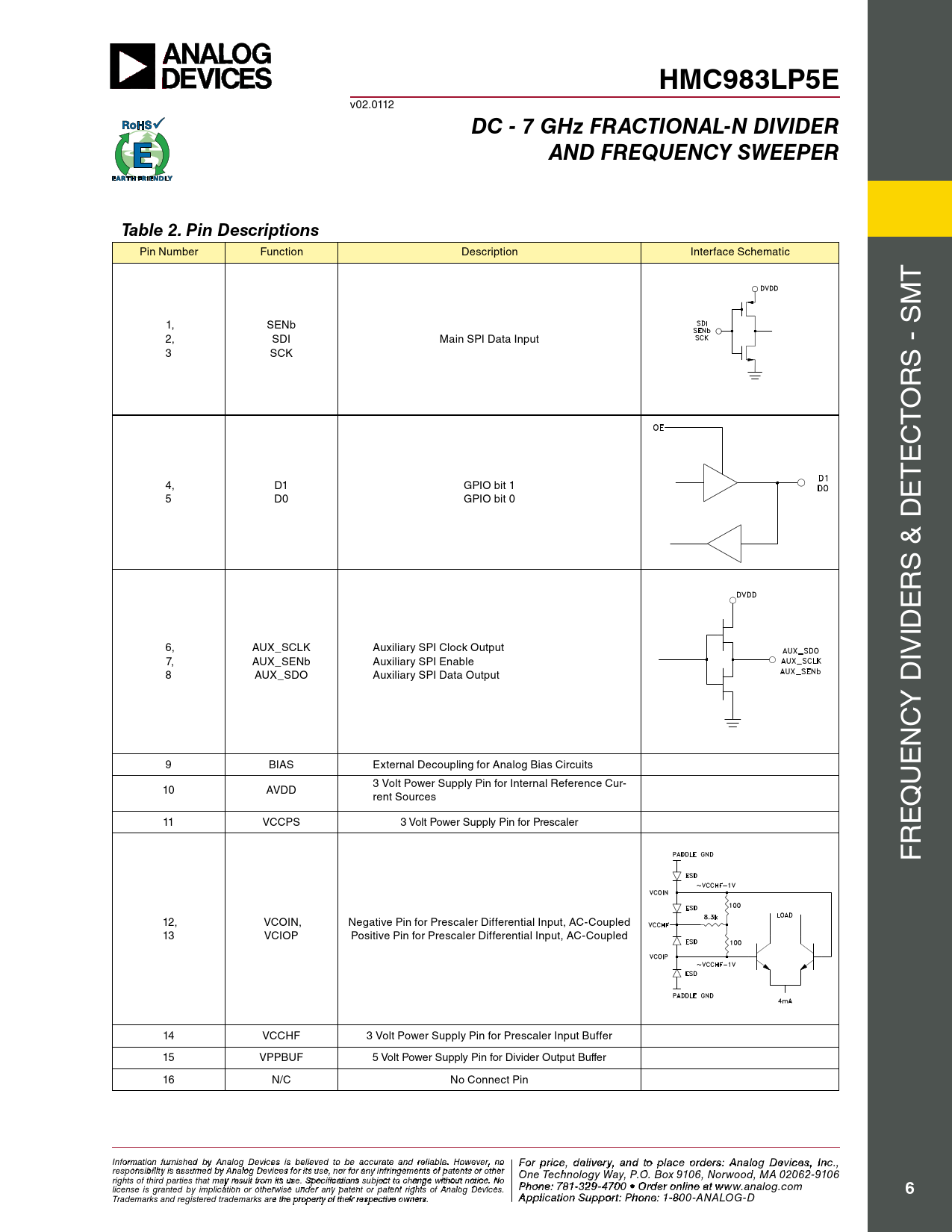

HMC983LP5E. DC - 7 GHz FRACTIONAL-N DIVIDER. AND FREQUENCY SWEEPER. Table 2. Pin Descriptions
HMC983LP5E DC - 7 GHz FRACTIONAL-N DIVIDER AND FREQUENCY SWEEPER Table 2 Pin Descriptions
HMC983LP5E
v02.0112
DC - 7 GHz FRACTIONAL-N DIVIDER AND FREQUENCY SWEEPER Table 2. Pin Descriptions
Pin number Function Description interface schematic t M 1, senb s 2, sDi Main sPi Data input 3 scK s - r o t c e t 4, D1 GPio bit 1 5 D0 GPio bit 0 e s & D r e iD 6, AuX_scLK Auxiliary sPi clock output 7, AuX_senb Auxiliary sPi enable iv 8 AuX_sDo Auxiliary sPi Data output y D c n 9 BiAs external Decoupling for Analog Bias circuits e 3 volt Power supply Pin for internal reference cur- u 10 AvDD rent sources q 11 vccPs 3 volt Power supply Pin for Prescaler e r F 12, vcoin, negative Pin for Prescaler Differential input, Ac-coupled 13 vcioP Positive Pin for Prescaler Differential input, Ac-coupled 14 vccHF 3 volt Power supply Pin for Prescaler input Buffer 15 vPPBuF 5 volt Power supply Pin for Divider output Buffer 16 n/c no connect Pin Inf F or o m r p atio r n ifc ur e n , d ishe e d lbiv y e A r n y a alog n D d t evic o p es is la beclie o eved rd to ebre sa: H ccur iattti e tae M nd re ilicarbloew . H a o ve C wever, o n rp o For price, delivery, and to place orders: Analog Devices, Inc., responsibility is assumed by Analog Devices for its use, nor for any infringements of patents or other oration, 2 Elizabeth Drive, Chelmsford, MA 01824 One Technology Way, P.O. Box 9106, Norwood, MA 02062-9106 Phone: 978-250-3343 Fax: 978-250-3373 O rights of third parties that may result from its use. Specifications subject to change without notice. No P rd ho e ne r O : 7 n 81- -3li 2n 9 e a -47 t w 0 w 0 • O w rd .h e it r o tniltie n .c e ao t m license is granted by implication or otherwise under any patent or patent rights of Analog Devices. www.analog.com
