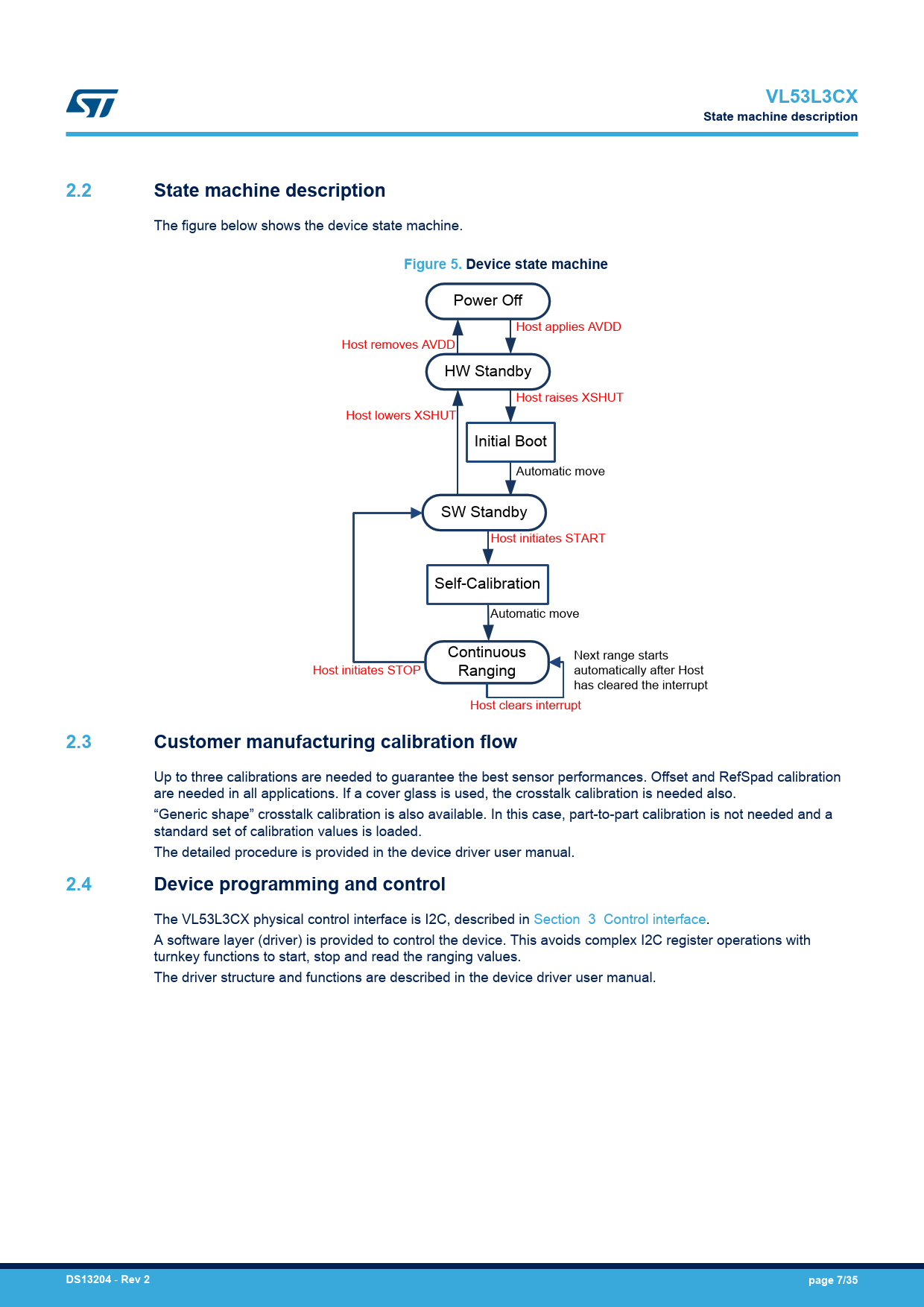

VL53L3CX State machine description 2.2 State machine description
The figure below shows the device state machine.
Figure 5. Device state machine
Power Off Host applies AVDD Host removes AVDD HW Standby Host raises XSHUT Host lowers XSHUT Initial Boot Automatic move SW Standby Host initiates START Self-Calibration Automatic move Continuous Next range starts Host initiates STOP Ranging automatically after Host has cleared the interrupt Host clears interrupt
