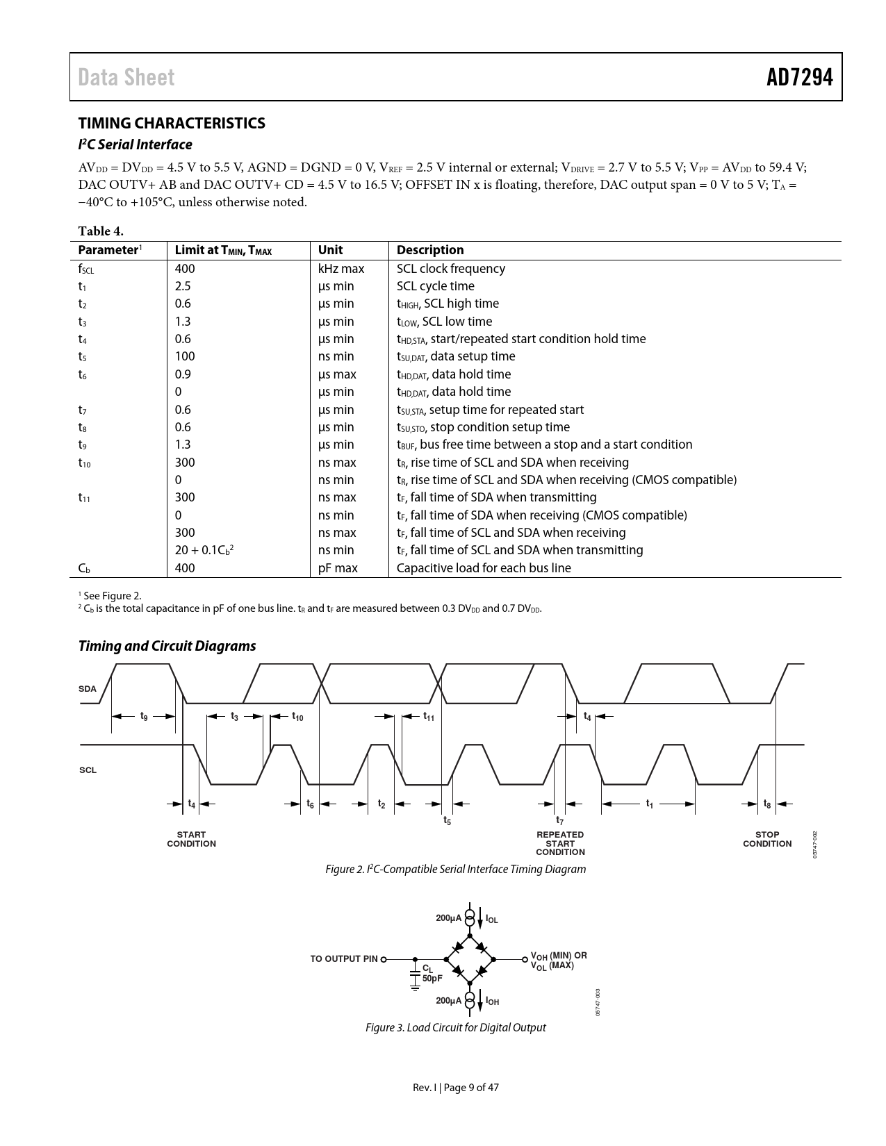

Data Sheet AD7294 TIMING CHARACTERISTICS I2C Serial Interface
AVDD = DVDD = 4.5 V to 5.5 V, AGND = DGND = 0 V, VREF = 2.5 V internal or external; VDRIVE = 2.7 V to 5.5 V; VPP = AVDD to 59.4 V; DAC OUTV+ AB and DAC OUTV+ CD = 4.5 V to 16.5 V; OFFSET IN x is floating, therefore, DAC output span = 0 V to 5 V; TA = −40°C to +105°C, unless otherwise noted.
Table 4. Parameter
1
Limit at TMIN, TMAX Unit Description
fSCL 400 kHz max SCL clock frequency t1 2.5 μs min SCL cycle time t2 0.6 μs min tHIGH, SCL high time t3 1.3 μs min tLOW, SCL low time t4 0.6 μs min tHD,STA, start/repeated start condition hold time t5 100 ns min tSU,DAT, data setup time t6 0.9 μs max tHD,DAT, data hold time 0 μs min tHD,DAT, data hold time t7 0.6 μs min tSU,STA, setup time for repeated start t8 0.6 μs min tSU,STO, stop condition setup time t9 1.3 μs min tBUF, bus free time between a stop and a start condition t10 300 ns max tR, rise time of SCL and SDA when receiving 0 ns min tR, rise time of SCL and SDA when receiving (CMOS compatible) t11 300 ns max tF, fall time of SDA when transmitting 0 ns min tF, fall time of SDA when receiving (CMOS compatible) 300 ns max tF, fall time of SCL and SDA when receiving 20 + 0.1C 2 b ns min tF, fall time of SCL and SDA when transmitting Cb 400 pF max Capacitive load for each bus line 1 See Figure 2. 2 Cb is the total capacitance in pF of one bus line. tR and tF are measured between 0.3 DVDD and 0.7 DVDD.
Timing and Circuit Diagrams SDA t9 t3 t t 10 11 t4 SCL t t t t 4 6 2 1 t8 t5 t7 START REPEATED STOP
02 0
CONDITION START CONDITION
7-
CONDITION
74 05 Figure 2. I2C-Compatible Serial Interface Timing Diagram
200µA IOL TO OUTPUT PIN VOH (MIN) OR C V L OL (MAX) 50pF
03 0
200µA IOH
7- 74 05 Figure 3. Load Circuit for Digital Output Rev. I | Page 9 of 47 Document Outline FEATURES APPLICATIONS GENERAL DESCRIPTION TABLE OF CONTENTS REVISION HISTORY FUNCTIONAL BLOCK DIAGRAM SPECIFICATIONS DAC SPECIFICATIONS ADC SPECIFICATIONS GENERAL SPECIFICATIONS TIMING CHARACTERISTICS I2C Serial Interface Timing and Circuit Diagrams ABSOLUTE MAXIMUM RATINGS THERMAL RESISTANCE ESD CAUTION PIN CONFIGURATIONS AND FUNCTION DESCRIPTIONS TYPICAL PERFORMANCE CHARACTERISTICS TERMINOLOGY DAC TERMINOLOGY ADC TERMINOLOGY THEORY OF OPERATION ADC OVERVIEW ADC TRANSFER FUNCTIONS ANALOG INPUTS Single-Ended Mode Differential Mode Driving Differential Inputs Using an Op Amp Pair Pseudo Differential Mode CURRENT SENSOR Choosing RSENSE Current Sense Filtering Kelvin Sense Resistor Connection ANALOG COMPARATOR LOOP TEMPERATURE SENSOR Remote Sensing Diode Ideality Factor Base Emitter Voltage Base Resistance hFE Variation Series Resistance Cancellation DAC OPERATION Resistor String Output Amplifier ADC AND DAC REFERENCE VDRIVE FEATURE REGISTER SETTING ADDRESS POINTER REGISTER COMMAND REGISTER (0x00) RESULT REGISTER (0x01) ADC Channel Allocation TSENSE1, TSENSE2 RESULT REGISTERS (0X02 AND 0X03) TSENSEINT RESULT REGISTER (0X04) Temperature Value Format DACA, DACB, DACC, DACD, REGISTERS (0x01 TO 0x04) ALERT STATUS REGISTER A (0x05), REGISTER B (0x06), AND REGISTER C (0x07) CHANNEL SEQUENCE REGISTER (0x08) CONFIGURATION REGISTER (0x09) Sample Delay and Bit Trial Delay POWER-DOWN REGISTER (0x0A) DATAHIGH/DATALOW REGISTERS: 0x0B, 0x0C (VIN0); 0x0E, 0x0F (VIN1); 0x11, 0x12 (VIN2); 0x14, 0x15 (VIN3) HYSTERESIS REGISTERS: 0X0D (VIN0), 0X10 (VIN1), 0X13 (VIN2), 0X16 (VIN3) TSENSE OFFSET REGISTERS (0x26 AND 0x27) I2C INTERFACE GENERAL I2C TIMING SERIAL BUS ADDRESS BYTE INTERFACE PROTOCOL Writing a Single Byte of Data to an 8-Bit Register Writing Two Bytes of Data to a 16-Bit Register Writing to Multiple Registers Reading Data from an 8-Bit Register Reading Two Bytes of Data from a 16-Bit Register MODES OF OPERATION COMMAND MODE AUTOCYCLE MODE ALERTS AND LIMITS THEORY ALERT_FLAG BIT ALERT STATUS REGISTERS DATAHIGH AND DATALOW MONITORING FEATURES HYSTERESIS Using the Limit Registers to Store Minimum/Maximum Conversion Results APPLICATIONS INFORMATION BASE STATION POWER AMPLIFIER MONITOR AND CONTROL GAIN CONTROL OF POWER AMPLIFIER LAYOUT AND CONFIGURATION POWER SUPPLY BYPASSING AND GROUNDING Layout Considerations for External Temperature Sensors OUTLINE DIMENSIONS ORDERING GUIDE
