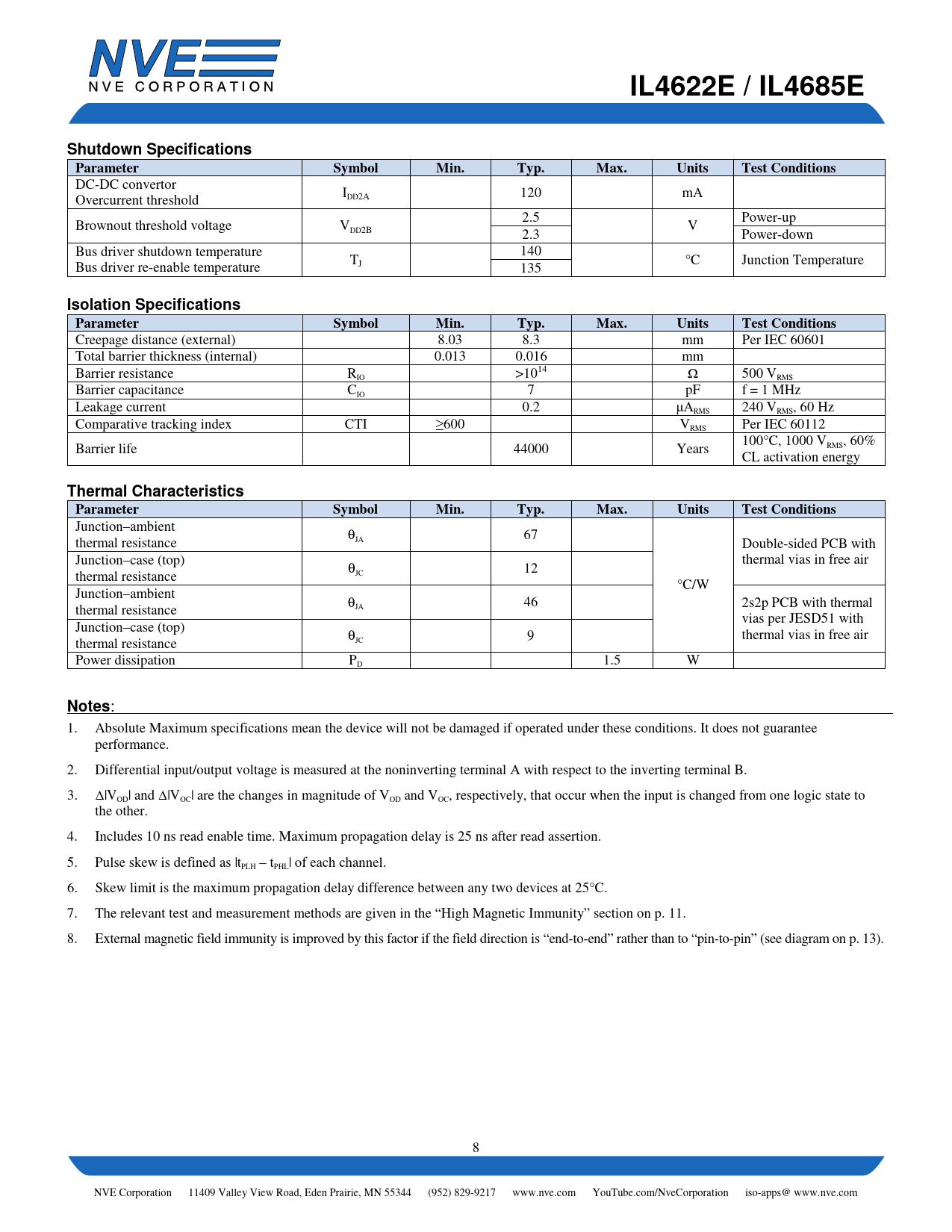

IL4622E / IL4685E. Shutdown Specifications. Parameter. Symbol. Min. Typ. Max. Units. Test Conditions. Isolation Specifications
IL4622E / IL4685E Shutdown Specifications Parameter Symbol Min Typ Max Units Test Conditions Isolation Specifications
IL4622E / IL4685E Shutdown Specifications Parameter Symbol Min. Typ. Max. Units Test Conditions
DC-DC convertor I Overcurrent threshold DD2A 120 mA 2.5 Power-up Brownout threshold voltage V V DD2B 2.3 Power-down Bus driver shutdown temperature 140 T °C Junction Temperature Bus driver re-enable temperature J 135
Isolation Specifications Parameter Symbol Min. Typ. Max. Units Test Conditions
Creepage distance (external) 8.03 8.3 mm Per IEC 60601 Total barrier thickness (internal) 0.013 0.016 mm Barrier resistance R >1014 Ω 500 V IO RMS Barrier capacitance C 7 pF f = 1 MHz IO Leakage current 0.2 μA 240 V , 60 Hz RMS RMS Comparative tracking index CTI ≥600 V Per IEC 60112 RMS 100°C, 1000 V , 60% Barrier life 44000 Years RMS CL activation energy
Thermal Characteristics Parameter Symbol Min. Typ. Max. Units Test Conditions
Junction–ambient θ 67 thermal resistance JA Double-sided PCB with Junction–case (top) thermal vias in free air θ 12 thermal resistance JC °C/W Junction–ambient θ 46 2s2p PCB with thermal thermal resistance JA vias per JESD51 with Junction–case (top) θ 9 thermal vias in free air thermal resistance JC Power dissipation P 1.5 W D
Notes
: 1. Absolute Maximum specifications mean the device will not be damaged if operated under these conditions. It does not guarantee performance. 2. Differential input/output voltage is measured at the noninverting terminal A with respect to the inverting terminal B. 3. Δ|V | and Δ|V | are the changes in magnitude of V and V , respectively, that occur when the input is changed from one logic state to OD OC OD OC the other. 4. Includes 10 ns read enable time. Maximum propagation delay is 25 ns after read assertion. 5. Pulse skew is defined as |t – t | of each channel. PLH PHL 6. Skew limit is the maximum propagation delay difference between any two devices at 25°C. 7. The relevant test and measurement methods are given in the “High Magnetic Immunity” section on p. 11. 8. External magnetic field immunity is improved by this factor if the field direction is “end-to-end” rather than to “pin-to-pin” (see diagram on p. 13). 8 NVE Corporation 11409 Valley View Road, Eden Prairie, MN 55344 (952) 829-9217 www.nve.com YouTube.com/NveCorporation iso-apps@ www.nve.com
