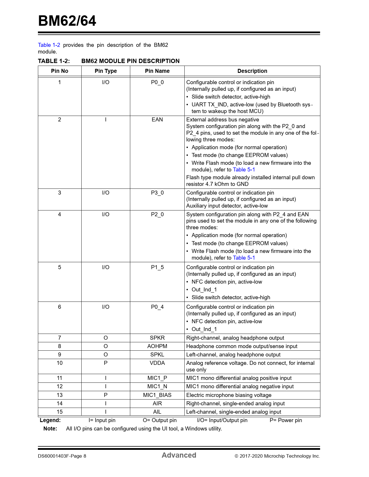

Table 1-2 provides the pin description of the BM62 module.
TABLE 1-2: BM62 MODULE PIN DESCRIPTION Pin No Pin Type Pin Name Description
1 I/O P0_0 Configurable control or indication pin (Internally pulled up, if configured as an input) • Slide switch detector, active-high • UART TX_IND, active-low (used by Bluetooth sys- tem to wakeup the host MCU) 2 I EAN External address bus negative System configuration pin along with the P2_0 and P2_4 pins, used to set the module in any one of the fol- lowing three modes: • Application mode (for normal operation) • Test mode (to change EEPROM values) • Write Flash mode (to load a new firmware into the module), refer to Table 5-1 Flash type module already installed internal pull down resistor 4.7 kOhm to GND 3 I/O P3_0 Configurable control or indication pin (Internally pulled up, if configured as an input) Auxiliary input detector, active-low 4 I/O P2_0 System configuration pin along with P2_4 and EAN pins used to set the module in any one of the following three modes: • Application mode (for normal operation) • Test mode (to change EEPROM values) • Write Flash mode (to load a new firmware into the module), refer to Table 5-1 5 I/O P1_5 Configurable control or indication pin (Internally pulled up, if configured as an input) • NFC detection pin, active-low • Out_Ind_1 • Slide switch detector, active-high 6 I/O P0_4 Configurable control or indication pin (Internally pulled up, if configured as an input) • NFC detection pin, active-low • Out_Ind_1 7 O SPKR Right-channel, analog headphone output 8 O AOHPM Headphone common mode output/sense input 9 O SPKL Left-channel, analog headphone output 10 P VDDA Analog reference voltage. Do not connect, for internal use only 11 I MIC1_P MIC1 mono differential analog positive input 12 I MIC1_N MIC1 mono differential analog negative input 13 P MIC1_BIAS Electric microphone biasing voltage 14 I AIR Right-channel, single-ended analog input 15 I AIL Left-channel, single-ended analog input
Legend:
I= Input pin O= Output pin I/O= Input/Output pin P= Power pin
Note:
All I/O pins can be configured using the UI tool, a Windows utility. DS60001403F-Page 8
