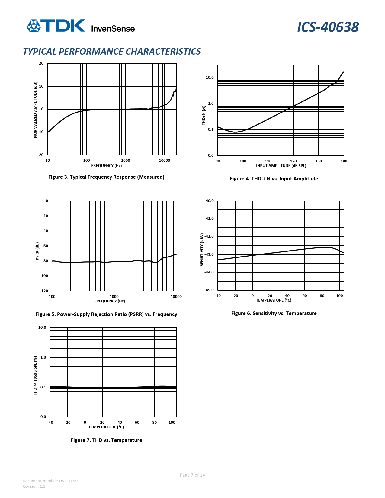

Pages / Page14 / 7 —   ICS‐40638. TYPICAL PERFORMANCE CHARACTERISTICS . 10.0. ) B 10.  (d. …
File Format / SizePDF / 391 Kb
  ICS‐40638. TYPICAL PERFORMANCE CHARACTERISTICS . 10.0. ) B 10.  (d. 1.0.  AMPLITUDE.  (%). THD+N. 0.1. ‐10. NORMALIZED. ‐20. 0.0. 100. 1000. 10000. 110
  ICS‐40638 TYPICAL PERFORMANCE CHARACTERISTICS  10.0 ) B 10  (d 1.0  AMPLITUDE  (%) THD+N 0.1 ‐10 NORMALIZED ‐20 0.0 100 1000 10000 110
    ICS‐40638
TYPICAL PERFORMANCE CHARACTERISTICS  20 10.0 ) B 10  (d 1.0 0  AMPLITUDE  (%) THD+N 0.1 ‐10 NORMALIZED ‐20 0.0 10 100 1000 10000 90 100 110 120 130 140 FREQUENCY (Hz)
INPUT AMPLITUDE (dB SPL) Figure 3. Typical Frequency Response (Measured)  Figure 4. THD + N vs. Input Amplitude      0 ‐40.0 ‐20 ‐41.0 ‐40 ) V ‐42.0 B ) B  (d ‐60  (d ‐43.0 PSRR ‐80 SENSITIVITY ‐44.0 ‐100 ‐120 ‐45.0 100 1000 10000 ‐40 ‐20 0 20 40 60 80 100 FREQUENCY (Hz) TEMPERATURE (°C)
Figure 5. Power‐Supply Rejection Ratio (PSRR) vs. Frequency  Figure 6. Sensitivity vs. Temperature  10.0
1.0  (%)  SPL  105dB  @ 0.1 THD 0.0 ‐40 ‐20 0 20 40 60 80 100 TEMPERATURE (°C)
Figure 7. THD vs. Temperature
