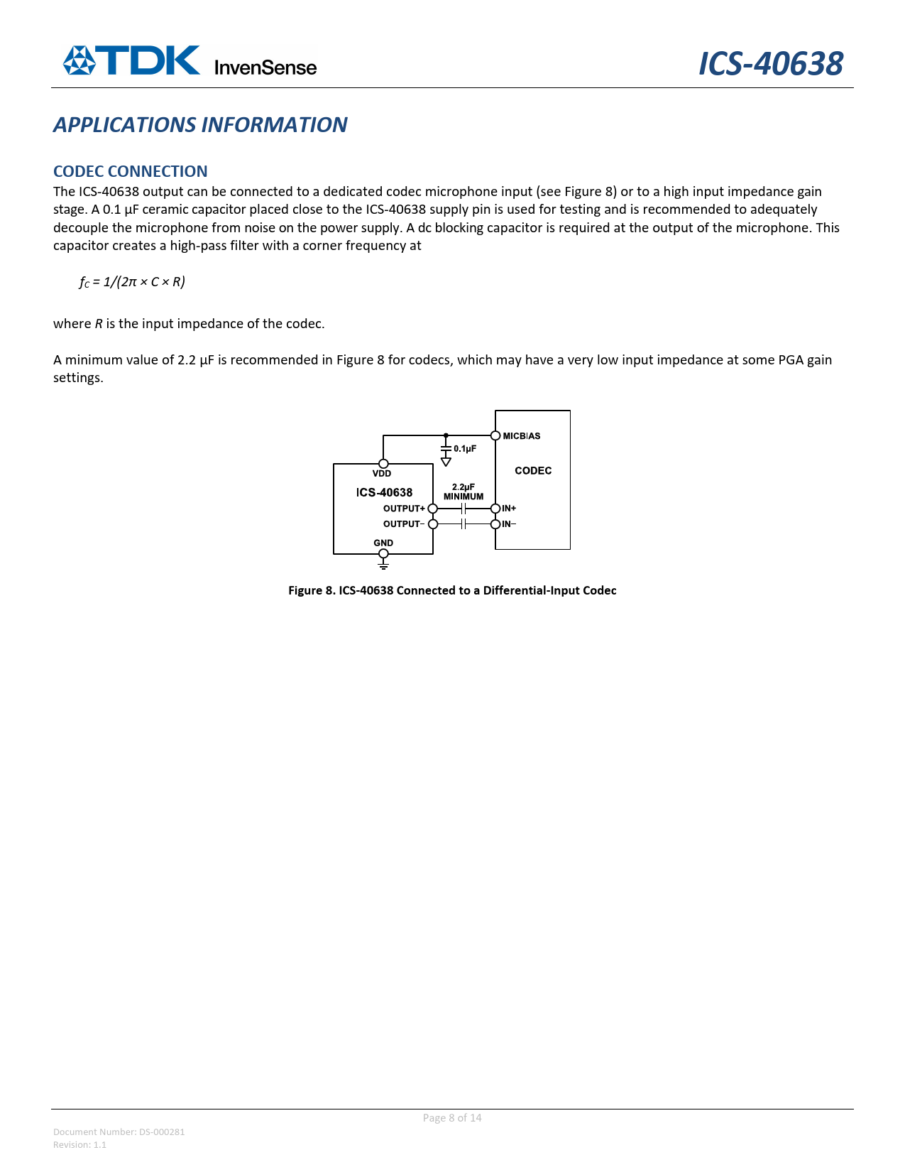

  ICS‐40638.   APPLICATIONS INFORMATION .   CODEC CONNECTION . Figure 8. ICS‐40638 Connected to a Differential‐Input Codec
  ICS‐40638   APPLICATIONS INFORMATION    CODEC CONNECTION  Figure 8. ICS‐40638 Connected to a Differential‐Input Codec
    ICS‐40638
The ICS‐40638 output can be connected to a dedicated codec microphone input (see Figure 8) or to a high input impedance gain  stage. A 0.1 µF ceramic capacitor placed close to the ICS‐40638 supply pin is used for testing and is recommended to adequately  decouple the microphone from noise on the power supply. A dc blocking capacitor is required at the output of the microphone. This  capacitor creates a high‐pass filter with a corner frequency at     fC = 1/(2π × C × R)    where R is the input impedance of the codec.     A minimum value of 2.2 μF is recommended in Figure 8 for codecs, which may have a very low input impedance at some PGA gain  settings.
